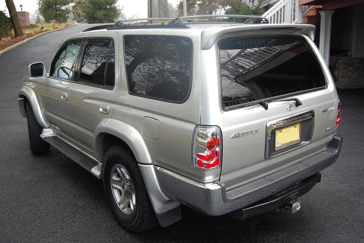

It's on and looks great!
im listening. i want some pictures and we'll go from there.
Here are a couple of crappy cell pics and I'll get some better ones posted up soon!
LINKY
so far so good can you get us some more pictures? above and close up would be nice.
Sure will. I had a bunch from all different angles but have to recover them as my phone went craps. Jason should have some taken from a good camera after the install so I'll get those posted up soon.
Sorry to bust your balls, but that mount is hideous. That cannot be right.

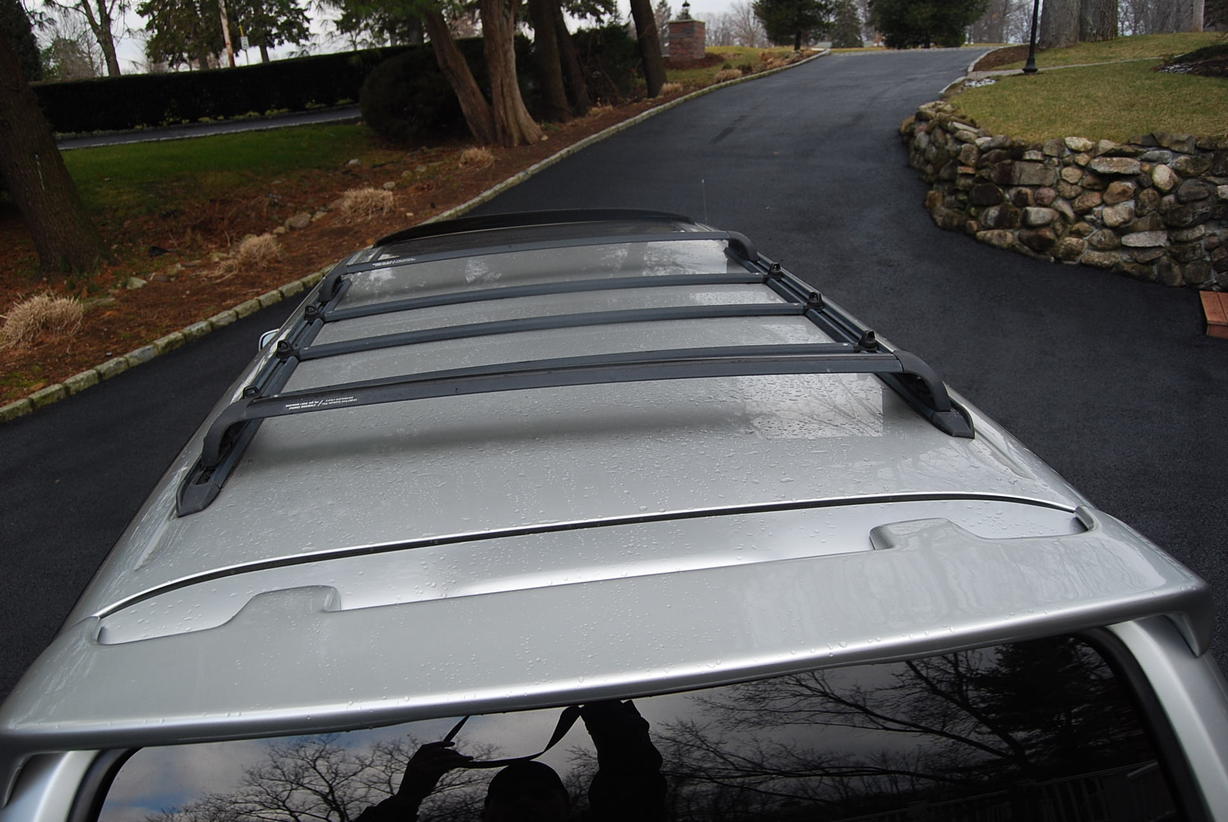

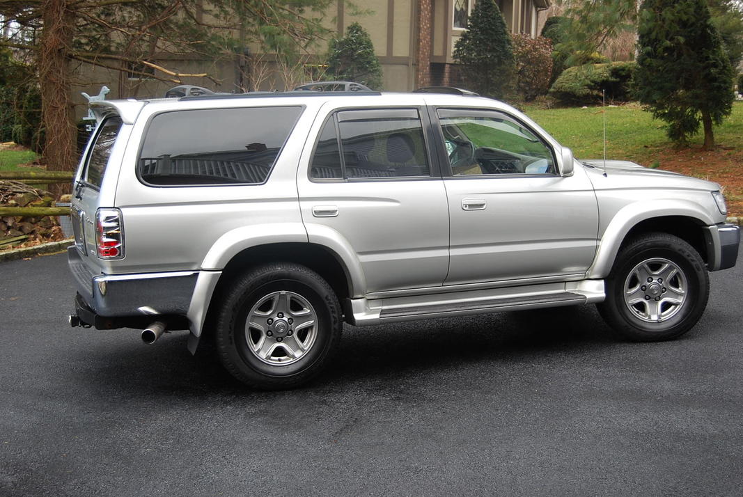

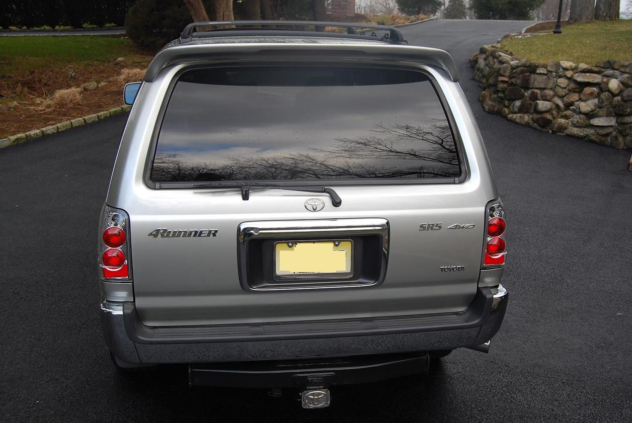

It's done and ready!!! Hope it's ok to post this here. Want this to be seen!
Burtman Industries
Order NOW if you want the sweet price that's on the website! It wasn't as easy as I thought. Like I said, we were basically doing a mirror of the old unit, but everyone kept saying they wanted the old holes covered. So, this meant the mold had to be changed, which cost me a $$$ but NO MORE HOLES! We widened the legs to cover them. Also, no more visible wire, no more snap on pieces, no more cheesy straps. Yes, it's bolt on, and awesome! Can't be stolen, and can be taken through the car wash:) I have special pricing on the site, but it's not going to stay this low for long. Please order so I can't make more :)
More pictures on the site :)
