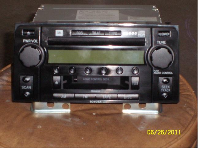

You will need to compare the connections in the back.
It looks a bit different form the one I pulled out of my 2003
JBL and non-JBL units are total different beasts.
JBL units send digital signals in two wire output to an external amplifier.
Non JBL sends raw sound through the speaker wires straight to the speakers.
Quite a bit different in the wiring aspect.
