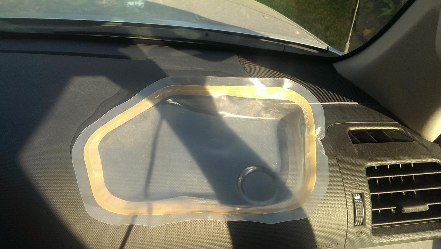

I made a hole on the plastic liner and the rattling is gone. I actually did not use a knife. There is a small piece of the liner can be peeled off. I do have a little concern for the moisture coming into the inner side of the door but it seems okay since the liner was not 100% sealed.
I did use sound deadening material around the speaker and on outer panel but the rattling was still there.
