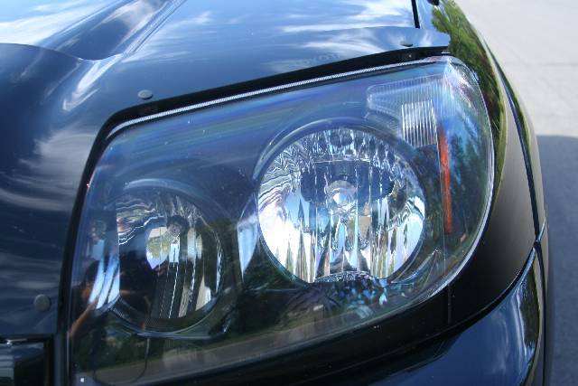

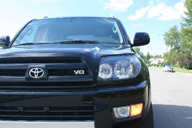

End Product =
Nice
cool mod. If I am not mistaken, wont the paint fumes fog the plastic?
Can you post some daytime pics when you get the chance? Thanks.

I thought it was common that paint will fog the inside of the plastic because of the fumes reacting with the plastic. I could totally be wrong.
There is air circulation between the inside headlight air and the outside... This is just from what I see right now.. who knows? 5 years down the road I MIGHT see it. Again, there is a circulation of air between the inside and outside of the headlight.
wow looks very sexy. im wondering if i should do this mod. or wait until those knock off jdm headlights come out. either way your truck looks very clean and very sexy.:D
