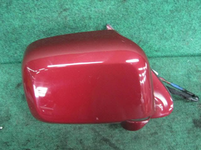

Just an update. I swapped the driver's side mirror mount over to a 96-98 USDM mirror mount and the JDM outer/upper half swaps right over with no changes and now has the proper field of vision!
So, anyone that tries this needs to use 96-98 mirror mounts if you want to leave your visibility unaffected.

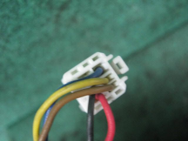

Hey coinball! Had a quick question about this mod. I am in the process of obtaining some PFMs for my own project and wanted to ask for your assistance.
Being you have done this already, is the picture below the correct wiring for PFMs? I know there are the 3 pin mirrors and 5 pin mirrors. Thanks!

I too have a set of these JDM mirrors. The mirrors each have the line harness and I have the retract switch with its harness.
My truck is a 99
Would you mind giving me some instructions on how to wire these up? What will the 5 pin mirror harnesses be plugged into?
