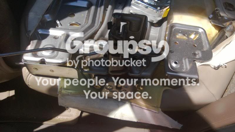

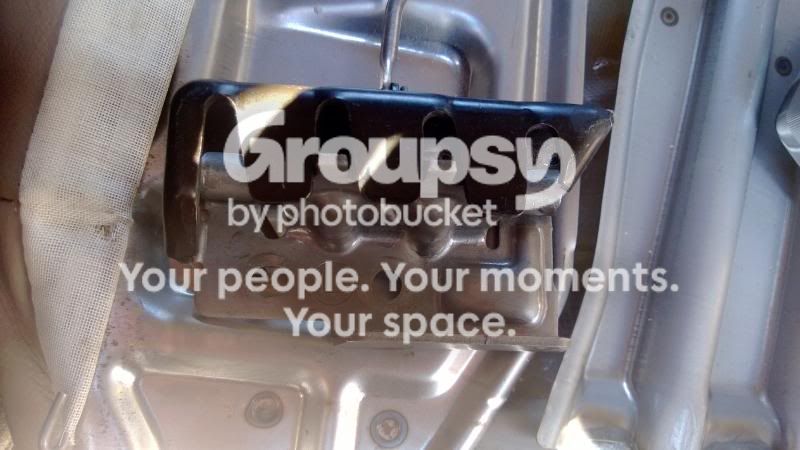

Apparently, everywhere except the USDM market, the 4Runner had reclining rear seats. I picked up these latches from IanB a long time ago and quickly realized that the latches weren't a direct swap. So I put them back in the box and hadn't done anything with them until today. I got them back out and started doing some initial measurements to figure out what I'll need to get them swapped.
Here are some pics:
standard latch vs. JDM latch:
Close up pic of JDM latch:
I need to find a set of trashed rear seats so I can modify the frames without destroying my original ones...anyone in or near Raleigh have a set of beat rear seats they want to give away or sell for cheap?
