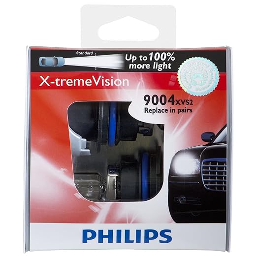

Last but not least, I added some higher wattage head lights. This actually helped a bit, I noticed a difference in brightness. Highly recommend these or something similar, as more LED headlights are coming onto the market.
