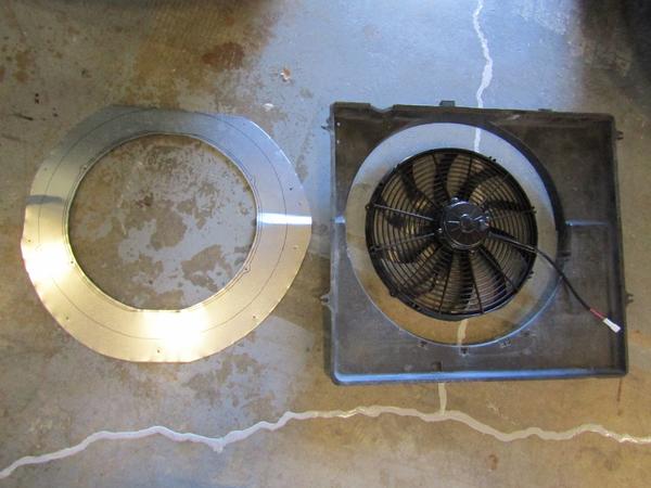

Over the holiday weekend I installed the SPAL 16" electric fan with the Flex-a-lite variable controller. It wasn't a perfect fit but I'm pleased with the results now.
EDIT: The fan shroud is bending in the heat of the engine bay, I instead installed it with a rubber gasket and metal ties. What I tried the first time is below:

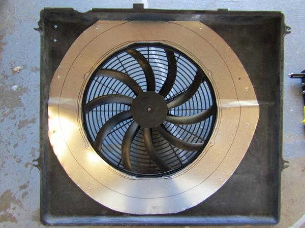

The 16" fan is only about .75" smaller than the stock mechanical fan, so it fits fairly well in the shroud.
I used a simple riveter and predrilled 1/8" holes where the shroud needed support and inserted the rivets. I wish I had bought a riveter sooner, it's super easy and quick to secure metal.
This setup did not end up working. Instead, I bought 4 metal straps from SPAL and a rubber gasket to keep it from rubbing on the radiator:
The brackets are about 2" too short for the radiator shroud mounts. I ended up getting a few strips of steel straps from Home Depot and cutting them to size with an angle grinder and then attaching them to the feet.

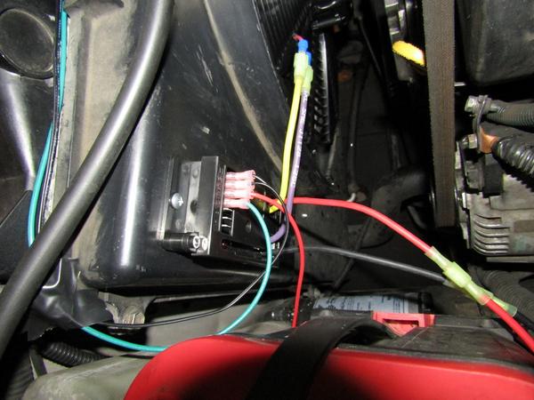

The wiring took time, much longer than I thought. The A/C wire was confusing since it was only a single wire and I couldn't tell if it was positive or negative charged. I took a guess since it's a single wire it's positive, and I guessed right. The wiring included in the Flex-a-lite kit was overkill with 10 AWG so it was difficult to crimp. I mounted the controller on the shroud itself near the battery, so at least the wires were short. I tapped a 12v ignition source I already had wired to the engine bay otherwise you'll need to draw it from inside the vehicle.

- If you are worried about the reliability of the fan controller, you should put connectors on the power and output side of the fan controller so you can bypass it if it stops working. Basically, have the option to run the fan full-on with ignition power.
- Where do you have the temp sensor for the fan controller? It should be at/near the bottom of the radiator. I would suggest having it start up the fan at ~160*F and be full-on by ~190*F, especially if you are still using the stock trans cooler in the bottom of the radiator. You want the water temp at the bottom of the radiator cooler than the engine temp so the thermostat has something to draw from the cool the motor. Also, you want something to help keep the trans fluid in that ~160-180*F range.

I did put connectors on everything, thankfully, I thought of that too. If I had used butt connectors like supplied, I would never be able to get the fan or shroud out again without cutting the wires. I'm not worried about it though, most people get a lot of years out of it these controllers but if the controller bites the dust years down the road, I just simply unplug it from the controller and instead straight to the power source. That'd work long enough for me to get a replacement.
The temperature probe is at the inlet at the top per the instructions, since that's where the hottest coolant is. Unfortunately the fan controller only allows for a ten degree range before it's on 100%. A stock thermostat is a 185* thermostat, these 4Runners are designed to run in the 180*-190* range from the factory. If I set it at 160* it'd be full speed at 170*, so basically on non-stop. That's why I went with 185*. But my 4Runner is wandering more and more from stock, so it's a little hard to apply what I've done to other 4Runners.

Well, the weight of the fan on the shroud is not working. When the engine bay gets hot, the plastic shroud sags under the weight of the fan (it weighs over 5 lbs) and keeps hitting the mechanic fan hub and is digging into the back of the fan motor. If I keep it like this, the fan motor will break and short on the motor.
I'm going to have to just buy a fan gasket from SPAL and the radiator zip ties and go that route. I wanted to avoid this since it's semi-permanently attached to the radiator, if I ever have to remove it I would need to buy extra zip ties in advance.
