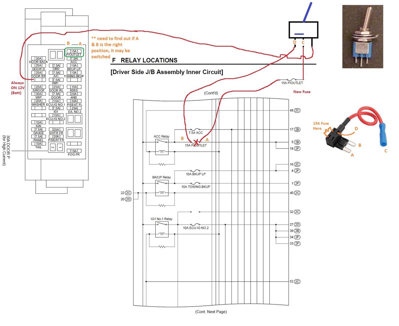

All Power Outlet constant ON(switched) - *Research Phase*
I think I will go add a switch besides the power-inverter switch, you will get 2 choices:
1) back to original configuration, only when IGN, power outlets (rear 12V) will be ON
2) power outlets always ON even when the car IGN is off
I may go fancy and find a nicer switch later.
