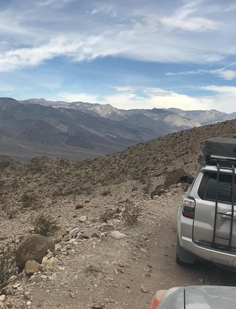

I got to meet and wheel with [MENTION=119516]jicko[/MENTION] over the last 5 days! What a machine, the trucks great too...
