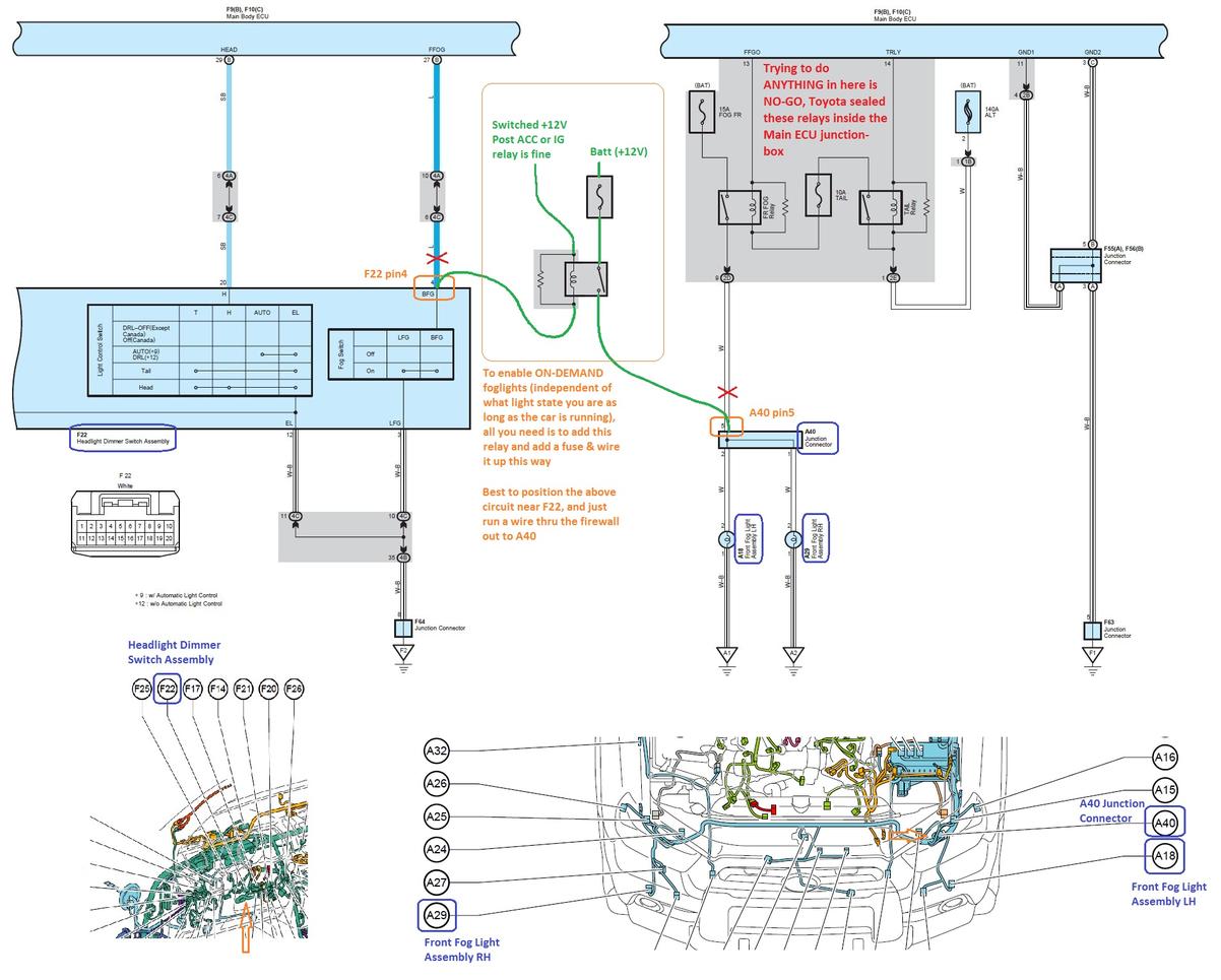

On-demand foglight - *Research Phase*
Another session of "paper modding"..... trying to figure out how to utilize the factory/original foglight control to product an on-demand foglight effect. ie. whenever the car is ON, the foglight will be ON whenever the foglight control is turn to the ON position no matter what light state you are. By default, the foglight will ONLY come ON when you are in low-beam mode; DRL and high-beam will have the foglight turned OFF.
The only cons here is that the FOG light indicator is no longer true to whether the foglight is on or off.
I think by adding 1 relay & a fuse, and wiring up like how I illustrated in the diagram here should do the trick.
Let me know how this turns out for you. I've been wanting to do the same thing. There are threads out there for this already, but none that adequately mod the 14+.

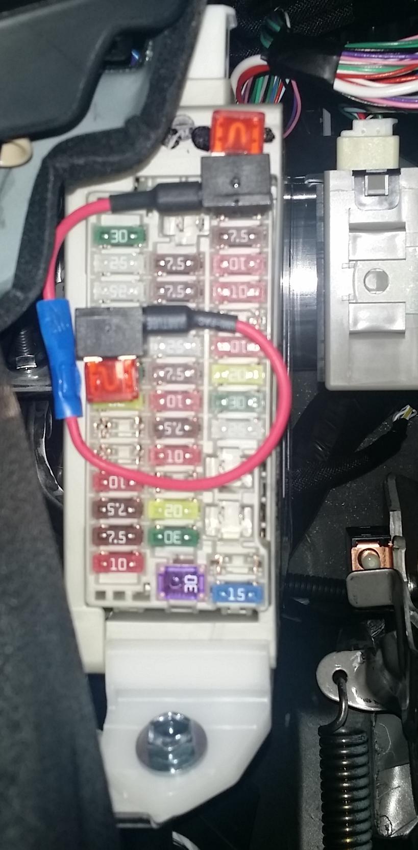

Simple, reversible, quick, & cheap - ALWAYS ON 12V Outlet Mod
The diagrams and explanation is here:
http://www.toyota-4runner.org/5th-gen-t4rs/187467-jicko-build-thread-2.html#post1950091
This execution skips the "switch" part.
"Add-a-ciruit" available @ your local auto stores - Kragen/O'reily, AutoZone, Pep-boys for $6.
*Credits to a few other guys in this forum who had done it before*
This will NOT run your fridge tho.
The factory wire gauge of wires off the 2 rear seats 12V outlet as well as the cargo 12V outlet from the battery are probably not sufficient enough to handle the instantaneous current draw of the starting of the compressor, hence, at the 12V outlet, the voltage dips lower than the "battery monitoring" voltage. The ARB fridge will NOT run.
For the ARB Fridge, you need to run your own wiring. (This seems to be the conclusion I am getting at).
Still plenty of reason to do this.
