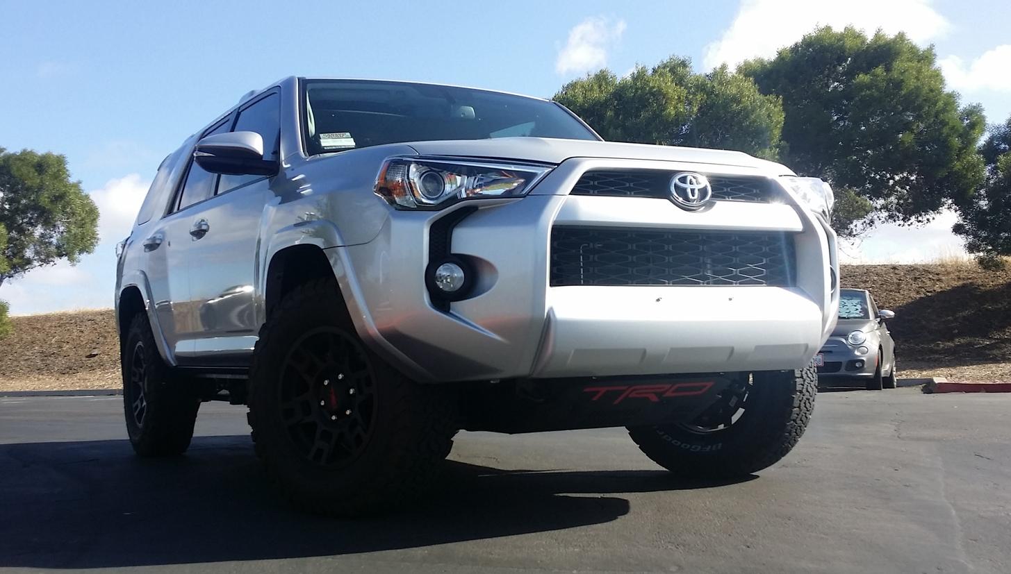

Starting as your standard silver TRD skid plate:
Blackend with 5 layers of BLACK Plasti-Dip, leave it to dry/cure for 24hours, then apply masking tapes:
And newspaper:
Then spray with RED Plasti-Dip:
Wa-la!
Matched quite closely with my TRD wheel's hub:
Can't wait to install it onto the beast!!
TRD skid added!
Installed it before work this morning
