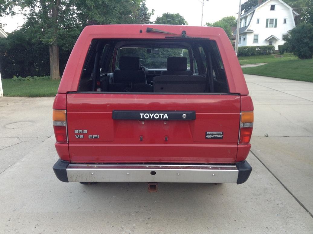

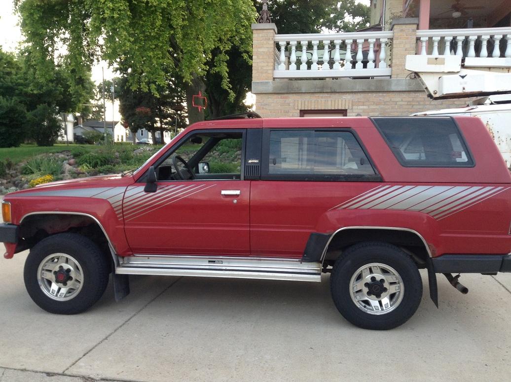

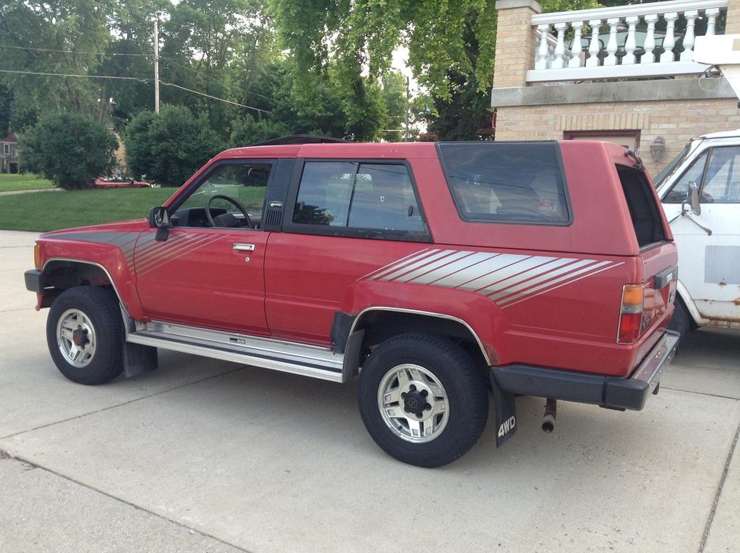

Here it is. Ill take better pictures in the future.

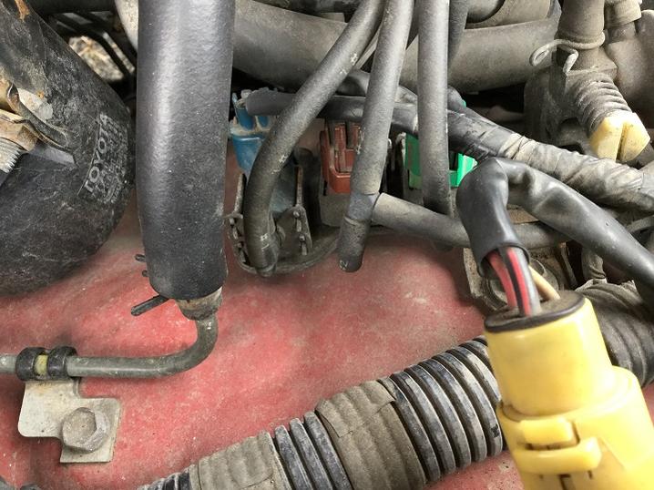

When I turn the key there is a click. However it's not coming from the relay. Its coming from one of these three plugs. And it doesnt click when you turn the key to start it, but rather when you turn it to the first spot. So I imagine that is normal.

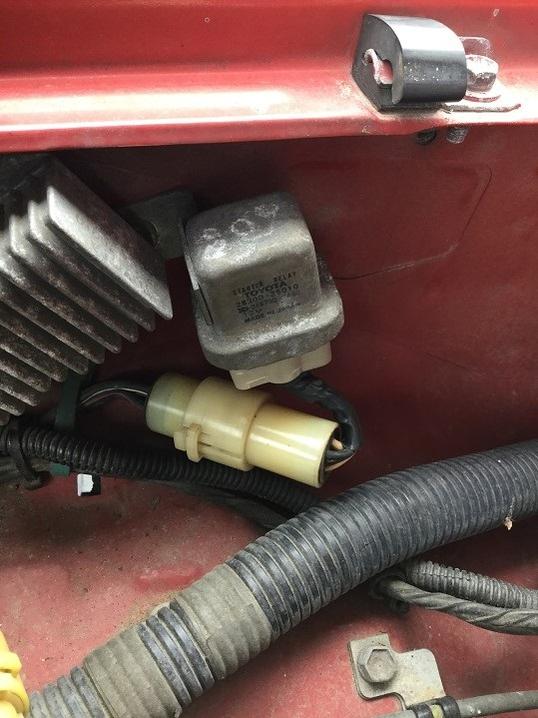

And here is the relay. I had my dad turn the key several times as I listened to the relay and felt for a click. There is no click coming from the relay. Shouldn't there be a click when I turn the key to start it?
Bump for this question. I would really appreciate some help on this. Not hearing or feeling any click from the relay. Does that indicate the relay is bad?
Yes. A relay will click if its working. Doesnt necessarily mean the relay is bad though..
A relay is basically just a switch, that is turned on by another switch.... So you flip on a lightswitch in your cab, triggers the relay, then the relay turns on the lights.
So, it could be the relay, or the source of the power that triggers it. This would be a good time to pull out your multimeter and make sure power is getting to the relay.
(Cant really answer your specific question without checking on my own.. But that wont be until tomorrow afternoon unless someone else can chime in.)
