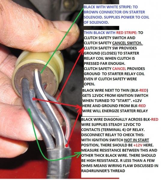

Yes. A relay will click if its working. Doesnt necessarily mean the relay is bad though..
A relay is basically just a switch, that is turned on by another switch.... So you flip on a lightswitch in your cab, triggers the relay, then the relay turns on the lights.
So, it could be the relay, or the source of the power that triggers it. This would be a good time to pull out your multimeter and make sure power is getting to the relay.

But basically you need to find the trigger wire. Put red on that, black on a ground.. Then do whatever it is you're doing that "should" trigger the relay (ignition?) .. It should then read some sort of voltage.. My guess would be ~12v.

Im gonna try this today. I had the starter tested and autozone told me its good. So based on the last paragraph from this picture . . .
To test if Im getting power to the relay, I put the red on the first wire he mentions, and then I put the black on the second (thick black wire) he mentions. Does that sound like what is being described here?
