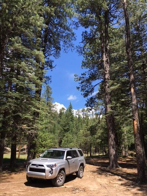

Jean - Nice rig and build/adventure thread. I know what you mean about slowly getting your rig built up. So far for me only husky liners/mats, xenon hid extreme with Philips bulbs for the low beams, then onto a front runner 3/4 rack later this year. I have the same 2016 tep w/kdss. Nice color by the way ;) I look forward to seeing what you do next.
