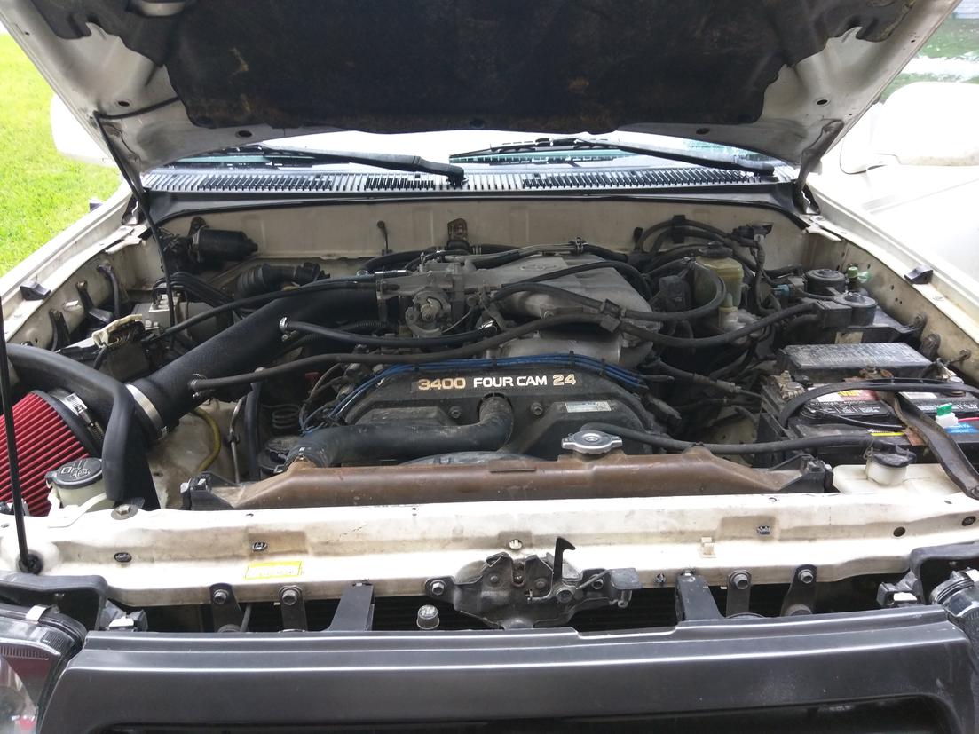

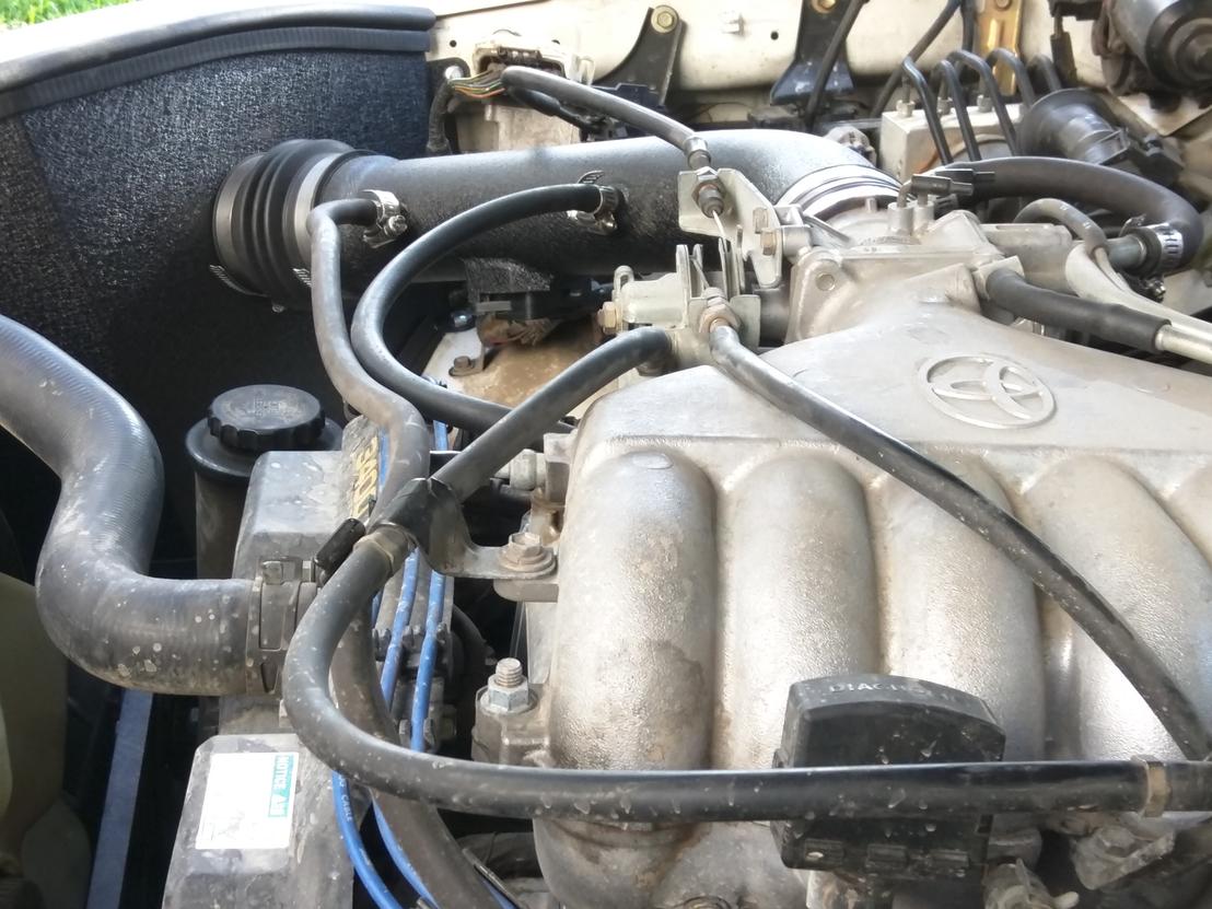

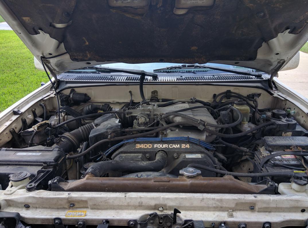

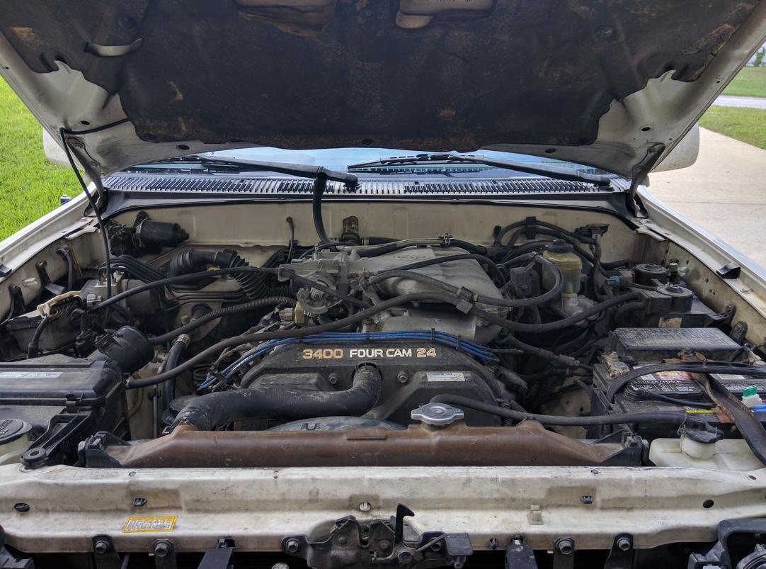

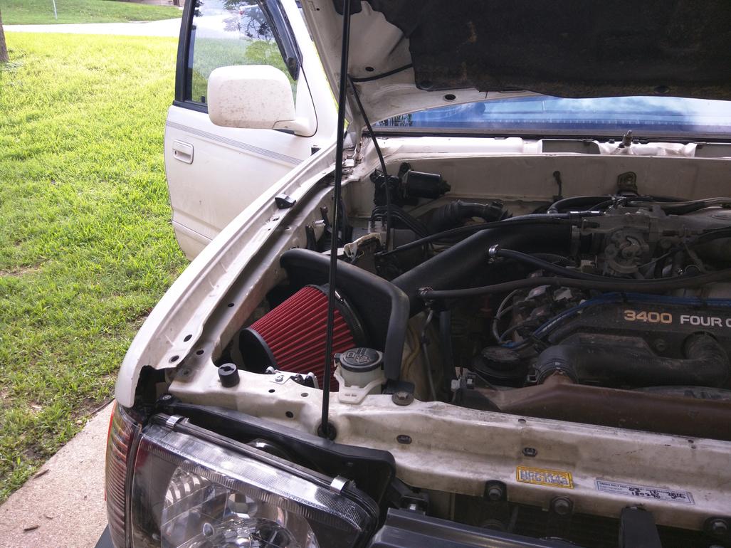

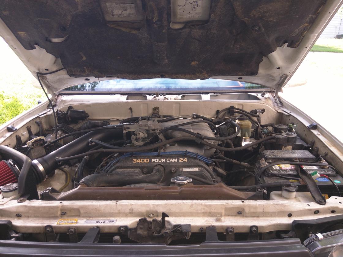

Cold Air Intake

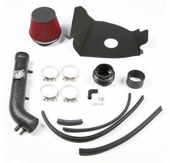

Started with a cold air intake today. I purchased a 99-04 Toyota Tacoma 3.4L V6 Heat Shield Air Intake - Texture Black:
99-04-toyota-tacoma-3-4l-v6-heat-shield-air-intake-texture-black-16.jpg​
Product Description
Package Includes:
1 x Air filter
1 x Air intake pipe
4 x Clamps
1 x Heat shield
2 x Silicone coupler hoses
4 x Silicone hoses/ vacuum lines
All necessary hardware included
Air Intake System:
A Cold Air Intake System relocates the filter outside of the engine compartment to deliver the coolest air inlet temperatures possible. Cooler air carries more oxygen, which translates into a more intense explosion in the combustion chamber to create more horsepower and torque. But that's only part of the power equation. Tuning the inlet pipe in length and diameter to match the engine's resonance helps move more air to the cylinders (think of your engine as a big air pump), and this tuning allows us to deliver the maximum power gains throughout the entire RPM range.
Notes:
100% Brand New
Professional Installation is Highly Recommended
Installation Instruction is NOT Included
Features and Benefits:
Made of high quality T-6061 aluminum material for strength and durability
Lightweight high air flow racing performance spec. design
Helps engine to draw in more and colder air resulting in better throttle response and higher explosive horsepower output
Improves up to 95% filtration efficiency
Increases 5 to 10 horsepower, 6 to 8 precent of torque, and improve the gas mileage
Instructions not included with most of our products.
We highly recommends professional installation on our performance parts.
Fitment:
1999 2000 2001 2002 2003 2004 Toyota Tacoma
1999 2000 2001 2002 Toytoa 4Runner
Fits Models with 3.4L V6 Engine ONLY​
I purchased from Amazon, however you can purchase from ProComp Labs as well.
Amazon.com: Toyota Tacoma Black Coated Aluminum Air Intake System - 1 Gen V6: Automotive

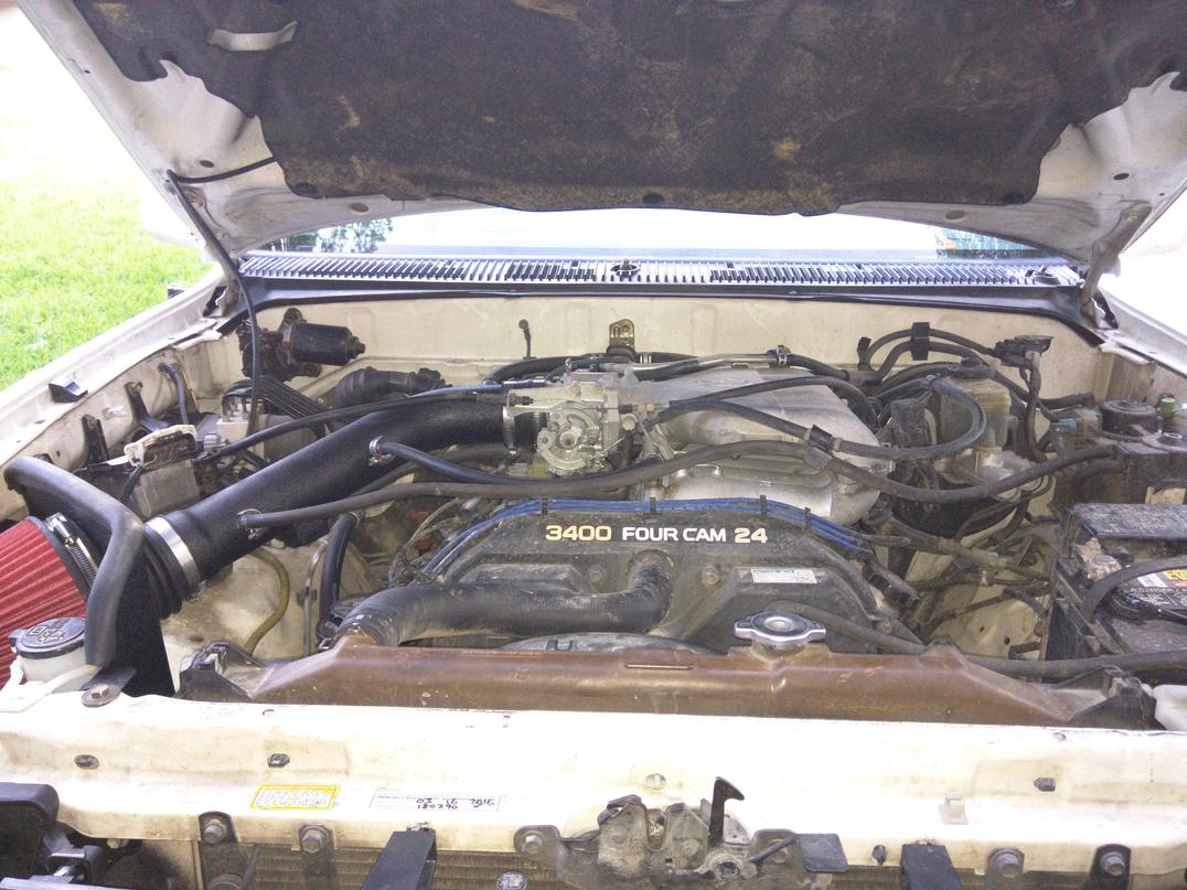

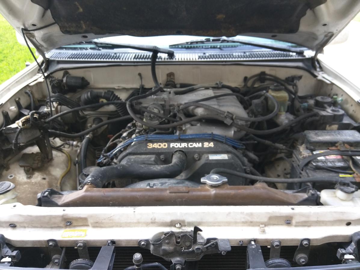

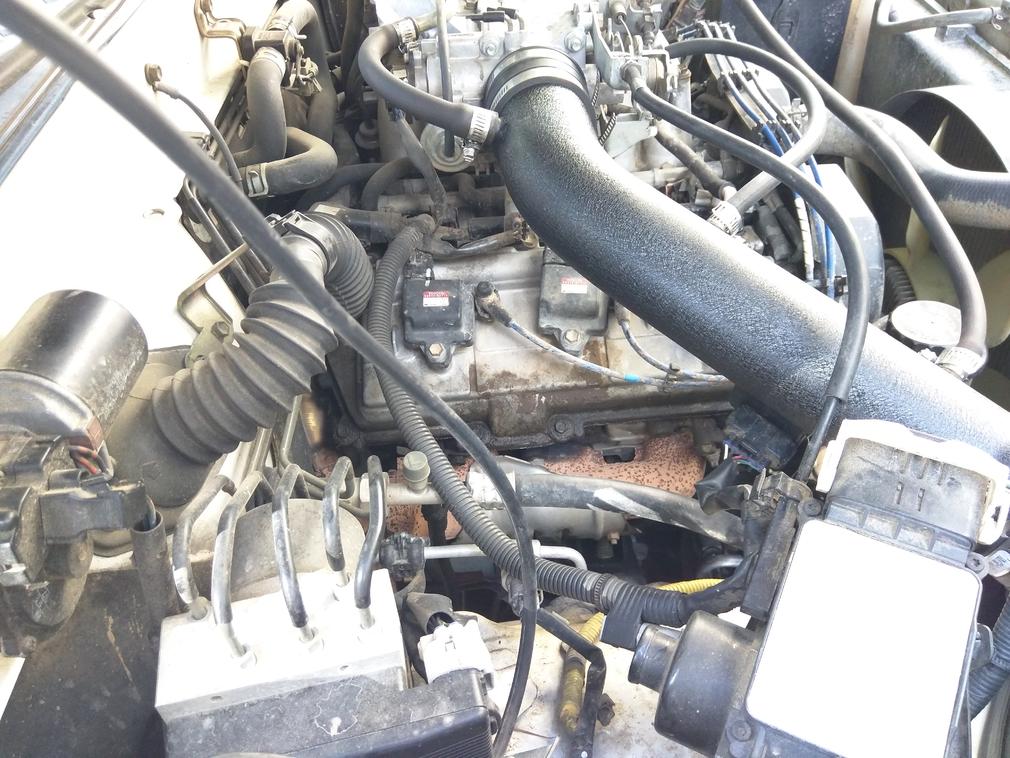

Here's the build from start to finish:
Start of Modification

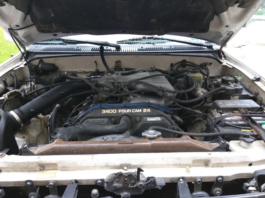

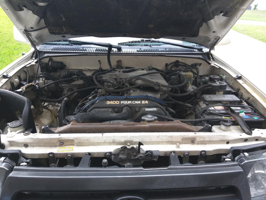

Removal of Upper OEM Air Intake
Removal of Air Filter Box
Installation of Heat Shield
Instillation of Air Intake Pipe
Instillation Filter and Hose Hook Up. Instillation Completed​

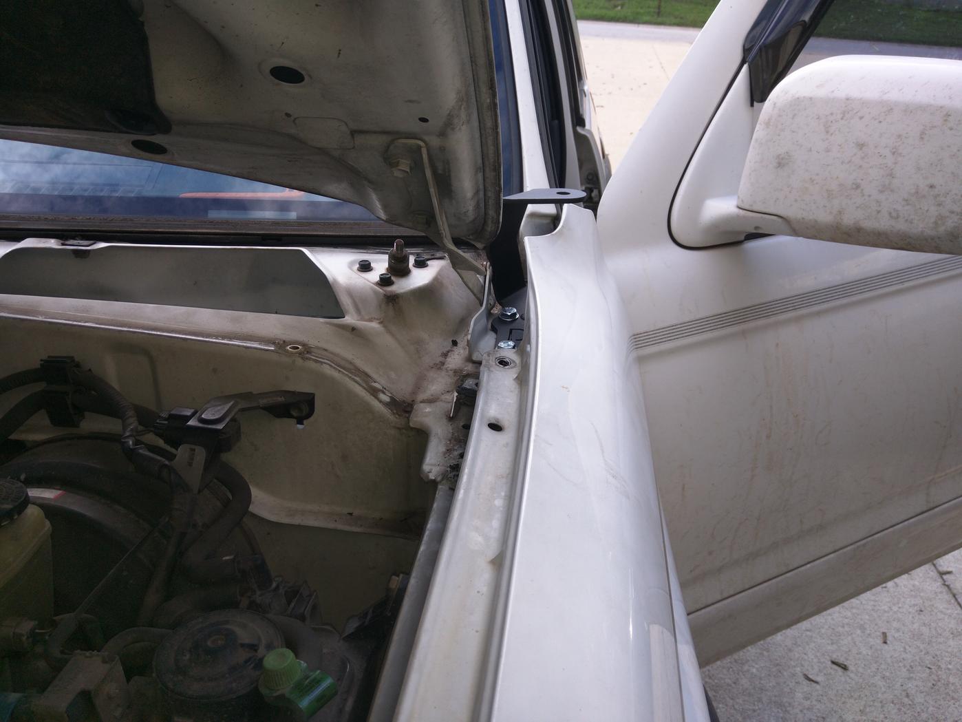

CBI Ditch Light Mounts
My ditch light mounts from CBI OffRoad came in today.
Contents of the Box:
  • Driver's Side Bracket
  • Passenger's Side Bracket
  • 4x 13mm Hex Bolts w/Washers
  • CBI Business Card w/QR Code for Instructions
  • Large CBI T-shirt
  • 2x CBI Decals
  • Invoice
Total Cost $59.99
Tax and Shipping was included.​
CBI OffRoad 3rd Gen 4Runner Ditch Lights Mount

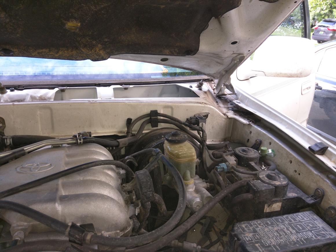

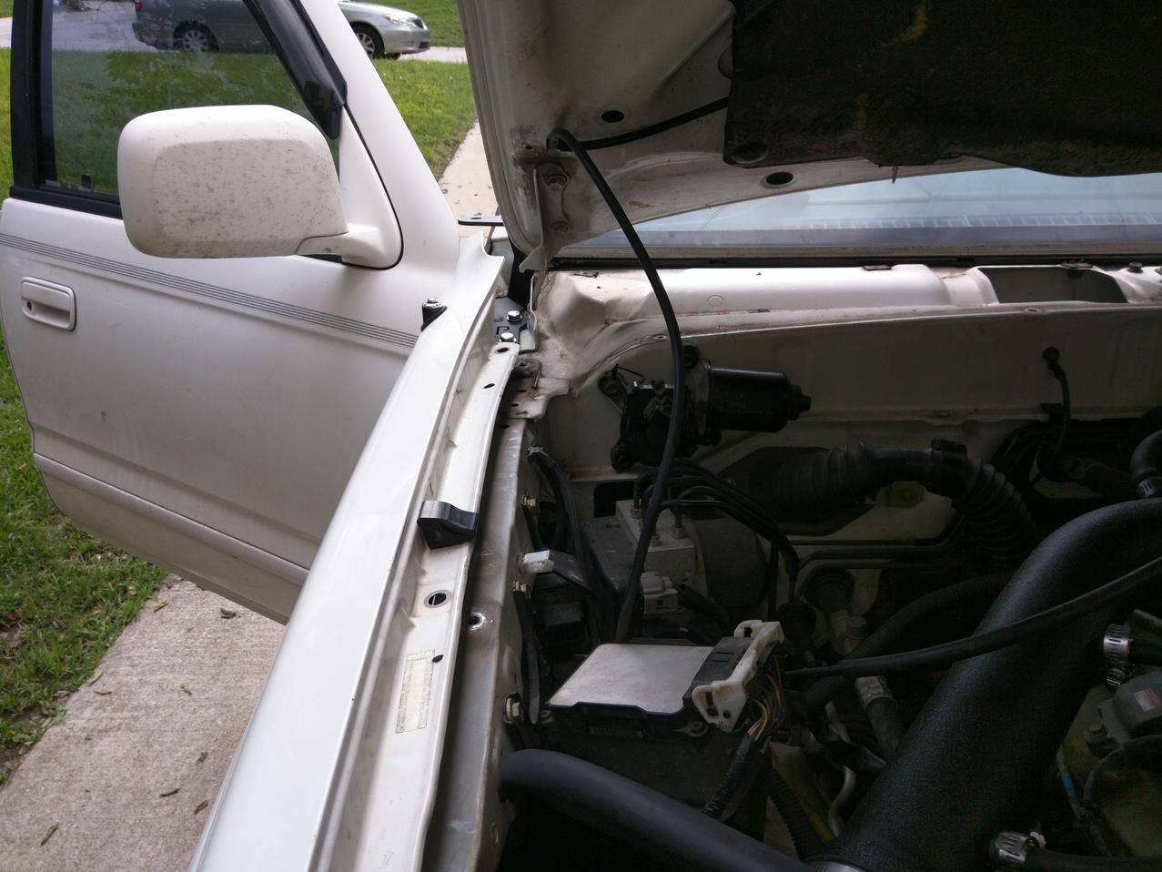

INSTALL:

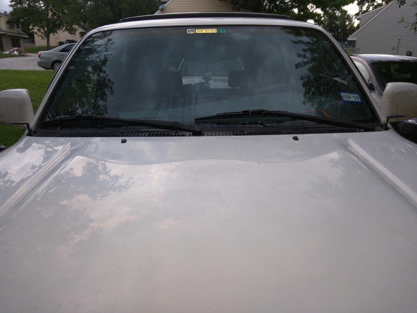

I started by removing the driver's side windshield wiper assembly, then removed the passenger's side windshield wiper assembly.
Next I removed the cowling between the hood and the windshield.
Then I removed the driver's side front body panel bolts, four in total, and lifted the panel for clearance and access to the hood hinge.
I removed the two 12mm bolts holding the hing to the body and installed the driver's side bracket using the provided 13mm bolts and washers.
Then I removed the passenger's side front body panel bolts, again four in total, and lifted the panel for clearance and access to the hood hinge.
I removed another set of 12mm bolts holding the hing to the body and installed the passenger's side bracket using the provided 13mm bolts and washers.
I reinstalled the driver's and passenger's side panels. Then after trimming the edges of the cowling to make clearance for the brackets, I reinstalled the cowling.
Finally I reinstalled the windshield wiper assemblies, thus finishing my install of the CBI Ditch Light Mounts.

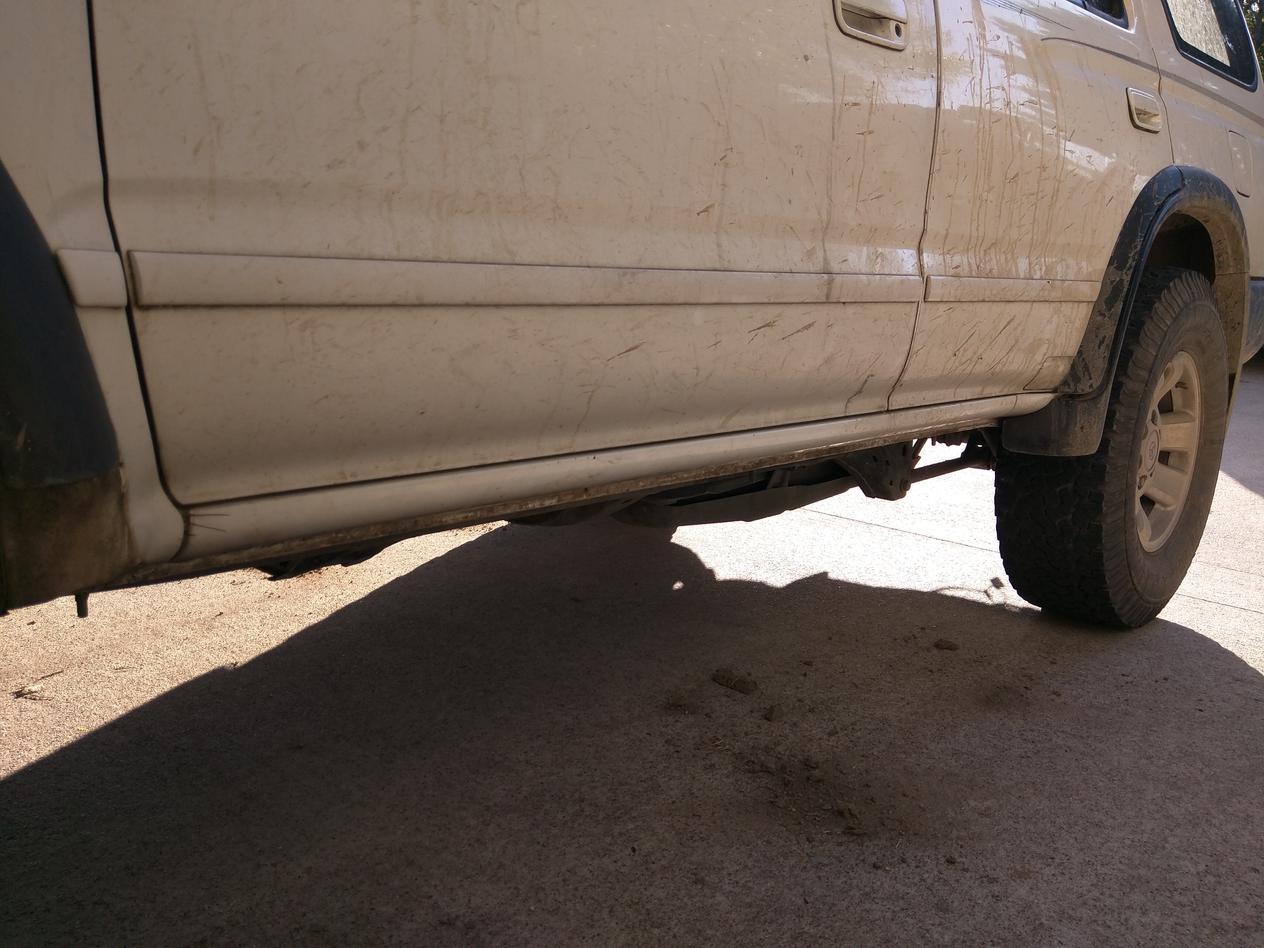

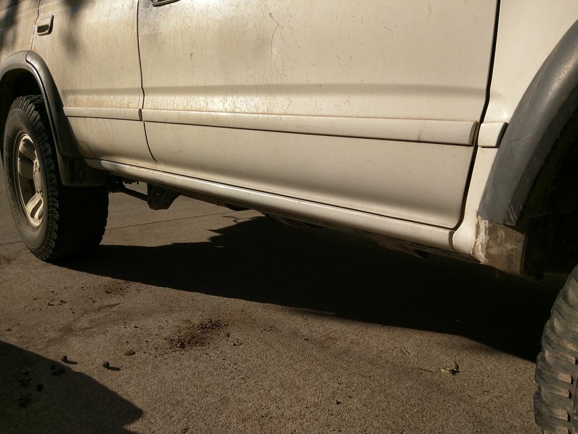

Running Board Removal

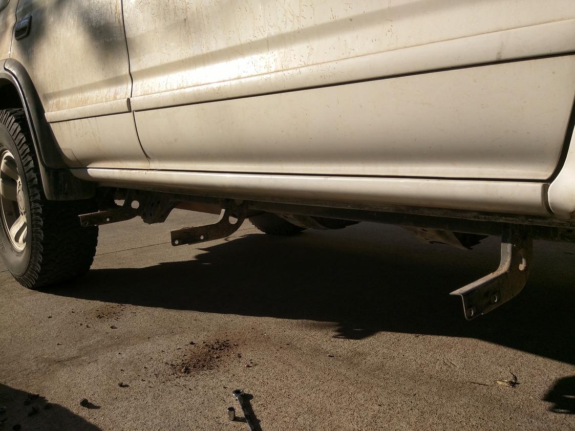

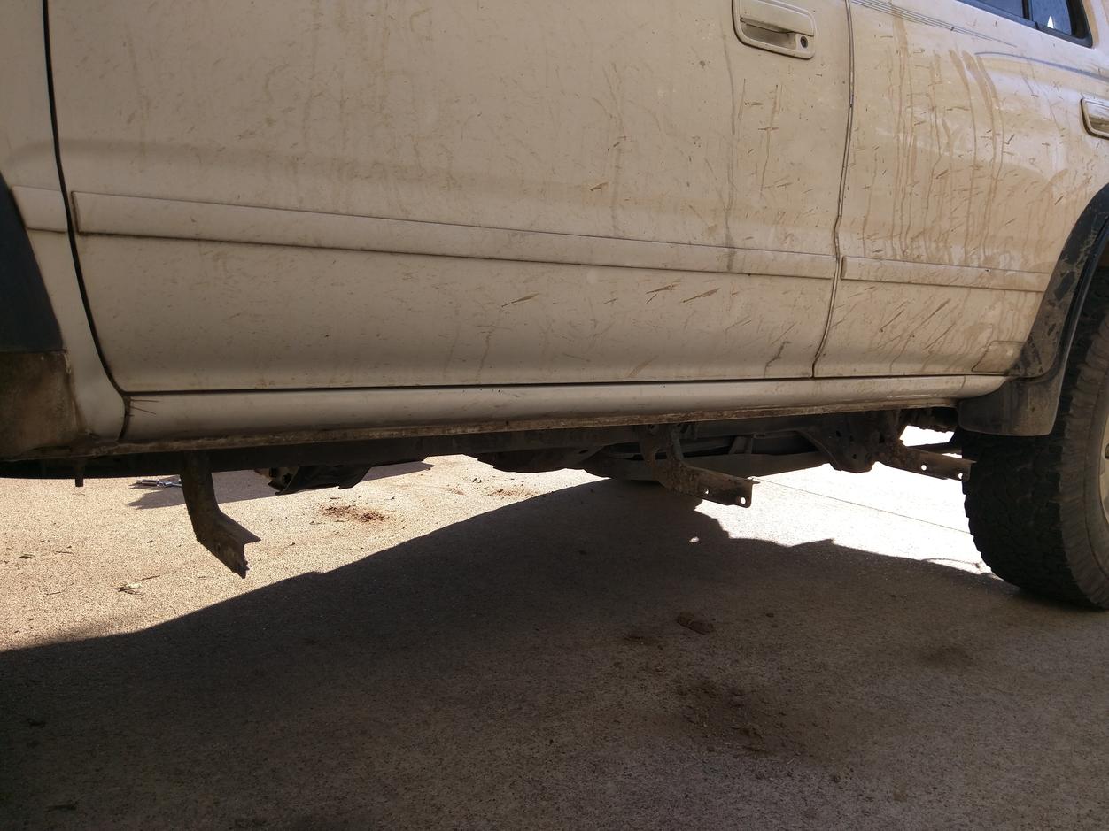

I finally decided to remove my running boards today. Total time from start to finish about an hour including breaks and children coming to "help", lol.
Removal:
First I was going to try to remove the brackets and running boards as a complete unit, however ran into a space issue. I ended up removing the running boards first, starting with the passager side. There were six 13mm bolts and nuts which held it on.
I then removed the five 13mm bolts and nuts that held the brackets to the frame.
Next I moved on to the driver side and removed the running board, another six 13mm bolts and nuts removed then off it came.
Finally removed the driver side five 13mm bolts and nuts and the brackets were off.
Next step is to either find OEM Front Mudguards PT413-35966-DF and PT413-35966-PF, drivers side impossible to find it seems. I could go with a pair of D Farm's End Caps. I was even possibly thinking of modifying a pair of Rear Mudguards and seeing how that works. I'll keep y'all posted.
