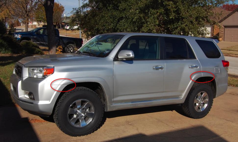

how do you plan to "blend" the matte-black (more pronounced?) fender flare where the front bumper trim piece (Trail Edition) meets the stock fender trim (Limited)?

Not sure what your talking about but the flares are the same except they are painted the body color on the limited/sr5 and left natural black on the trail ed.'s. The front part of the flare is molded into the bumper cover on both styles and in the back the back part of the flare. They come in all black and have to be painted before putting them on.You would have to see them in person to really understand.
I had my Limited parked right next to a T.E. to check them out.There are a bunch of T.E.'s on lots around here. The bumper covers were painted off the car and then installed later in the assembly line at the factory ,same as all new cars as far as I know.All the metal parts of the car body are dipped for corrosion protection and then painted before they go to the assembly line. As a matter of fact my paint match between bumper cover and fender are off a shade when you look in good light.Flexible plastic/rubber parts such as bumper covers are not painted with the same type of paint as steel fenders and such.
See the lines for the bumper covers? There are little clips that attach it to the fender right under where you have circled and it's farther back from where you have the back circled.
