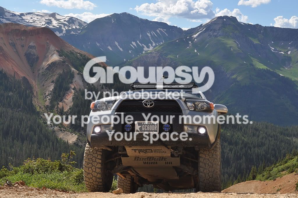

MODS.....they are linkable ,just have to be patient and wait for them to completely load when you click on them.
ARB air lockers and Nitro 4:56 Gears - East Coast Gear Supply
Icon CO's with Remote Res and Piggyback Rear Shocks/SAW Springs
Trail Edition Ext.Parts swap
ViAir on-board air compressor/2 gallon tank
ShrockWorks Sliders
Baja Designs 40" LED light bar
Dual Battery Mod
Fog Light Switch Mod
BudBuilt Skids
Doug Thorley Headers
PIAA Fog Light Install
Pioneer Avic Z120BT Nav
S2000 HID Retrofit
TRD CAI
Matte Black Vinyl Hood Wrap
3M DiNoc Interior Wrap
Warn M8000 Winch and BudBuilt Internal Winch Plate
Stinger Voltage Gauges Install
Magnaflow muffler and Side Exit Exhaust Pipe
Konig Countersteer X'S
AR Teflon Mojave Wheels with 305/65/17 BFG MT KO's
Kenwood TM-V71A HAM Radio and K9000 motorized antenna mounts
Metaltech Lower Control Arms ,Toytec Superflex springs and BajaDesigns OnX 44 LED bar
VisionX Tantrum Rock Lights
Fog Lights retrofitted with Blazer Projectors and 5k Morimoto HID bulbs

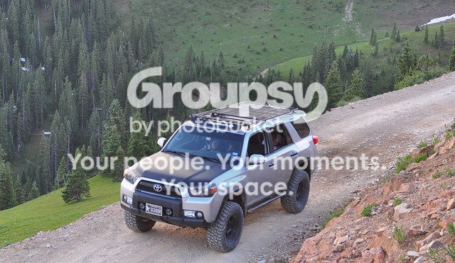

Down below pics are my first of many many mods on my new 2010 Limited when I first brought her home.
They were chrome and had to go The only thing that was actual real chromed steel and not chrome painted plastic.
I also ordered a front 2 inch spacer lift kit to level it out and a Spidertrax spacer kit to bring the wheels out more. I have a set of 17inch FJ wheels to go on already but waiting to see how big of tire I can put on it. I'm shooting for 285/70/17 BFG AT KO's.

Harper7 just got the new tires on. I am running 275/60R20. With a Toytec 3" spacer up front and new Toytec 2" rear coils. The fronts do rub under full lock and compression. I need to trim inner fender wells a little and should be fine. Let me know how you work out.

As far as tires, I ordered 275/70/17 BFG AT KO's . They came in today and have a appointment for tomorrow at 1pm. to put them on.I thought 285/70 17's would rub in the front.I have 1.25 inch spidertrax wheel spacers in the front to go on also.
Did you have a 4th Gen? The inner fender wells on these 5th's are alot thinner then 4th's. Almost paper thin and then they ribbed them to get extra strength.Those ribs in the front are where they looked like they will probably rub so I went with 275's instaed of 285's.

Well the new tires went on today. :naughty:
BFG AT KO's in size 275/70/17
I swapped wheels with a guy that bought a new SR5 last week for my stock 20's then I traded the Dueler HT tires in on the BFG's.
I have a set of 2008 FJ 17 inch wheels I was going to put on but I think I like these better.Anybody local looking to buy a set of five FJ wheels? $350 for the set like brand new.
They had about a 1/8 inch clearance from the front inner fenderwell plastic when the wheels were turned the whole way.(Shown in the last pic)
Plenty of room on the inside.That is with stock 4x4 suspension. I have a 2 inch Toytec front lift spacer and Spidertrax spacers to go on this weekend.
