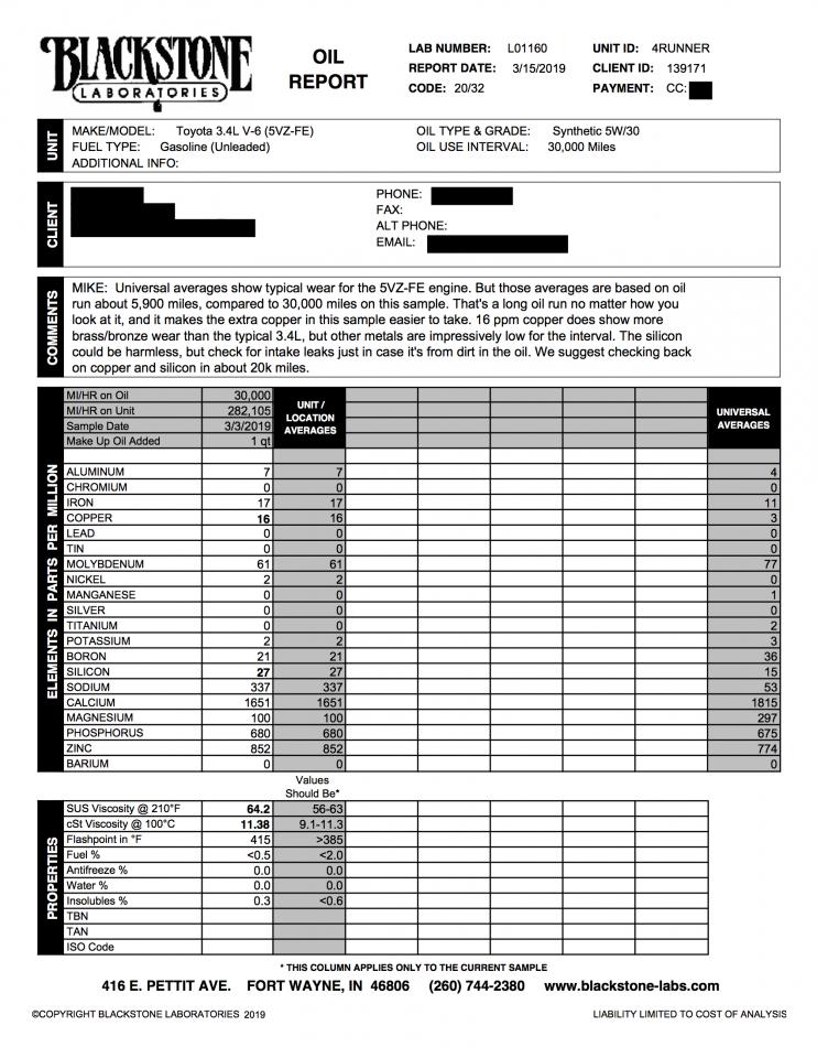

Got my report from Blackstone Labs today. They want to see another sample in 20K miles but I decided my next oil change will be in 17.8K miles when or when I roll 300K, whichever comes first lol

Impressive oil report. Would be interested to see the TBN to understand if the detergency is still holding up after 30k.

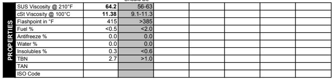

Reached back out to Blackstone, they had enough oil to run a TBN test and here is the result, TBN = 2.7
I had to look up TBN....
2.7 looks pretty low

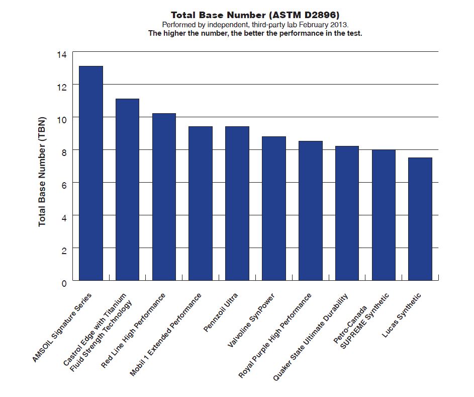

AMSOIL Advantage – High TBN
Because AMSOIL synthetic lubricants demonstrate consistently high TBNs, they neutralize acidic contaminants and keep them in suspension to prevent corrosion, maximizing engine protection. AMSOIL lubricants use detergent and dispersant additives to significantly reduce sludge and carbon deposit formation. In the Total Base Number Test (ASTM D2896), AMSOIL Signature Series 5W-30 Synthetic Motor Oil demonstrated the highest TBN of the oils featured in the test, helping it deliver reliable protection for extended drain intervals.

According to Blackstone Labs, a TBN over 1.0 in used oil indicates the oil still has "life" left in it from a performance standpoint. A TBN of 2.7 after 30K miles is obviously lower than the TBN of new oil, usually 6.0 to 14.0, but is still considered in the "performance range" from the standpoint of detergency, lubricity and anti-acidity. I do not know what the TBN of my oil was when it was new to compare how much of a drop in performance 2.7 represents from new oil.
In a nutshell, I'm pretty impressive given the age/mileage of the oil, IMO

PQIA has virgin oil analysis (VOA) reports on a lot of motor oils including Mobil 1 which I think you said you were using. Their report here shows a starting TBN of 9.7, which is quite high for a standard gasoline engine oil.
