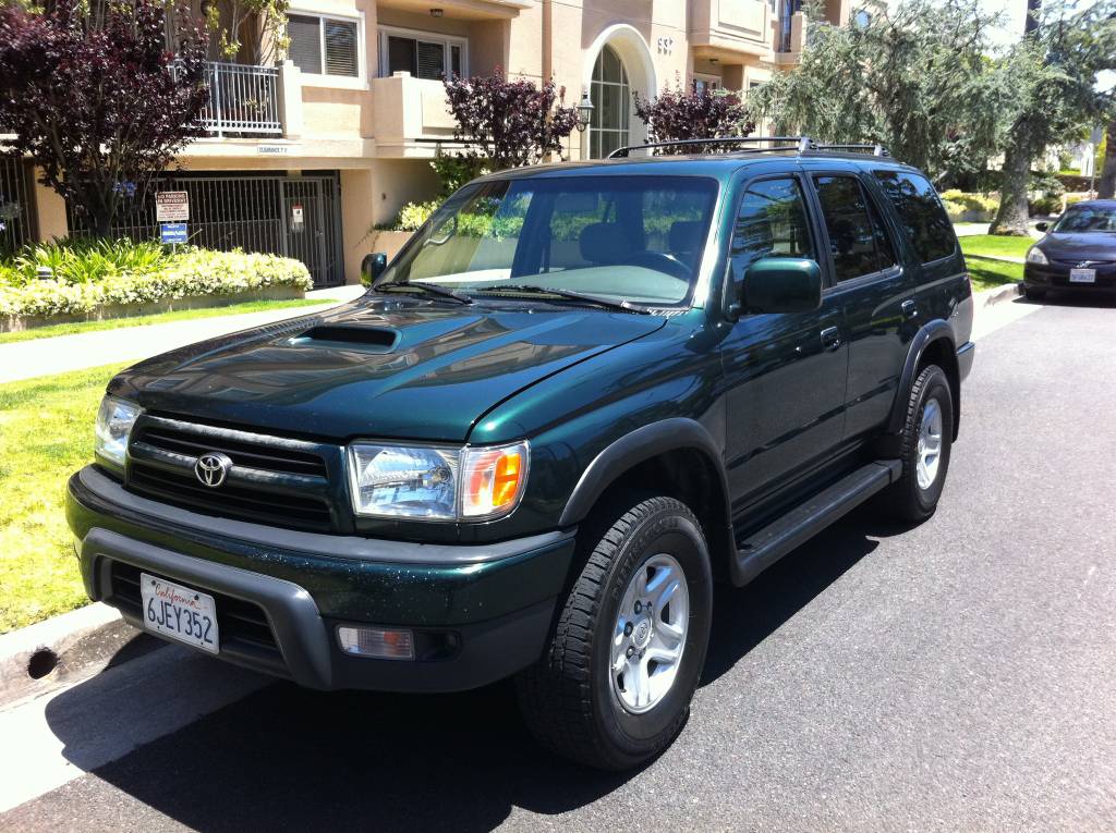

This is how it looked when I got it in June of 2011 with 67K miles for $6,000

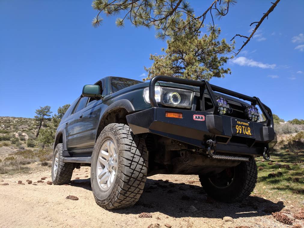

Here it is today at 263K miles

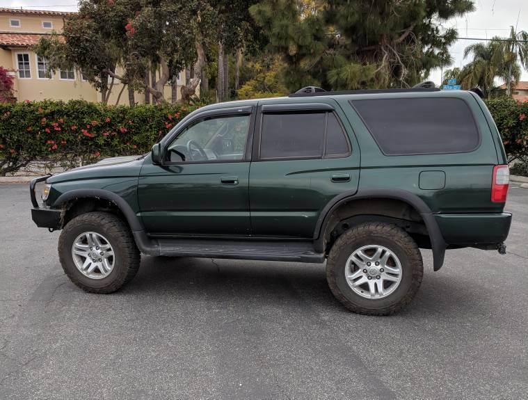

Installed LC 8-wraps
Pulled out my OME 890s and installed LC 8-wraps @ 263,812K and gained 2" in the rear.
With a full tank of gas and no humans, I measure 40" to the middle of each rear fender flare. Previously it was 38" driver/38-1/2" passenger.
The 890s were 17" and 17-1/2" uncompressed, the passenger side coil was taller; installer error?
The LC coils are 19" and 19-1/2" uncompressed and I installed the taller one on the driver side.
The pic below is with a full tank of gas and light load in the rear
Net result of the LC coil swap: too tall in the rear for my taste, but I'll drive it for a while and see if they settle down some.

Net result of the LC coil swap, too tall in the rear for my taste, but I'll drive it for a bit and see if they settle down some.
If they are used springs I wouldn't expect any settling.
If you end up pulling them I have some ToyTec 9602 3" springs in the garage. I just pulled the numbers and they are 18" and 18 1/2" respectively. That should put you more where you want to be. They're not going anywhere so let me know.
