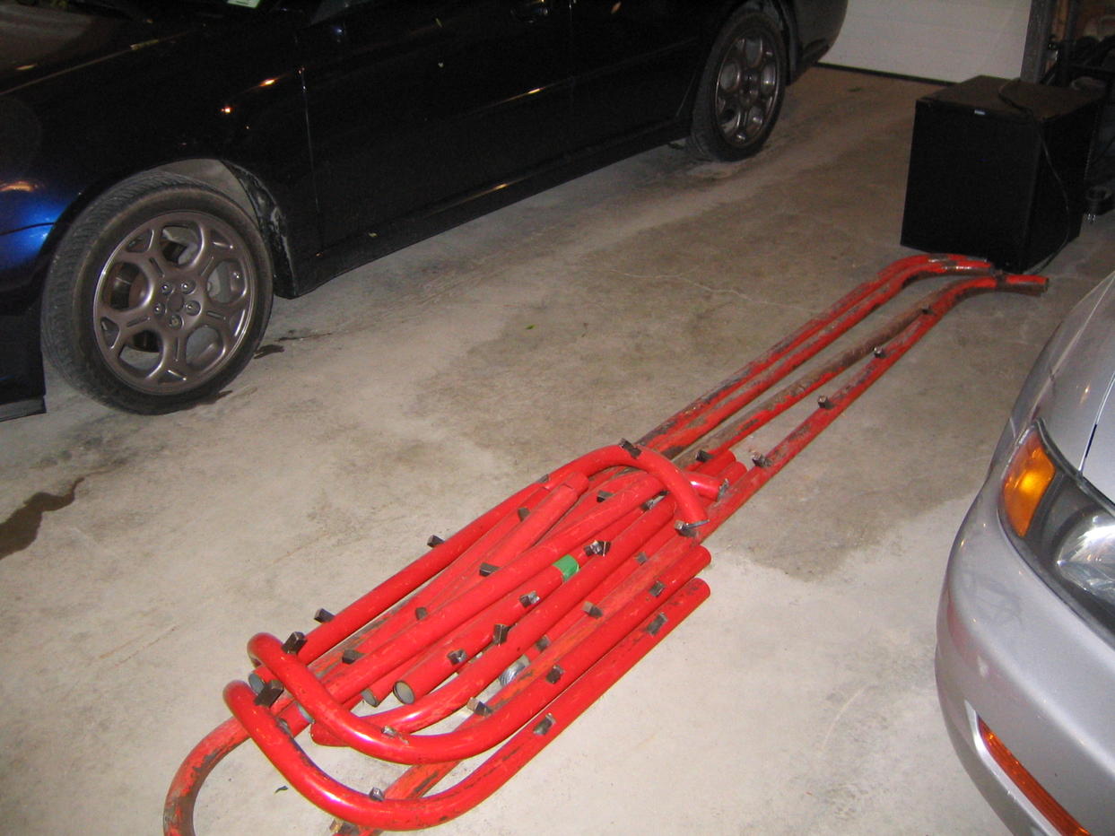

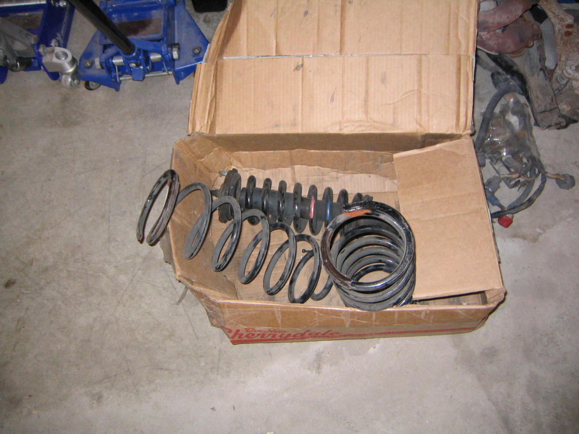

I'm very close to installing my '99 springs and new OEM balljoints, thinking maybe this weekend. Tomorrow afternoon a buddy is helping me fab up a hardpipe from the OEM airbox to the turbo, primarily to clear some room to install a 1500w recirculating coolant heater. I'm also started work on a headlight relay wiring upgrade, that will hopefully be finished in the next couple of weeks! I'll be doing the tacoma whip mod to replace the power mast, and I guess I'll need a new windshield, which sucks. Oh ya, I've got metal to make sliders, and I'm hoping to get that done before fall.

I've only ever seen those lights on imported Surf's, and some in the UK that were imported to there. They do look unique, but they've seen better days, and could use a refurb. Has anyone come across a high heat reflective paint you could respray the reflector with?

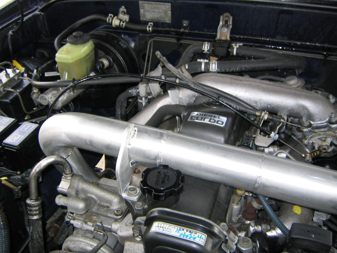

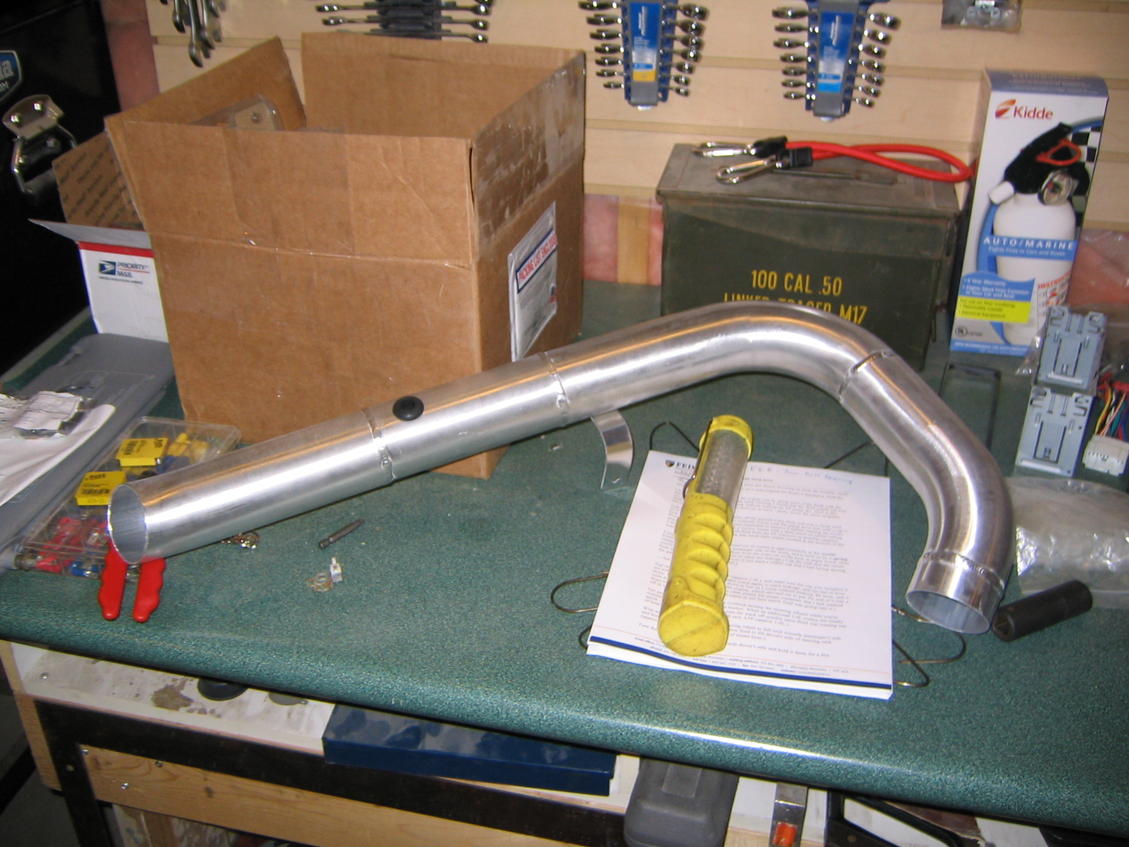

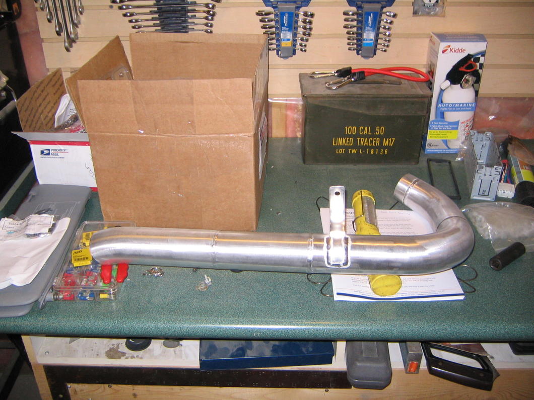

Got most of the intake built on Friday afternoon, just need to drill the hole for the IAT (I have a grommet), and get a 2.75 - 2.5" reducer, to connect to the stock airbox. The way we built it I can use the stock airbox for winter/dusty condition, high water, etc, or run a cone filter if I choose to go that route. I'll try and snap some pics in the next few days, it turned out really nice. Made from 2.5" aluminum tubing, and mandrel bends, my buddy tig welded everything really nicely.
Finally got around to snapping some pics
-The intake, just about finished, waiting on a 2.75" to 2.5" reducer, which should be here tomorrow
-'99 springs, hopefully getting installed this weekend
-pile of old railings, maybe someday sliders...

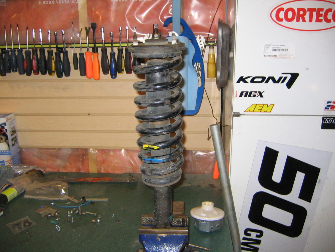

Well, I got the '99 springs and new OEM lower balljoints installed this weekend, but I wrecked a tie rod outer in the process, and couldn't for the life of me get the old one seperated from the inner, so I've still got that and an alignment left to do, but it's driveable for now. Measured lift is only about 1/2", which is a bit disappointing, but I haven't heard the tires rub on the fender liners since, which was the main motivation behind the swap, so that's good.

Weird that it was only 1/2" lift, I wonder if overseas 4Runners were higher from the factory than local ones?
I'm thinking the '99 springs may have settled, in combination with my '96 springs having low kms on them, and possibly some extra weight due to the iron block diesel (this is a guess at best), but either way it isn't really noticeable, other than the tires don't rub any more, which is great. I got my tie rod outer and alignment done yesterday, and it drives very nice. I'm contemplating adding a trim packer to the rear springs to give me a bit of rake, unsure on that for now.
Well I ordered 2x OME 10mm trim packers for the rear today, hoping to achieve a small raked stance. Still no rubbing from the tires, so I'm going to deem this a success!

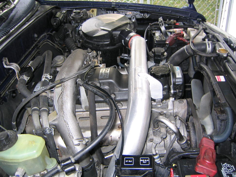

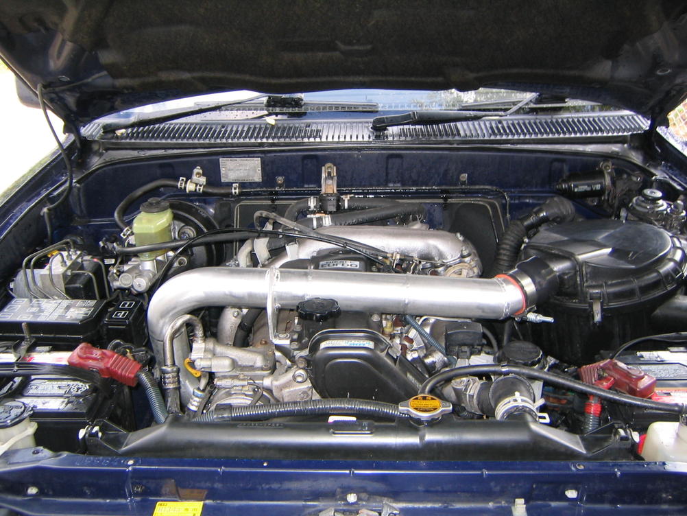

I got the intake installed about a week ago, but it needed a little fine tuning to fit properly. We got that done last night, and scrapped the old bracket for something totally different, and it's ready to snap some pics and show off tonight! Still no tire rubbing since the '99 spring install, and I have to say it's GREAT being able to drive however you want and not worry about that embarassing noise, that's not what I want to turn people's heads, lol. So pics coming tonight...

As promised, pics of the finished intake! We designed it to use either the stock airbox, or a cone filter, turned out pretty nice. Turbo whistle is more prominent, and it looks good. The driver of this project was to clear up room for a circulating coolant heater, not for power gains, as this just carries unboosted, filtered air to the turbo anyways.
