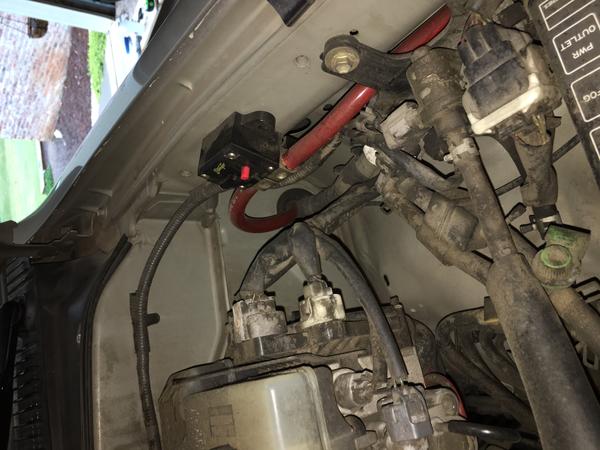

This is where it runs into my 150Amp Main Breaker

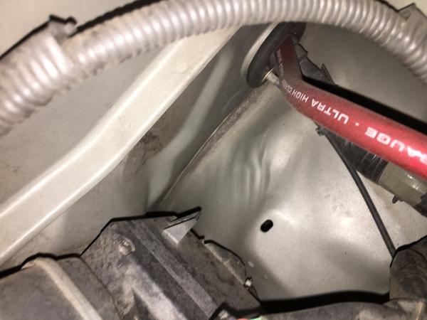

A pic of the wire going through the firewall into the cab

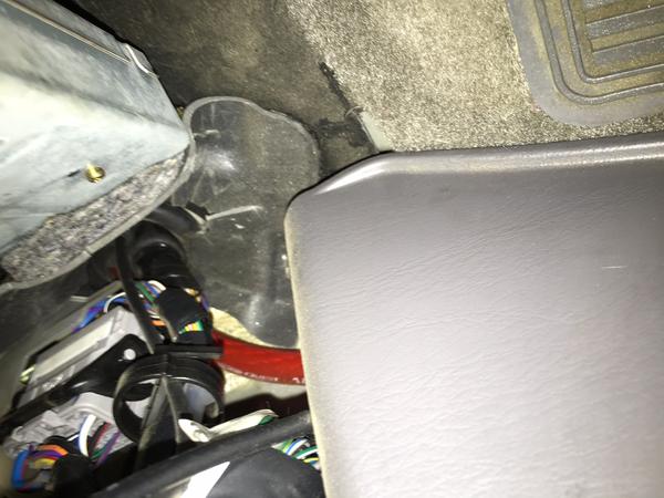

This shot is inside the cab coming in from the engine bay on the drivers side where the fuse box is

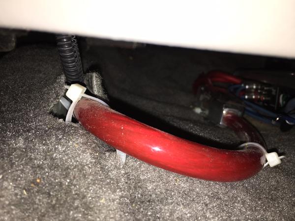

And this is where is comes out under the drivers seat to the distribution fuse block. It is split there to the amp and the other goes to the inverter
