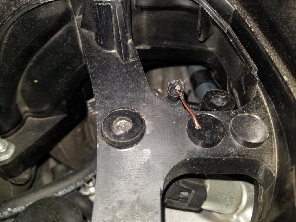

Went to get in the Pro over the weekend, started fine. CEL, ABS, Multimode terrain not available.

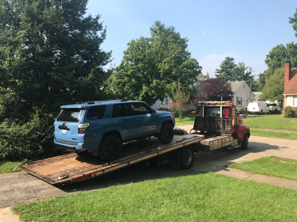

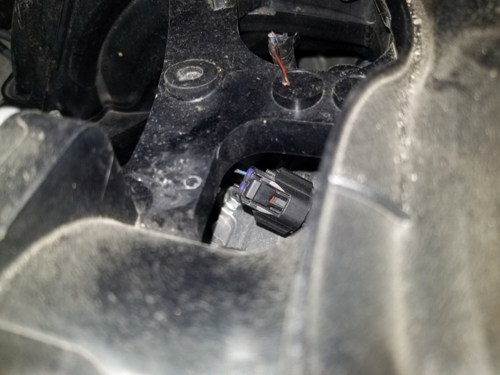

Towed car to dealer. They diagnosed and found a chewed through oil control valve wire. $200 to repair wiring. Toyota not covering repairs under warranty. Spoke with Toyota HQ and made a case number.
I know rodents and other critters have been digging around cars since the beginning of time, so I don’t expect Toyota to cover it under warranty. I also know that the soy based wiring material doesn’t help the critters from staying away.

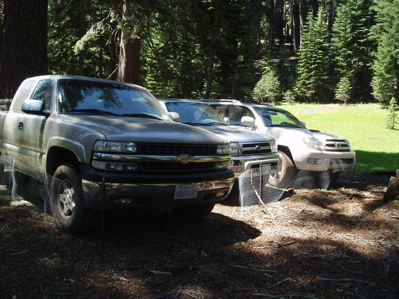

One technique that *used* to work was setting up a chicken wire fence around your car perimeter. But the critters figured out how to defeat it. They’re pretty strong and can push or dig under a flimsy fence.
(See photo below)
