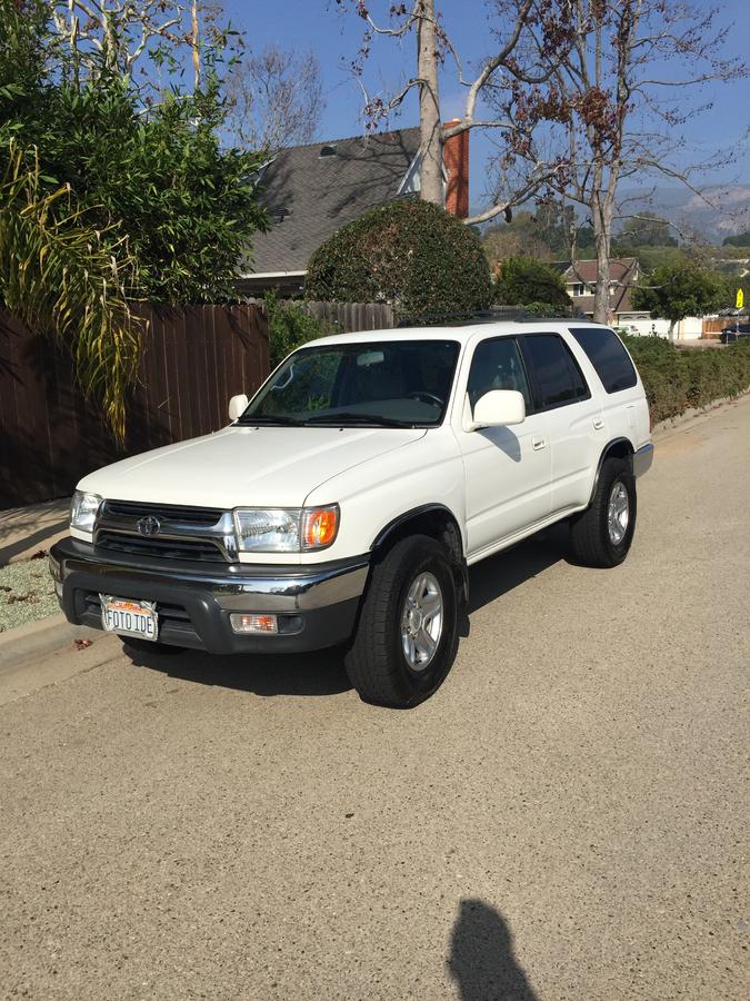

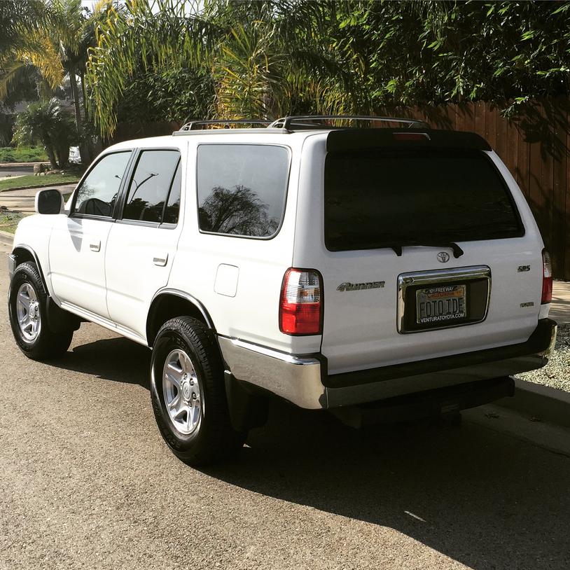

I recently purchased my first Toyota 4Runner and decided to join this community to learn more about 4Runners and what I can do with mine.
Three days ago I found a 2002 SR5 2WD on Craigslist with only 92,000 miles on it. The seller was the original owner who appeared to have babied this truck. Both the interior and exterior are in pristine condition.
The seller did not have service records, but she claimed to have kept up on the scheduled maintenance'. It is due for an oil change and I am told I need to replace the spark plugs and serpentine belt at 90,000. My question is, are there any other belts I should change, do you think the water pump should be looked at, or is there any other maintenance I should have done to ensure my Runner is in tip top shape?
Once I have the maintenance squared away I plan on starting some mods. Any advice on good starter mods?
