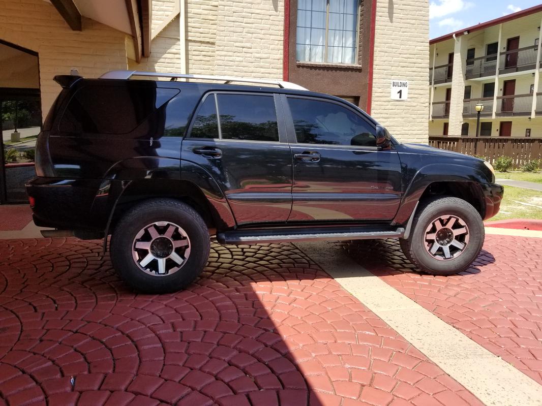

I bought a TRD pro suspension from a 4Runner and started with the Toytec lift which includes the rear springs and Front spacers. With all the spacers up front, there was still quite a bit of rake. The 13” 550 lb springs are just not enough for the V8. I ended up getting the eibach 14” 650 lb springs and now it is pretty level with no spacers up front.

Sorry this took so long. Here you go. In taking the pictures, I noticed that my mechanic buddy left in a piece of the Toytec spacer (it was 2 parts), which you can barely see in the picture. I may take it out because my truck has reverse rake when towing a trailer even with my rear air bags.
That doesnt look bad at all. J went ahead and bought the toytec 1 inch spacer. I'm hoping this does it for me. I did more digging and fj and 4r pro suspension all same except the spring. Fj uses 14" spring on bottom ring groove mount 4r has 13" using the top ring groove mount. So a 14" spring wont help lift just with ride and travel of the shock. But I dont know if I can get a 15" spring and mount to the bottom and have enough shock to supply that spring.
