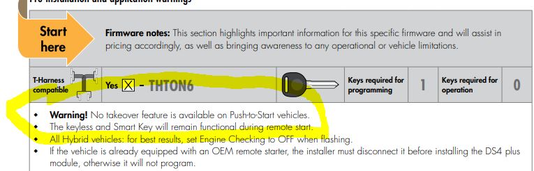

It's not programmable, it's a Toyota/Lexus thing roughly 2002 and up. The firmware driving the remote start bypass is just expoiting the OEM start feature in the BCM.
There are other vehicles out there that do not shut down that are PTS. Nissan, Honda depending on firmware, Hyundai/Kia, etc.
Below is an example of a Viper system straight out of an install guide for 4Runner PTS:
Directechs | Designed by installers for installers.
