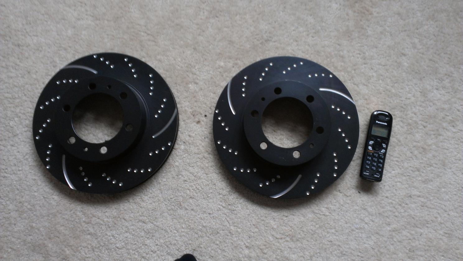

Just got my EBCs
So i ordered these for Summit Racing Friday morning at 10AM and I came home Saturday at 1PM and there they were THE NEXT DAY WITH FREE SHIPPING. Now im just waiting on the Hawk LTS pads.:) IMAG0310.jpg

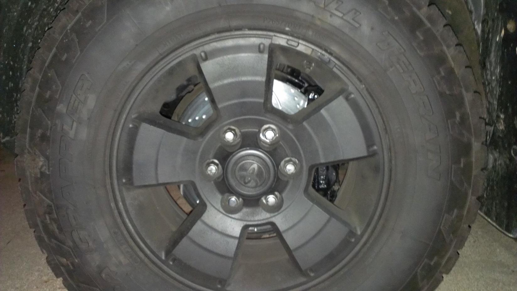

I hope the LTS pads are better suited to our rigs than the Super Dutys are. I had the SDs and they had very little stopping power when you first applied the brakes. Then they were awesome except when the right (for me) would grab better and the rig would pull hard to the right. I pulled them off and installed the Ceramic pads from O'Reilly's.
I've same setup: EBC 3GD front rotors and Hawk LT pads all around. You'll love it. My opinion after 6 month of driving: Rotors - great casting and perfect break-in but black zinc coating is weak (i painted mine black with brake caliper paint after coating started fading and little rust develop), Pads - solid and consistent but compound little soft (fast wear) which might reflect on lifespan. GL

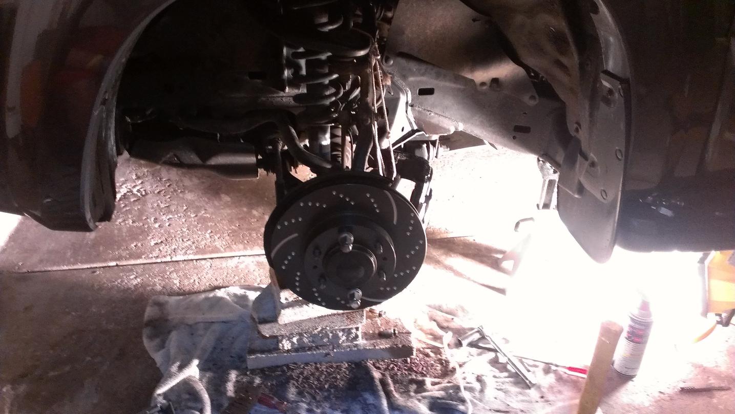

Only got one side done. Cant get the other so im gonna take it to a local shop.

What do you mean you can't get the other side? Gonna cost you a couple hundo to take it in. Rotor stuck on the hub? What's wrong?

The pins are even more stuck on this side and it rounded the tip of the pin so when I did get it lose I would have to file the pin down. My dad has a buddy that works at a local shop and he said he can do it for around 100$
You're going to need new pins- so just cut the old ones in the middle with a dremel tool and hammer them out?
