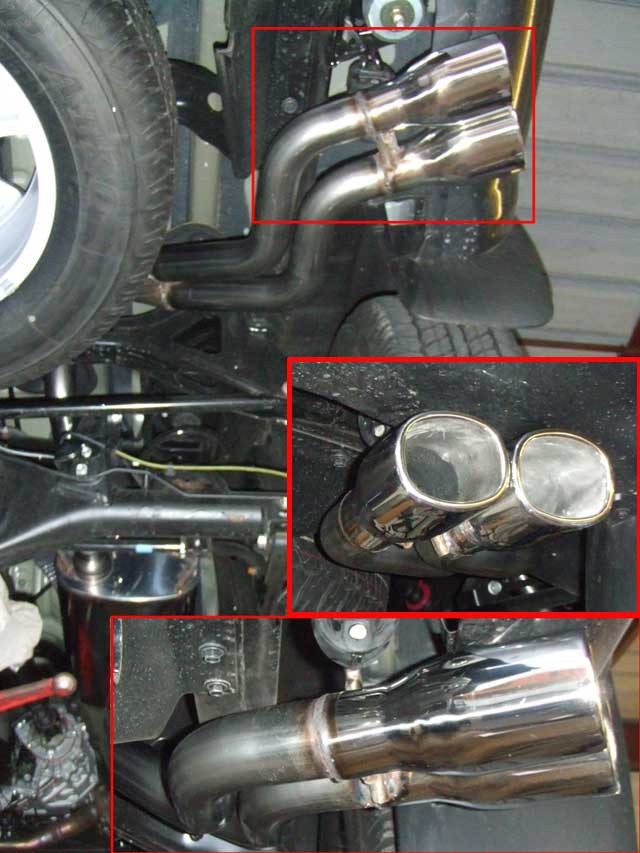

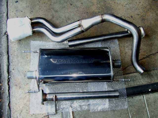

Just installed the magnaflow.
mole177
sounds great. haven't full throttle'd yet since i'm at 9xx miles only!
pictures up soon.
sure frees up that quiet v8:)

Finally :) thought no one on this board cares about exhaust systems.
(It's not too common to have this mod is there?)
Looks good.....Please keep us posted on the sound/drone after it breaks in?
Where did you buy? How did the install go?
I am still debating this mod. Not sure how loud it will be under a load/towing for several hundred miles.

I am curious what the cost of this mod is. If you simply just replace the muffler.....$120 for parts same for labor?
Those that have swapped different mufflers, do you change the pipes (size)?
Thanks in advance.
$80 for the muffler on ebay, $65 for the labor.
Labor - cut of resonator, fabricate pipe to turn out toward the side, install new muffler w/ new hangers.
I was quoted about $200 from a big named muffler company... the 65 was from a small, but highly recommended muffler shop.
Really cheap considering the benefits... (in my opinion)
