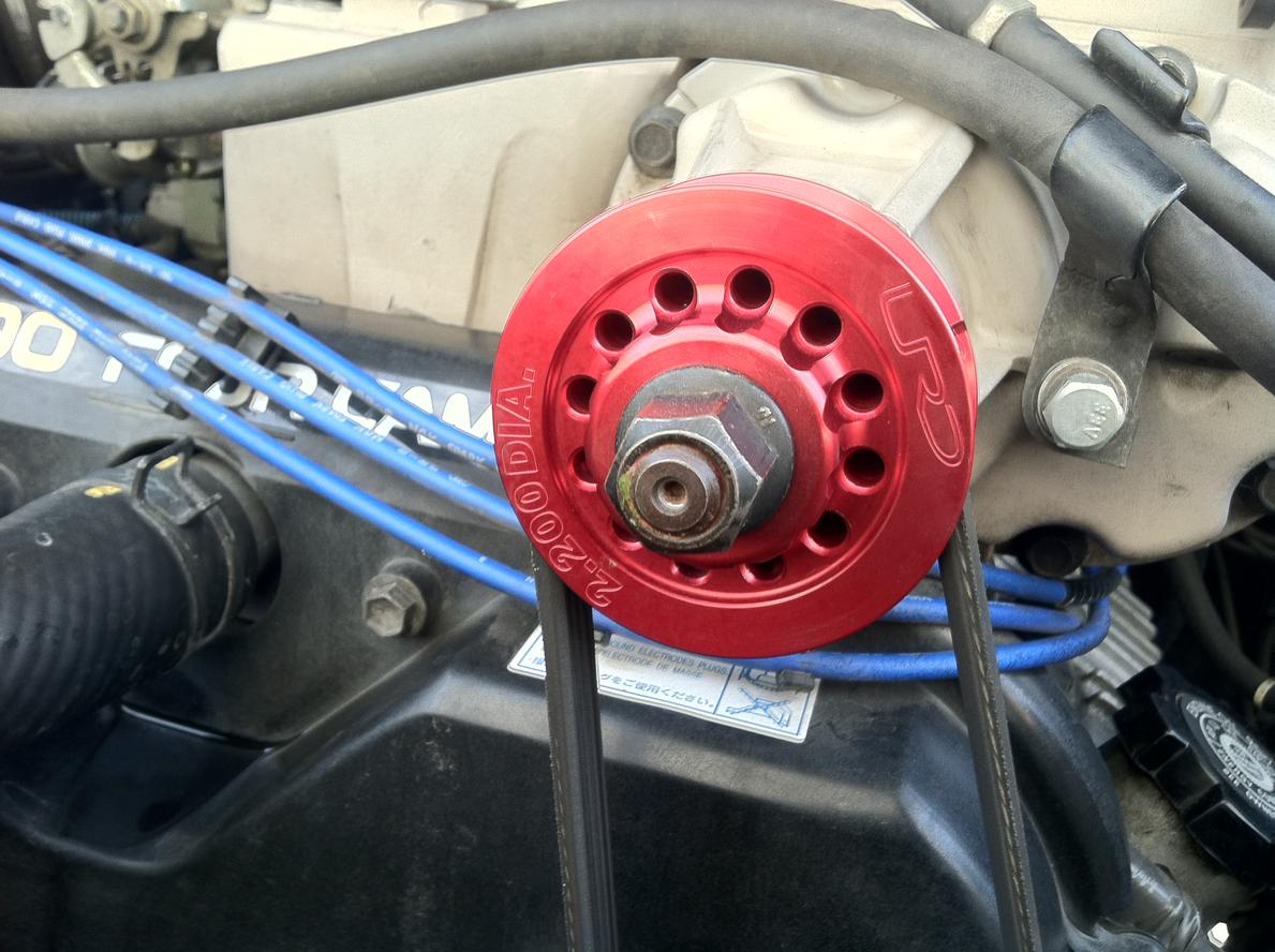

Good choice my friend! :thumb3: At some point definitely go the 7th injector route. It does make a world of difference (coming from a guy who ran it stock for a while) and along with the 7th definitely get a smaller pulley. URD 2.2 is what I'm running and it is awesome!

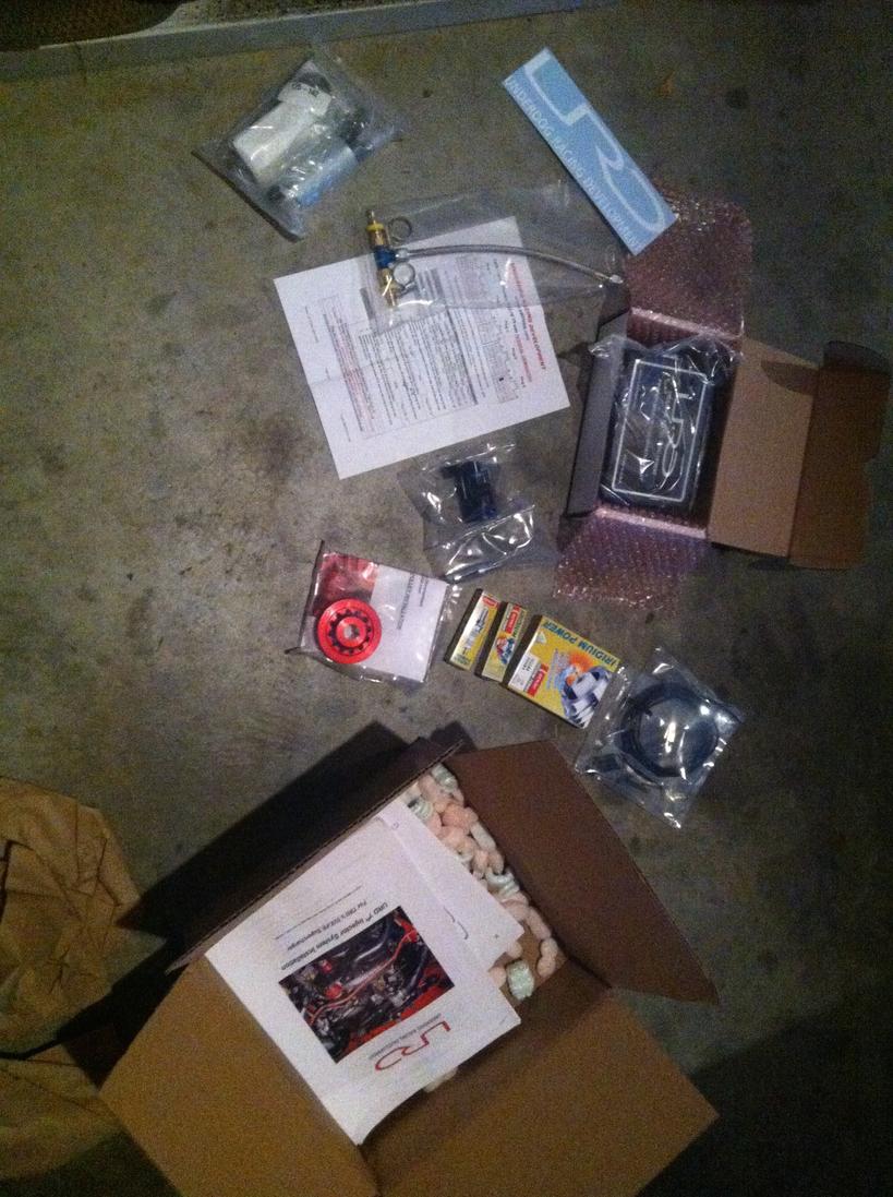

I just ordered the trd supercharger from here: COMPLETE Supercharger Kit Tacoma, 4Runner 3.4 PTR29-89020.
It looks like it has everything I need. Any advice? I am planning to run without 7th injector initially to see how things go.
Kinda can't wait for it to show up. Hope to have it installed before Thanksgiving trip to Anza Borrego.
Great upgrade. i live in san diego as well and i HAD TO HAVE the 7th injector. you will experience pinging for sure and thats not good. i suggest you get that 7th injector soon. after installing the supercharger and the 7th injector i also added the 2.2 pulley and now its all good. i do still need to dial it in with the URD software. good luck and also, hope you read up about the transmissions. some folks having slipping issues and some not. i took precaution and did a transgo upgrade for piece of mind. i didn't wanna just wait for it to burn up then fix it and cost lots more than just doing the transgo kit. theres a supercharger thread here that will help u as well.
OK. I'd rather do it right, so I ordered the 7th injector and 2.2 pulley. I'm gonna try to get the transgo kit locally and install it tomorrow. Pretty excited about this mod if ya couldn't tell.
