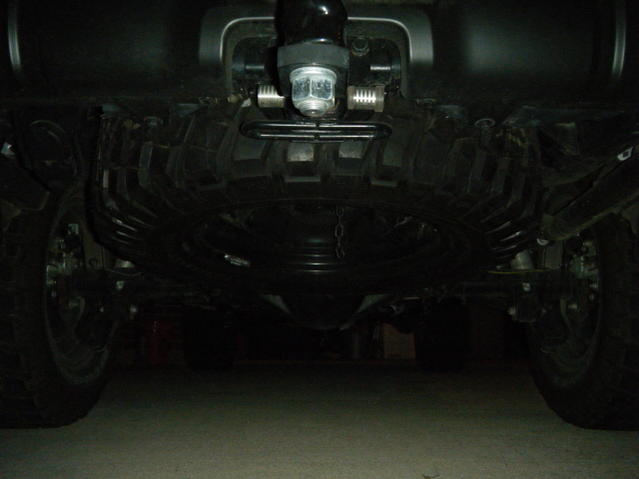

Went to Discount Tire today and had the Tire swapped out with the original. It fits perfect down below in the stock spare location. Any bigger it would definitely hit the KDSS boots. Currently it's slightly touching the hitch and has about 3/8" clearance where the KDSS is located.

Here are a few pics, cause I know I will not be the last one to ask if a 285/70R17 fits in the stock location. It's probably the largest diameter tire that will fit down below.
