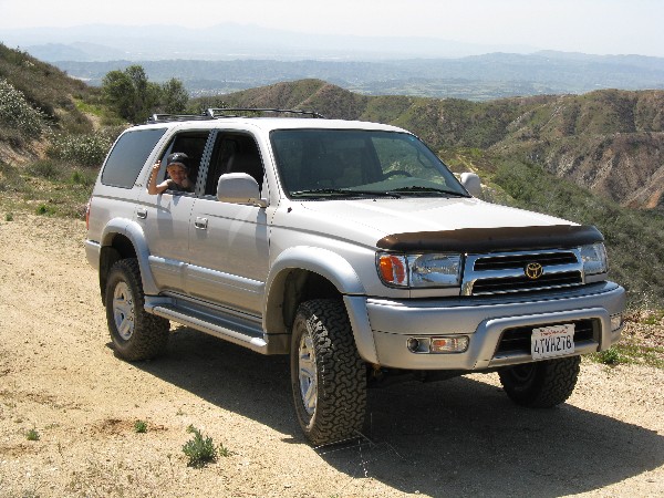

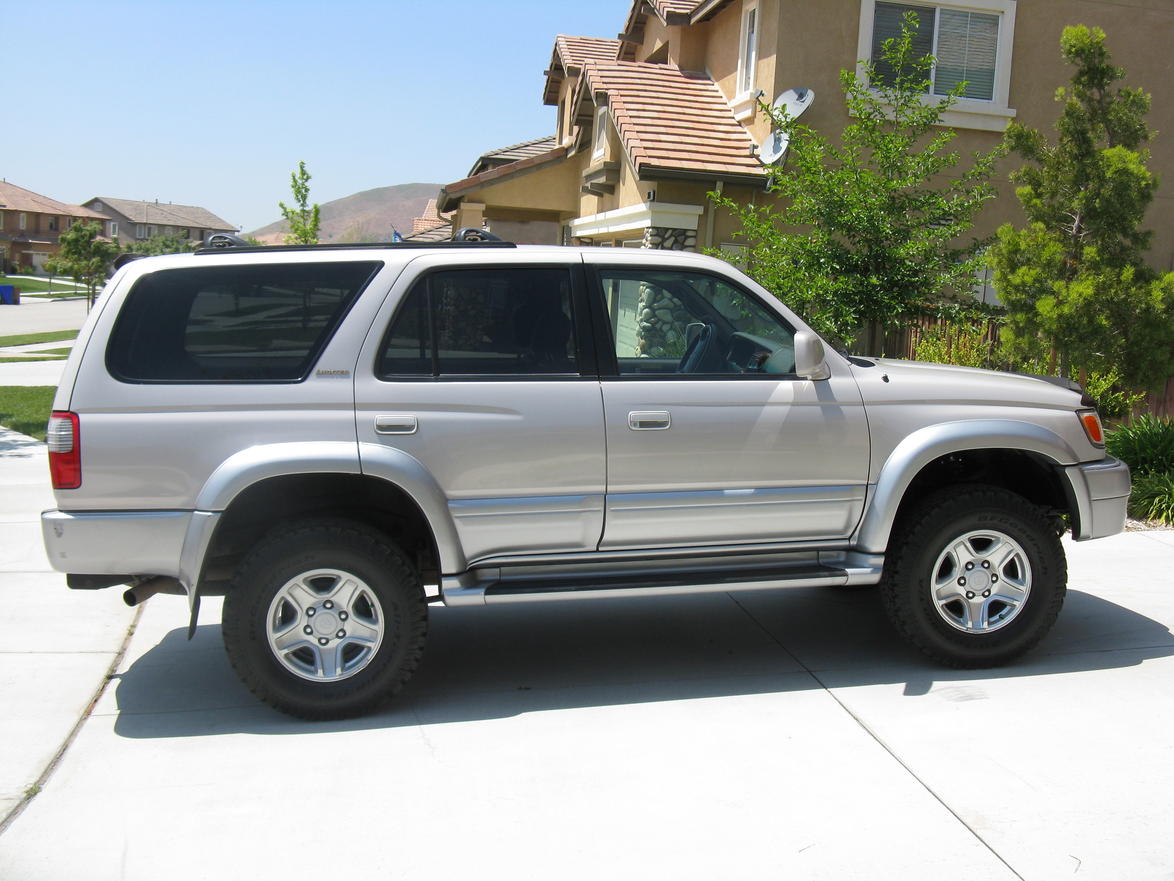

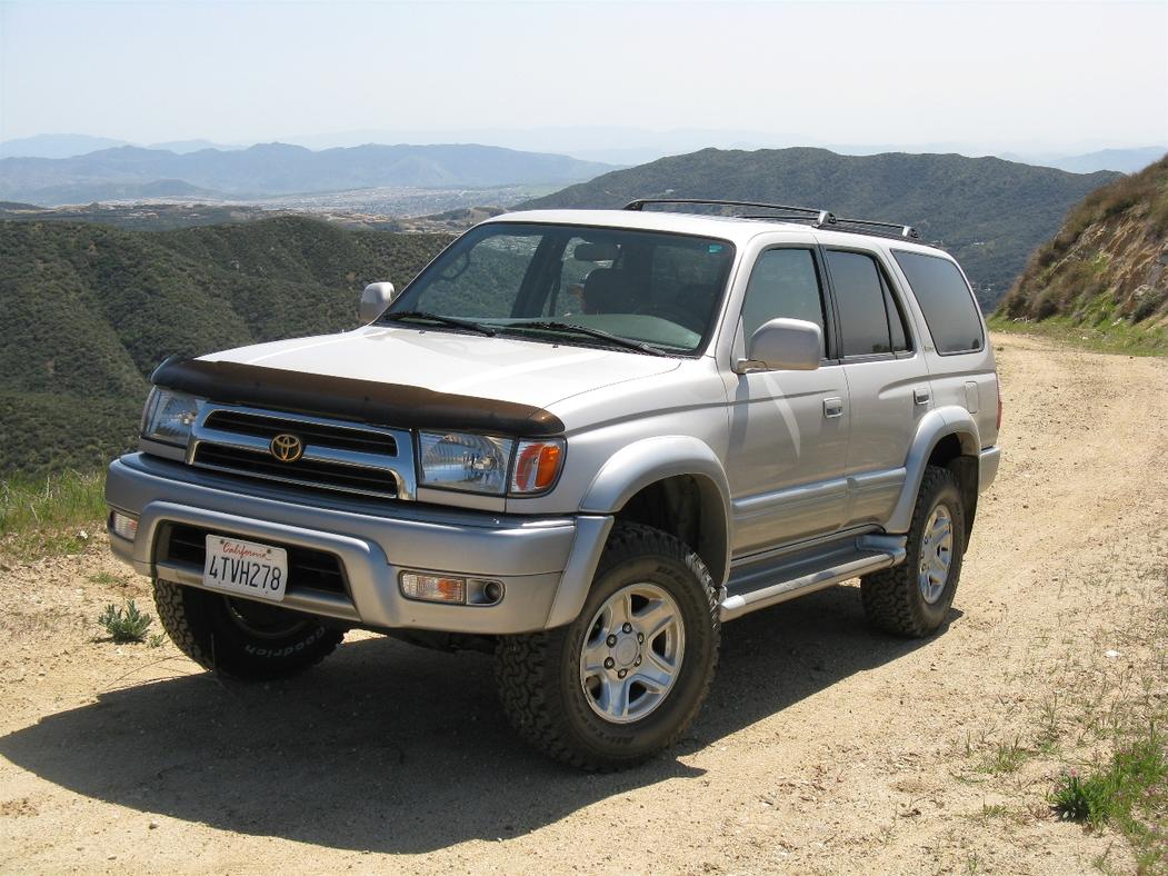

After 7 years of owning my 2000 4 runner limited I finally wore out my Michelins and put some AT's on there. When the tire guy put them on he mentioned my shocks were shot. Well thanks to the forum I decided to buy some OME shocks and coils from toytec and raise her up 2 inches as well. Couldn't be happier. Here she is last weekend on a mini outing on some local fire roads.

I went with 881 Front Coils and 90004 shocks in the front and 890 Coils in the rear with 60027 shocks. the rear seems a bit stiffer than the front going over the bumps.

Wow, that looks great! How is the ride now compared to stock? Have you noticed any sag when you're all loaded up with gear?

I paid $822 for the shocks and struts with coils and the front assembled. I paid a buddy from church to put them on for me. Work has been slow for him so i paid him $200. Then I had it aligned. Another 60 bucks. Not the cheapest route but I have a good job and had a bit of trouble finding a shop to put on parts I had bought online. But I am very happy now!
I kept 265's on there but went from Michelin XT's to Goodrich AT KO's. I didnt want to worry about loss of power or gearing issues and I really dont mind the smaller look. The offroad performance increase has been great

It does ride a bit bumpier on road but it is not annoyingly bumpier. Off road it just eats it up compared to stock, but if you are thinking this set up to be as plush as before as stock it just wont be. There is a small trade off here.

I just installed the exact OME combo. I notice it a bit stiffer but really love the ride. Makes it feel more capable.
I have no complaints with this set up.
