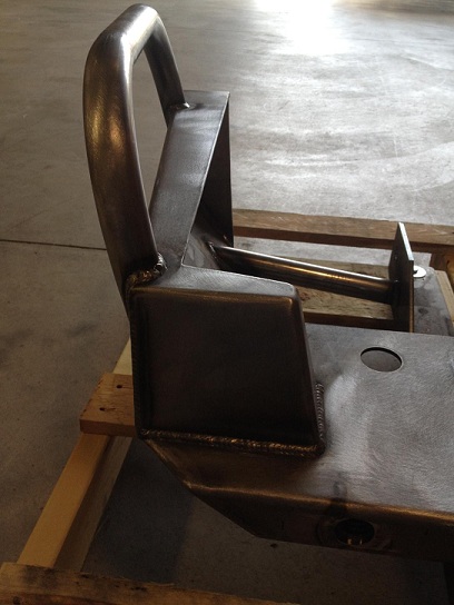

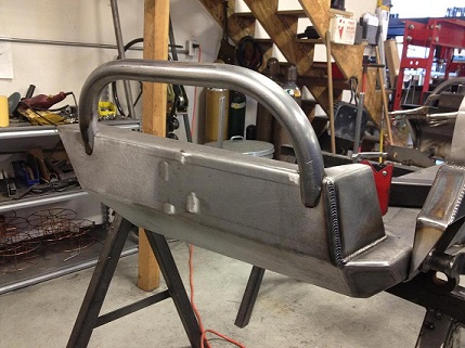

I chose bare metal mainly bc of time. I want to have it before my trip and I know it would take forever if it were pc'd. Pics are a representation of the custom side tubing they're gonna do.
