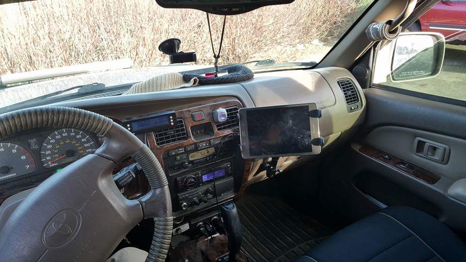

New mount for the new tablet! After debating forever where to put this thing, I decided against bolting it to the actual dash and just drilling through the glove compartment door and bolting it down. Much easier to replace the door than replacing the dash piece if I ever decide to remove it all completely.
I used the Arkon TAB806 mount. It's very solid, and I love the placement. Allows for me to see the rest of my dash as well as be usable for road trips if a passenger wants to watch a movie. Doesn't get in the way of passenger's legs/knees and can take the arm extension part off that leaves just the mount "nub". Can even open the compartment door without anything touching/resting on the seat, even with the tablet in.
