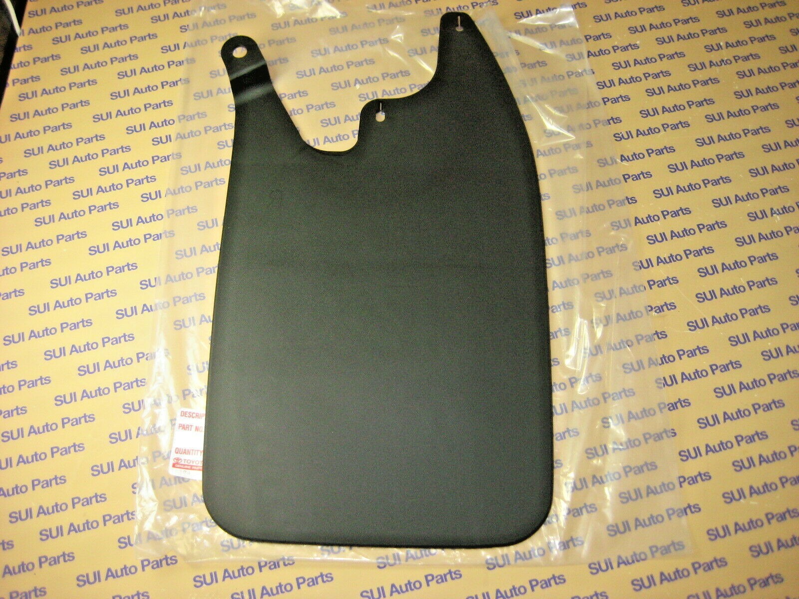

True! It’s great that BHicks stepped up to provide these. The OEM full length ones are still rare though.
Just learning now how to print in ABS, I might could modify the original model out there on thingaverse to make them look like the originals. Hmmm.....
The file for the original does exist somewhere - it is just bigger than most 3D printers. And it would be very fragile hanging down that low...

How about a hybrid material option? 3D print semi rigid as a short flare but include bosses for a flat rubber extension to be screwed onto.

I actually have a flat mud flap on mine now too, using the same 3 bolt locations that Tacoma front flaps use, like this:
Basically, the two on the OEM mudflap location and one inboard through the square hole in the body stiffener. I used a little aluminum bracket to hold the inner section in the right location. The downside/risk there is if you are pushing tire size, the flap pushes the mounting bolts even closer to the tire...
