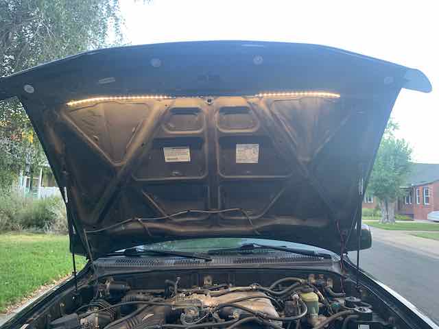

The Spiker Engineering hood struts are definitely the meat here and they sure look great at night with the under hood lighting showing them off.
