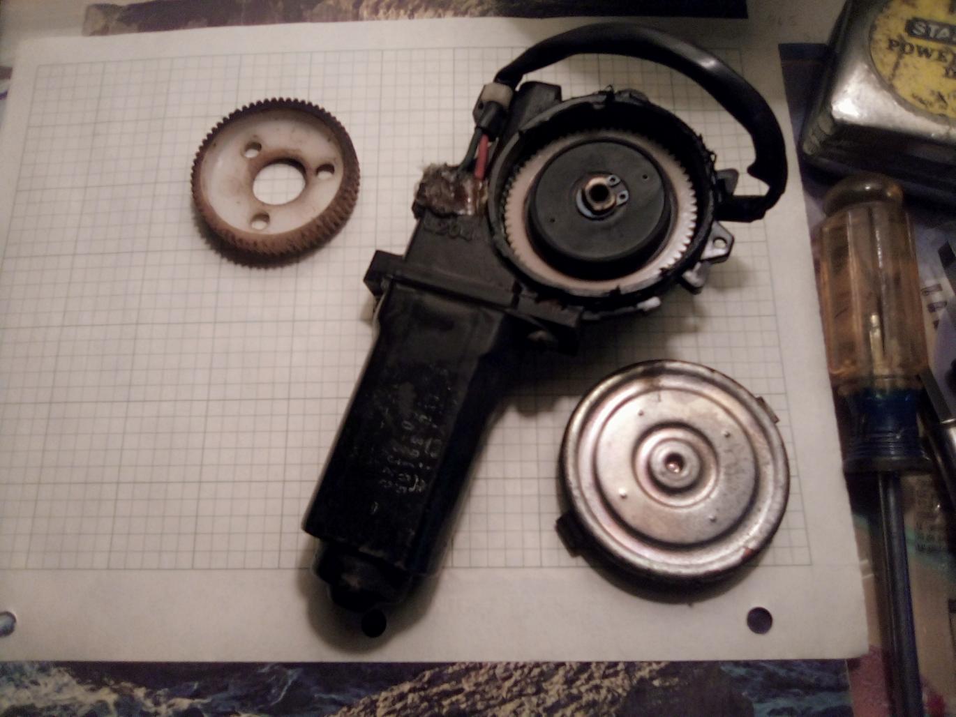

The rear window on my 1990 has a motor/gear reduction unit. It's all one assembly. When my rear window stopped working, I removed this motor assy and pulled the metal cover. The gear on the motor shaft is steel, while the large gear is plastic. My plastic gear was stripped. A trip to the local junk yard got me a new motor assy. I think this assy is used in many of the older Toyota models. I will try to post a photo, if I can figure out how to do it.
