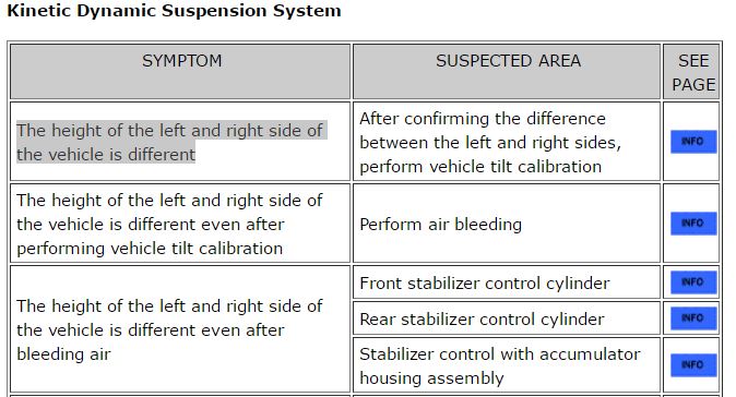

Please don't take offense to this, but I constantly feel like I'm talking to a brick wall whenever KDSS comes up. People just can't seem to look at any issue unbiased and think they are all experts. The system can and does cause leans. It is well documented. It is nothing like a regular swaybar setup. The system has pros and cons.. Some people just can't step back...
If you don't believe me... Why does the repair manual state this in the troubleshooting guide for KDSS.
I'll attach a screen shot so you don't think I'm making this stuff up LOL

Yea, lifts kits can cause lean.. Duh.I'm talking about a different thing. Please don't take offense to this, but I constantly feel like I'm talking to a brick wall whenever KDSS comes up.
Haha I feel the same way right now! KDSS can lean, (accumulator pressures out of whack I guess?) but lift kits don't make it lean. Lifting does not change the piston position.
