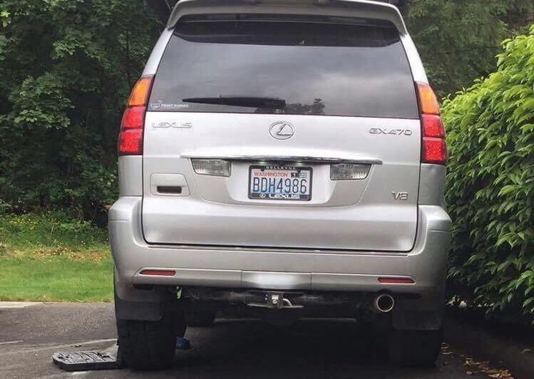

Sorry to quote such an old post, but I am at a loss right now with my KDSS.
Back in April I installed BP-51s with toytec superflex HD springs. Everything was great (and level, left to right) until this last weekend at the NW Overland Rally. After a rather rough trail run I noticed (from the drivers seat) that my vehicle was tilting to the right a bit. Thought nothing of it until I was getting ready to head home and noticed just how bad it was. My driver's rear was nearly 4" taller than the passenger, and front driver was about 2" taller than passenger. This was with a full tank of gas, and a yeti 105 full of food, beer, ice, etc. well over 100lbs, on the drivers side.
In addition to looking silly, left hand turns on the highway made my already top-heavy vehicle (rooftop tent, etc) quite discomforting. To the point that my wife asked me to slow down on a 60mph banked curve, where I was going 40.
I did the shuttle valve adjustment procedure as outlined in ARBs install instructions to no avail. Then, I opened them again, jacked the rear driver tire 12" off the ground, let it sit, and closed the valves before letting it down. After this, the front is 1" higher, and the rear is 2" higher. Progress, but that's as far as I could get it.
I dropped it off at Lexus today and they're stumped. They've had the vehicle for a full 12 hour day, and have seemingly made no progress. They hope to have an answer tomorrow, but I am not feeling too hopeful.
Would you recommend just paying the diagnosis fee ($450 so far) and installing a spacer in the rear, and adjusting the passenger front coilover to be taller?
It seems like a terrible bandaid fix, but if it works, it works. My fear would be the front not wanting to align correctly.

When I dropped it off the driver's side was ~2" higher than the passenger side.
They could find nothing wrong (all pressures were correct, no codes, nothing) so they drained all the fluid in the system, reset all the electrical parameters, and crossed their fingers.
It worked.
Out the door I paid $441. They forgot to ask me before replacing the fluid, so they did not charge me for it.
For future reference, I asked what they would charge if I were to bring it in again and request the system be flushed. They said it would likely be 4 hours of labor @ $150/hr + cost of fluid @$18/qt.
Soooo figure $672. Ouch. Hopefully I never have to do this again.
