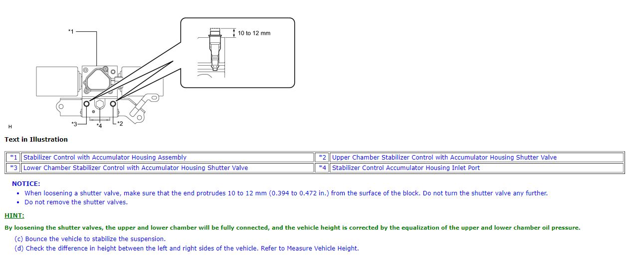

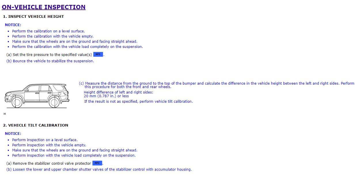

KDSS lean correction prcedure
Thanks @wfo9
I really appreciate your posting that procedure. I got a good look at the actuator valve when I was installing my bolt-on rock sliders.

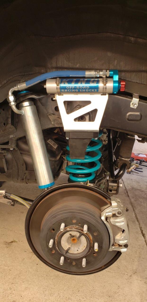

I have the Dobinson KDSS specific springs and yes it did fix the KDSS lean. I didn't even have to adjust the front coilovers. I have them exactly the same height for the front. :thumb:

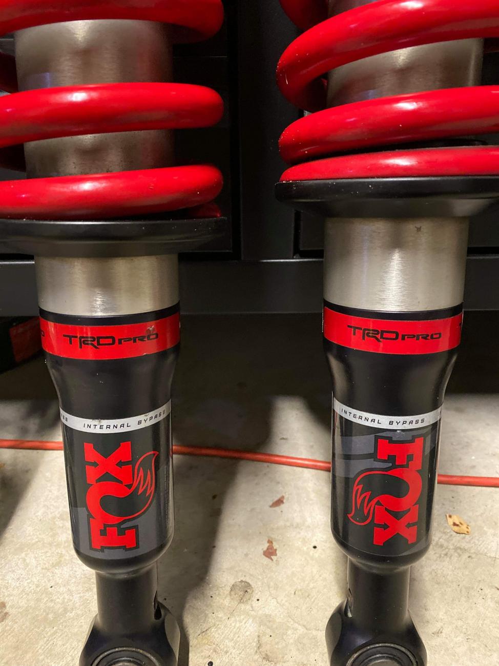

Thanks for posting such detailed thoughts... With that said I have a serious question. I am thinking of getting a lift on my 2016 KDSS. Currently I am looking at 2019 TRD pro fox shocks- Front coils are actually different lengths. See photo below. Would you recommend I install this or an adjustable KING suspension? Futhermore, if I were to install these trd fox shocks- should I send the longer coil to the passenger side?
Thank you for your thoughts.

I don't have any personal experience with either King or the Fox TRD Pro shocks, so I can't really give you any advice on one vs the other. If I wanted a stockish height and I had both, I'd probably go for the TRD Pro set over the kings. They should have a better street ride and the bypass setup should also perform very well in the dirt. If you wanted more lift - then the King would be the way to go IMO.
I would put the longer one on the passenger side and then use some thin shims to level it out from there. IIRC the fox TRD Pro shocks actually have two machined slots like the Bilstein 5100/6112 and you could potentially move both of the lower spring seats to the same level by removing the coil, and then moving the circlip to match. That's another option to start with two matching length shocks then adjust to level with some thin spacers on top.
I’m looking at them now and can’t see anything, but maybe it’s hidden underneath the lower coil? Do you think I can disassemble these with your standard coil condenser rental at the auto store?
