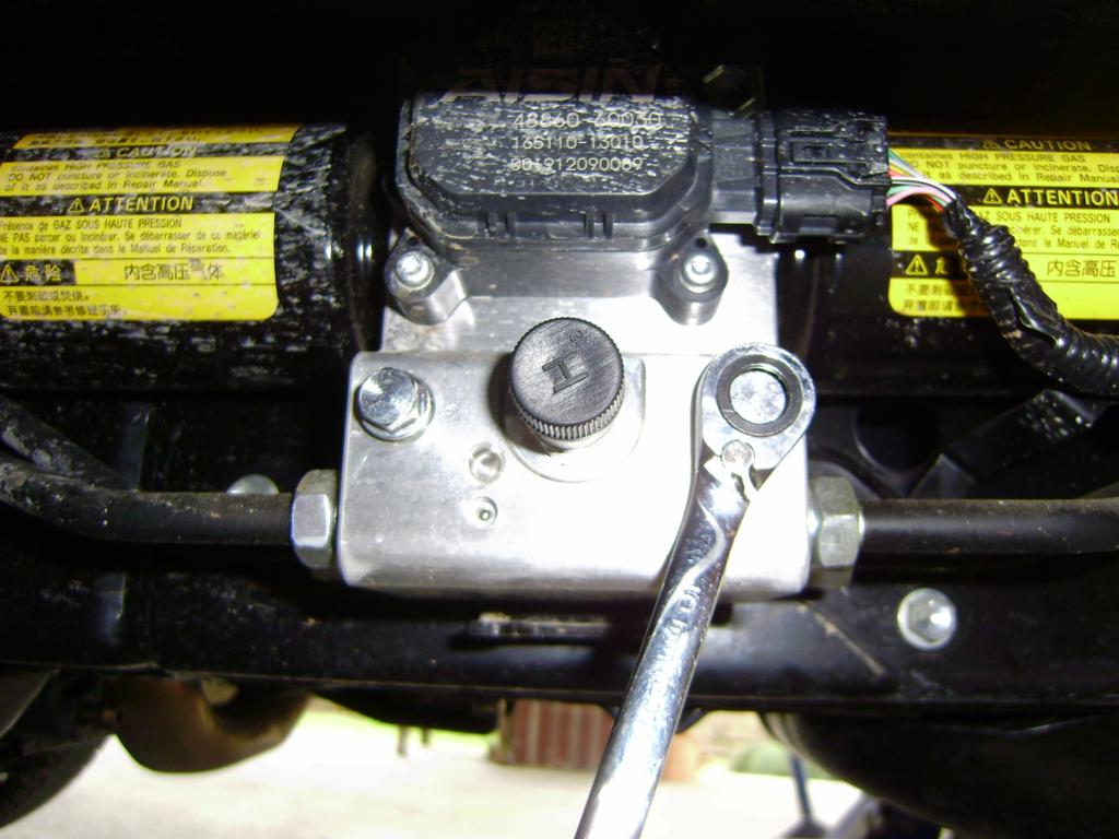

I can't take credit, but someone PDF'd the guides/photos years ago and I saved copies. I know it's not a video, but it's still pretty good.
Placing a bottle jack under the front KDSS piston makes it much easier when you disconnect/reconnect the end bracket at the LCA for each side. Manipulate the jack up and down to get it disconnected and reconnected. The top of the bracket will roll forward releasing the hook at the bottom. When reconnecting them, take your time as the bolts are very easy to cross thread.
I used several ratcheting straps to keep my front KDSS hydraulic ram/piston from expanding and moving out of position. I disconnected the sway bar ends and left it attached to the piston.
Life will much easier if you open the bypass valves 3 full turns - NO MORE; it makes moving the piston much easier.
