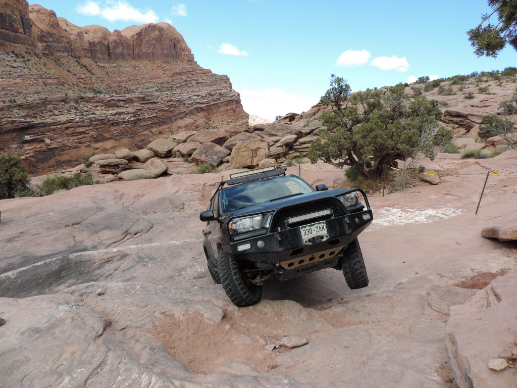

The IFS has pretty limited travel, I don't think it is really limited by KDSS. I have seen my suspension many times when one front wheel is fully stuffed with the LCA against the bump stop and the other wheel is at full droop in the air.
Not sure if this is fully compressed on the driver's side, but it is near full droop on pass side.
This is full stuff pass side and full droop driver side; there just isn't that much wheel travel to work with

I mean yeah if you want to build a seriously modded rig like a few of the guys have and have a different daily driver. If you do lots of pavement driving do not underestimate how the handling will be changed (you probably will not like it).
I don't do extreme stuff with mine, but love KDSS for the ability to do a 5000 mile road trip, have great comfortable, crisp handling on the highways getting to Moab, then traverse the White Rim Road, then back on the highways.
