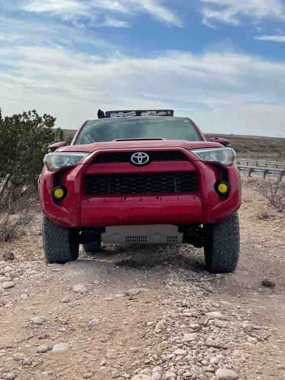

Took the front sway bar off yesterday and damn, I really wish I would have done this sooner!! I have OG TRD Pro Bilstein suspension so nothing special and on road I can’t hardly tell a difference at all. Off-road this thing handles SOOOOO much better. Bumps and whoops are not nearly as jarring as they used to be. Now I’m debating removing the rear and all the components. I was wondering tho, has anyone found some way to remove front components and block off the lines?? IMG_1463.jpg
