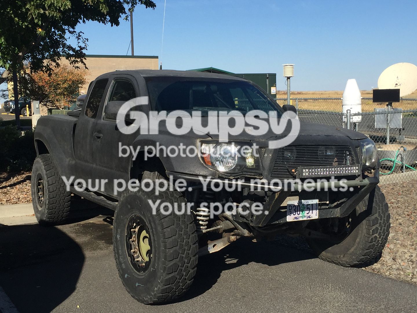

I don't know about that...my old Tacoma embarrassed some nice cars in the twisties. Body roll can be controlled with spring rate, and also wider stance. I'm not going to long travel a 4runner, but maybe a mid travel setup would meet my needs. I dunno. Headed to the dealer to test drive one.

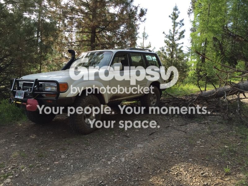

I'm currently driving a 25 year old FJ80. Even the base model has to be better than this ol thing!
