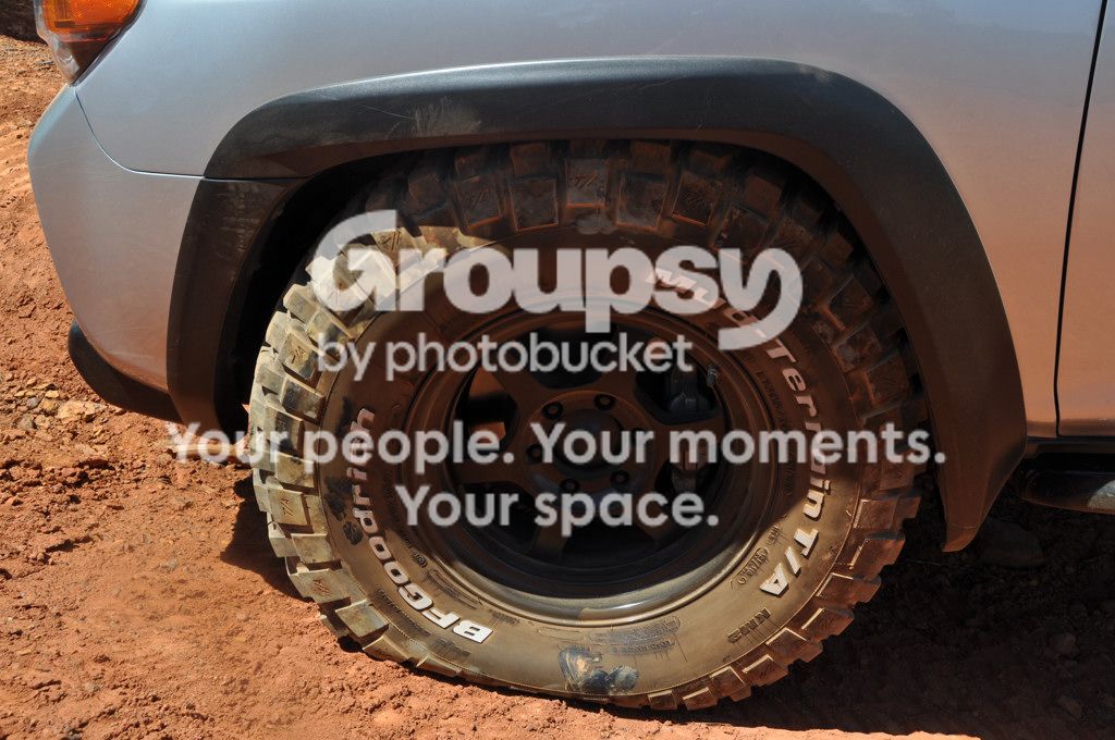

Compare your pictures to this:
http://www.toyota-4runner.org/members/ramans4runner-albums-my+4runner-picture17262-image.jpg
Look at the compression of the front tire...compare that to yours. Is it significant? Your call. Frankly, i rather have the system for its duality.
Thanks to Ramans4runner for above pic.
My mistake, I completely missed one of the points I was trying to make between my pictures and the ramp test pictures Harper7 posted. Both are 100% stock KDSS suspensions, and yet one manages to compress the front tire substantially higher up into the wheel well than the other. Is either picture lying? Definitely not.
So if you ask me it really seems like looking solely at a ramp test does not paint a complete picture of what any one vehicle is capable off. This also revovles right back to my initial statement about how it's probably hard to quantitatively measure something so dynamic with such a static test.

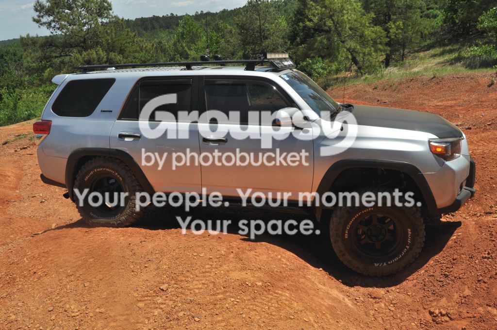

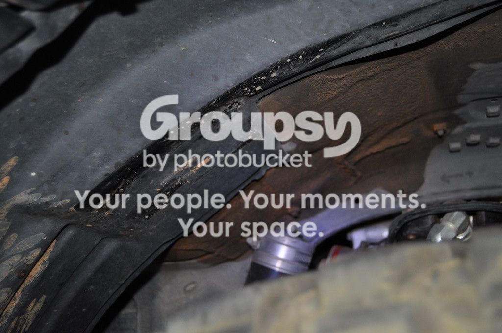

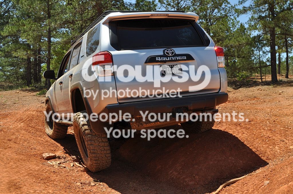

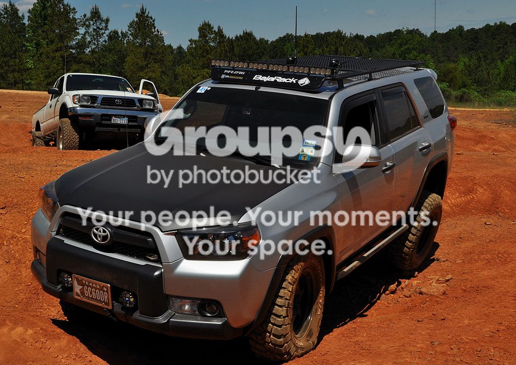

[MENTION=2]Thai[/MENTION] it appears that you like to post the same picture of the ramp tests which prove your point, but automatically dismiss [MENTION=8206]harper7[/MENTION] picture of his ramp test, just because it does not illustrate your point as well as you had hoped...so can we please just agree that ramp tests are probably not the most accurate for real world discussions? (I honestly don't care if you really agree or not, but please for the sake of moving forward and my sanity, let's just pretend we agree okay? :))
Sooo...in hopes of keeping this more relevant to what the majority of people here will be doing with their 4runners, let me try to engage you in a discussion of a more realistic example of what I think most of us would encounter off-pavement.
First and foremost, I am a complete newbie when it comes to all things off-road, and the below example is literally the first time I've ever hit a forest trail in a 4x4 vehicle.
As you can see below, on a not so wild fire road, I've managed to complete flex my 100% stock KDSS suspension to what I think appears to be just about its limits. Please note my driver's rear wheel is actually off the ground by a wee bit. Granted, maybe I didn't pick the proper line, approached this at the proper angle or whatever, but that's not the point here.
My question to you is...in this situation, how has KDSS helped me anymore than an SR5/LE if I'm still lifting one of my rear tires? Are you going to tell me well...KDSS helped me to have my tire only lift off the ground by a mere 1-2" instead of more?
Maybe I just don't understand the physics or techniques...but to me, it doesn't matter if the tire is in the air by an inch or a foot, a tire in the air is just that, a tire in the air; and well that tire in the air is certainly one tire that I can't count on helping me to drive forward right?
This is why even an amateur like me doesn't whole heartily buy into all the mythical off-road benefits that you so persistently claim is there. I don't doubt you that there's some benefits, but I also don't agree that it's as hyped up as you make it seem. Yes, I know, I know every little bit counts, I think we all get that by now.
Now if you ask me, I'd probably benefit a lot more from some longer travel more than easier articulation...I mean yeah you can articulate easily, but what about once you reached the end of the articulation limit :doh:

Where it was hitting on the top inside of the front fender well liner albeit I also have taller 34" tires.
