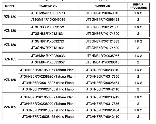

Okay, I did some research on the fuel gauge issue..mine just reads Full all the time. Doesn't change. That doesn't seem to align with the symptoms of the TSB. Furthermore, I don't think my VIN aligns with the recall range - my last set of digits are Y0286572:
Screen Shot 2018-06-04 at 5.58.34 PM by keaton.burleson, on Flickr
Hoping its just a wire. Will check when I get a chance. I think the gas tank skid is a bit banged up, maybe the tank is dented?
What do you guys think?
My fuel gauge had the same issue, it ended up being carbon deposits on the reader in the tank. Its attached to the fuel pump. You can pull it out and use a pencil eraser to thoroughly clean it. It wouldn't hurt to do that and put in a new fuel pump, two birds with one stone. My fuel pump failed with no warning at 180k miles and left me stranded.
And your dented tank wouldn't cause it to read full all the time, it sits higher up in the tank.

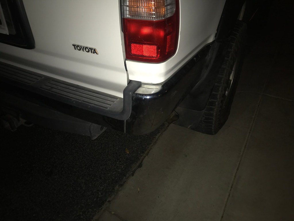

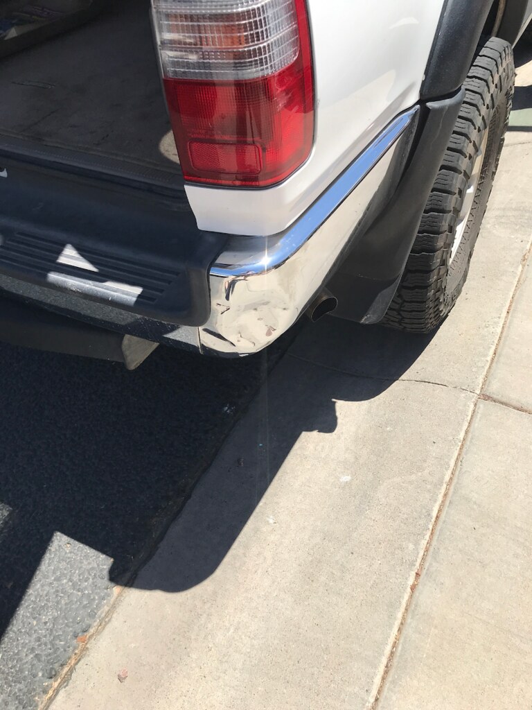

I finally replaced the bumper corner with the new one the owner included with the car.
Before:
old bumper corner by keaton.burleson, on Flickr
After:
new bumper corner by keaton.burleson, on Flickr

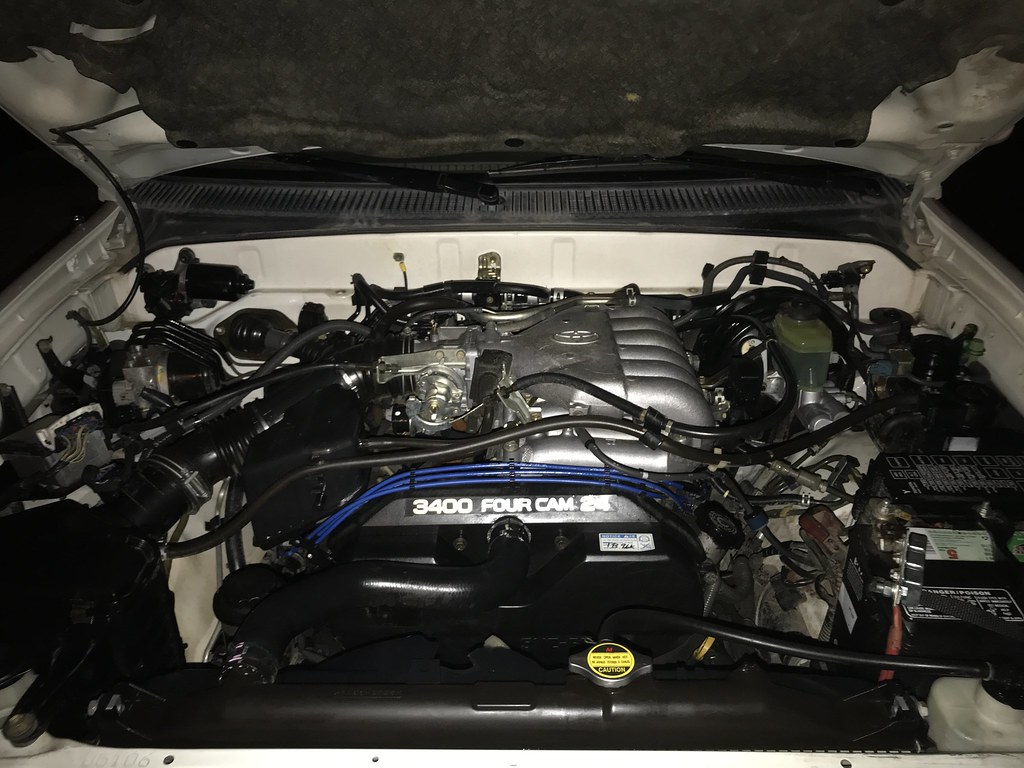

I "detailed" the engine, although it wasn't super dirty. Makes it easier to clean later, as well as work on in the long run.
Engine by keaton.burleson, on Flickr

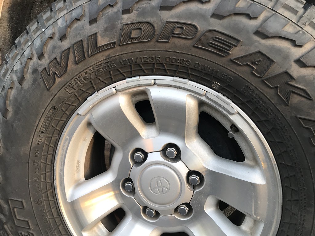

Yeah I figured as much. I don't really like these tires, and the rear two rims have a ton of weight on them, even after being balanced. I'd rather go to a 32" size with a 7" base width. At full articulation they rub a bit too.

Pretty sure something is wrong with the rims I have now, Discount Tire put a ton of weights on the sucker:
IMG_3149 by keaton.burleson, on Flickr
Like, that's ridiculous. Tired of the highway vibes!
