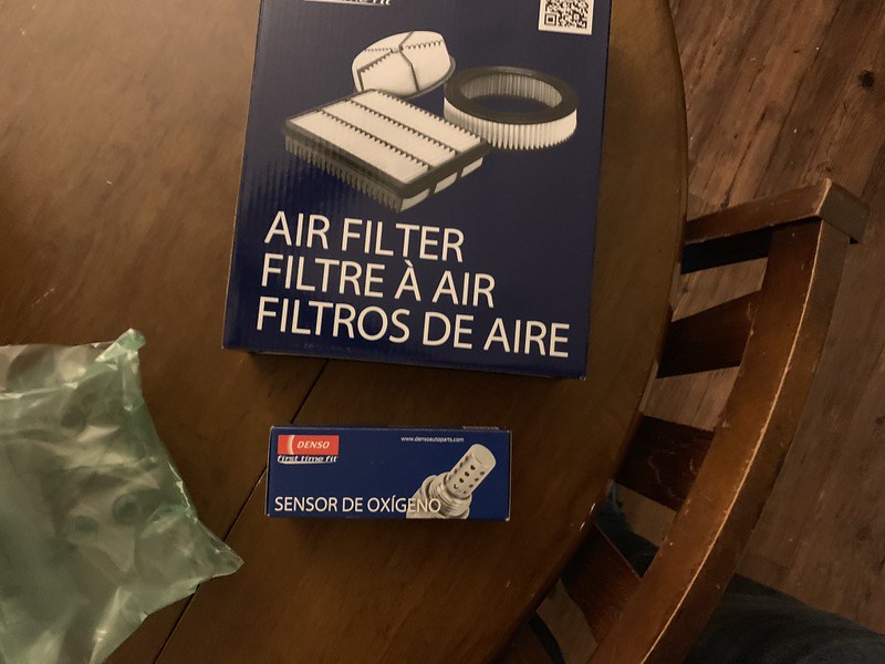

I finally received my air filter and O2 sensor. Doesn't look like the O2 sensor was ever replaced, so I'm happy to take care of that.
New Air Filter and O2 Sensor by keaton.burleson, on Flickr

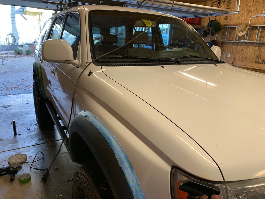

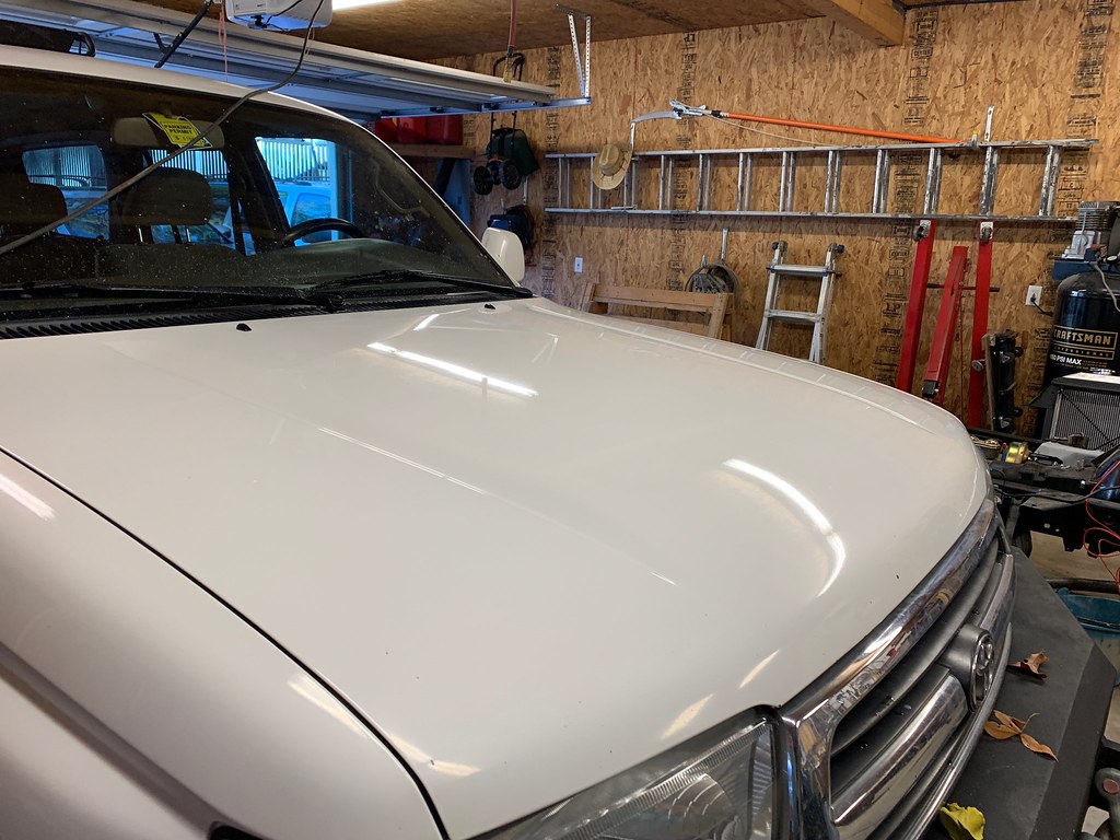

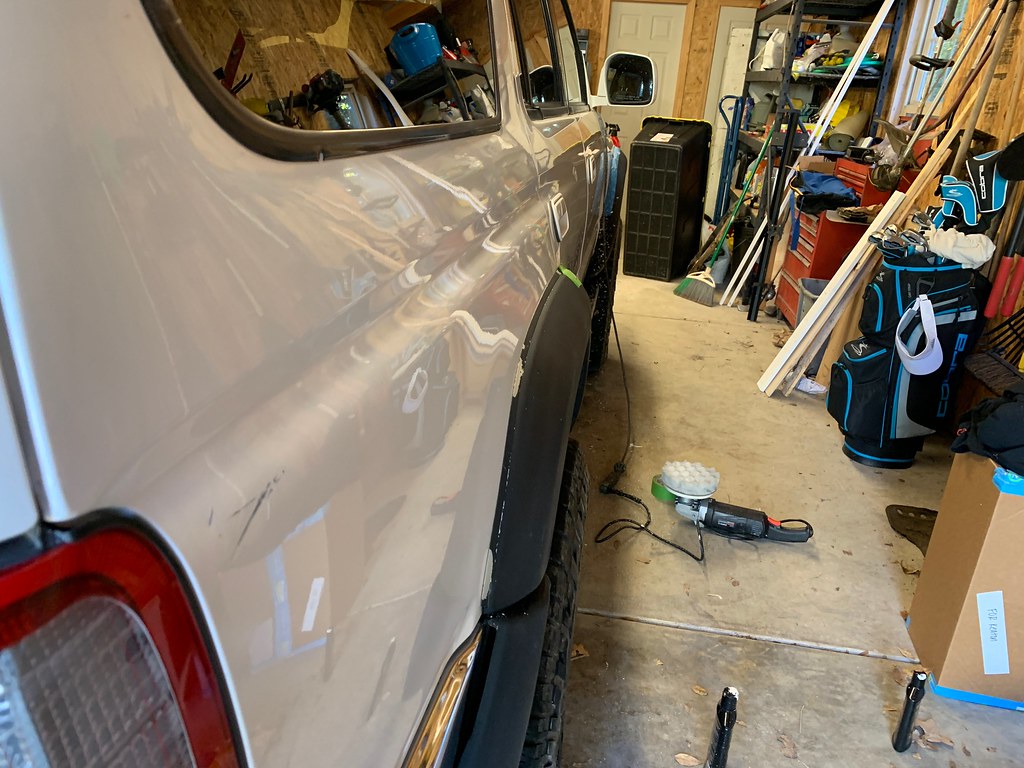

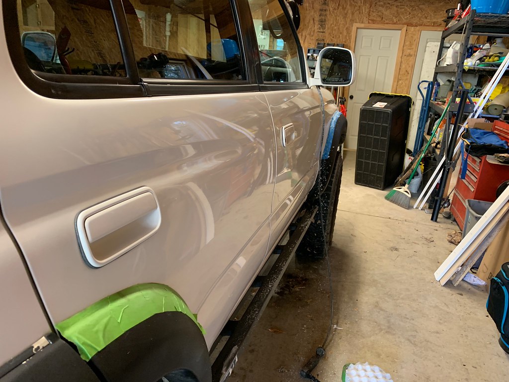

Washed, clayed, and buffed the 4Runner today. Since purchase, the hood and front fenders felt and looked a bit chalky, plus there was a large scratch where I hit a tree branch on a trail down the passenger side. Finally got that taken care of.
Post buffing #1 by keaton.burleson, on Flickr
Post buffing #2 by keaton.burleson, on FlickrMore buffing by keaton.burleson, on Flickr

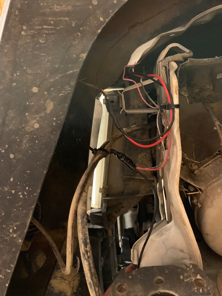

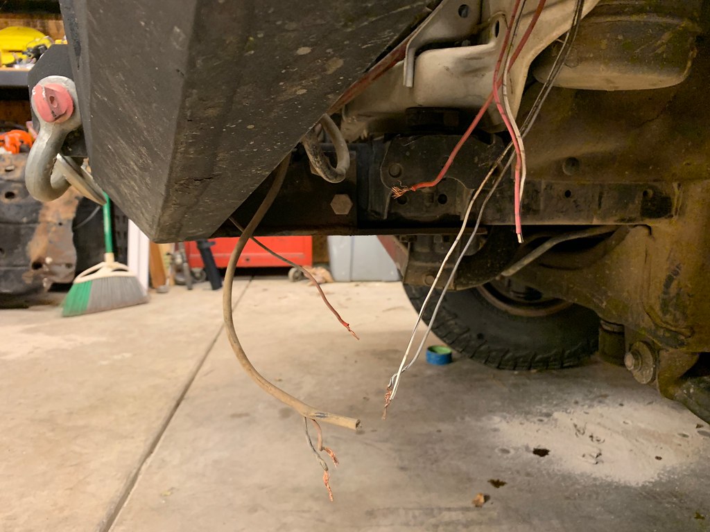

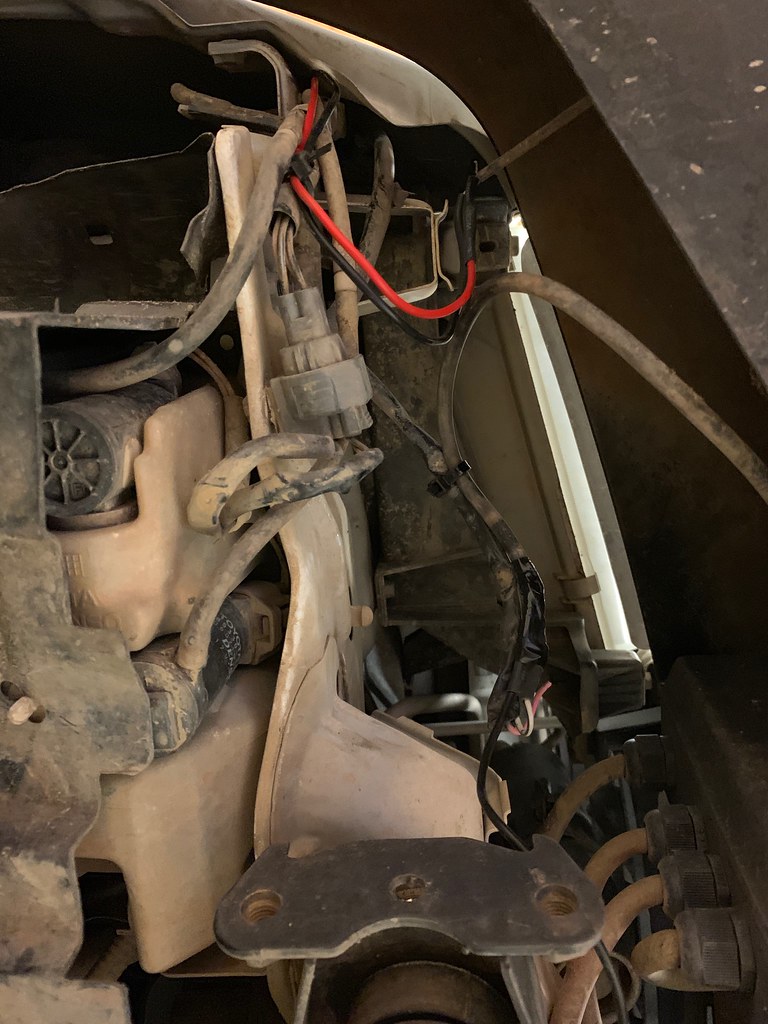

I also redid the front bumper's wiring since the PO used wire nuts (why!!) and tied the light pod's ground to the blinker (why!!). Look at this mess:
Garbage wiring by keaton.burleson, on Flickr
After:
Better wiring #2 by keaton.burleson, on Flickr
Better wiring by keaton.burleson, on Flickr
I realize it does not look a ton better, but I promise, everything was soldered and heat shrunk appropriately. Plus, when everything needs to be ziptied out of the way, it looks funny. When I get a fog light stalk, I'll switch to the fog light's harness. The single wire on both sides tying into the fog light harness is the ground, as it should be done.

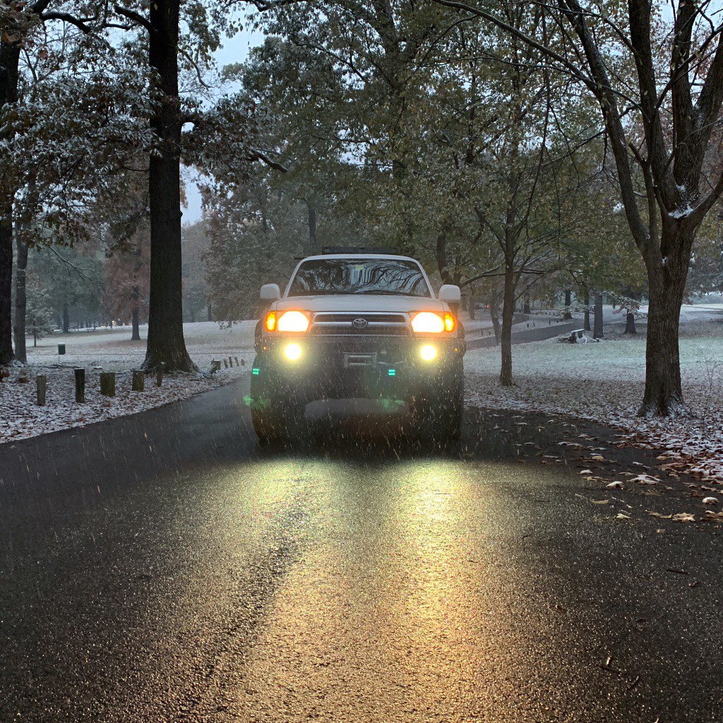

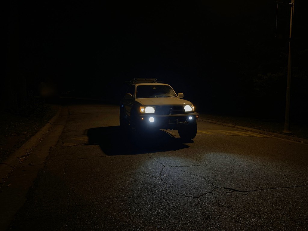

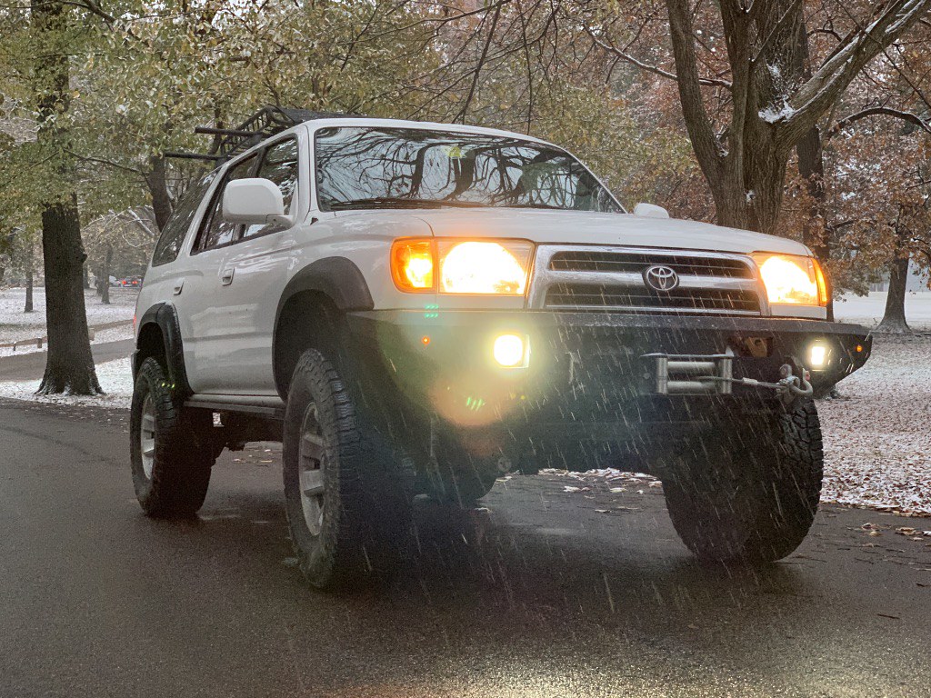

I also swapped the LED blinker's functionality on the front for the amber driving lights up top, since the blinkers sucked on the bumper. Now, it looks killer.
Swapped driving lights/blinker functionality by keaton.burleson, on Flickr
(taken with the hazards on)

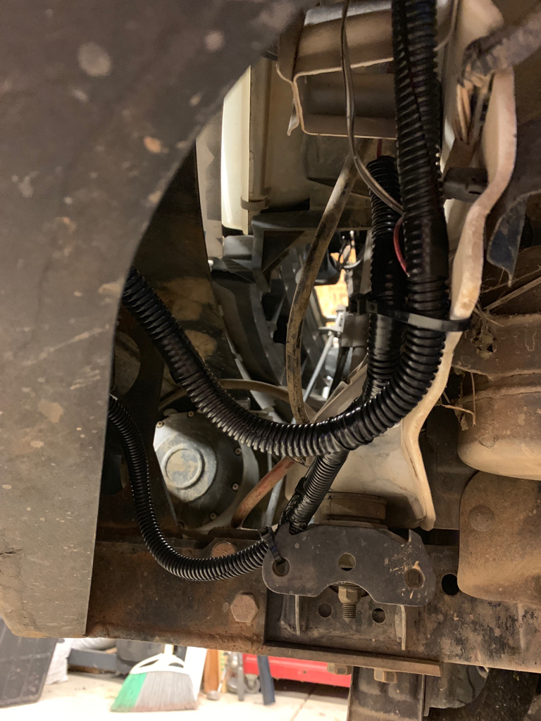

I ended up feeling bad about the bumper wiring again. It just still looked terrible even though it was done correctly
Looks way better with some conduit.

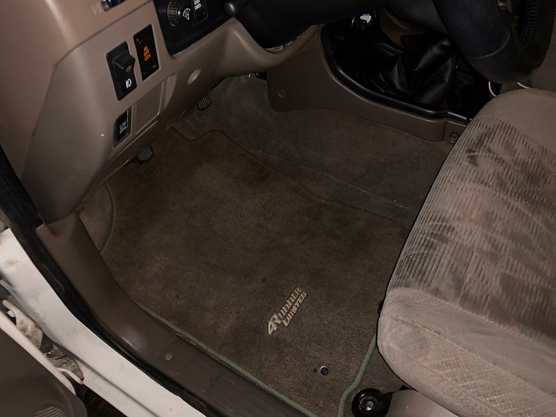

I was able to clean the interior how I wanted it since day one, finally.
