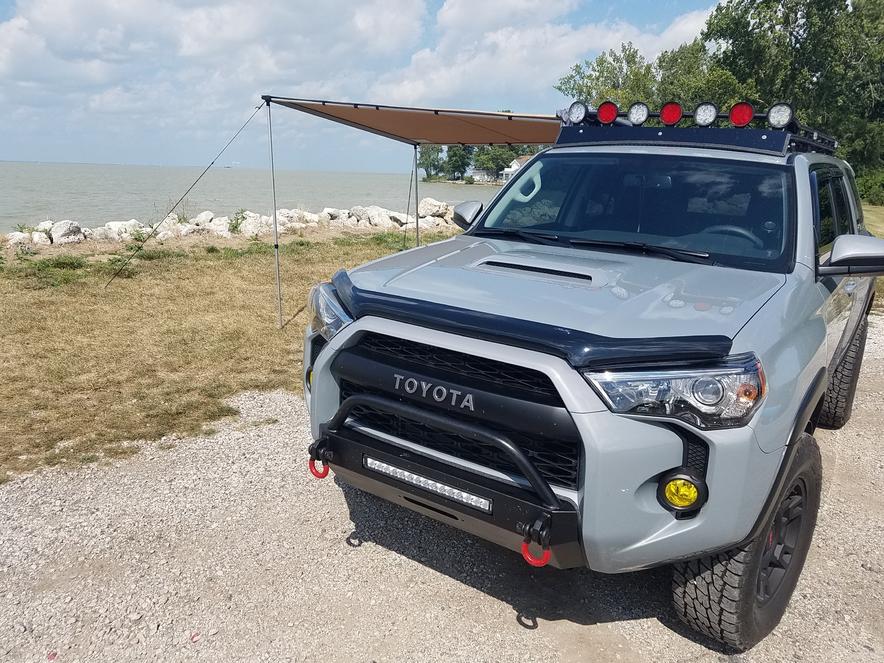

SSO Slimline Bumper - [MENTION=110183]SouthernSS[/MENTION] scored a group buy that closed on 6/29, expected delivery 4-6 weeks... about same time as truck delivery!

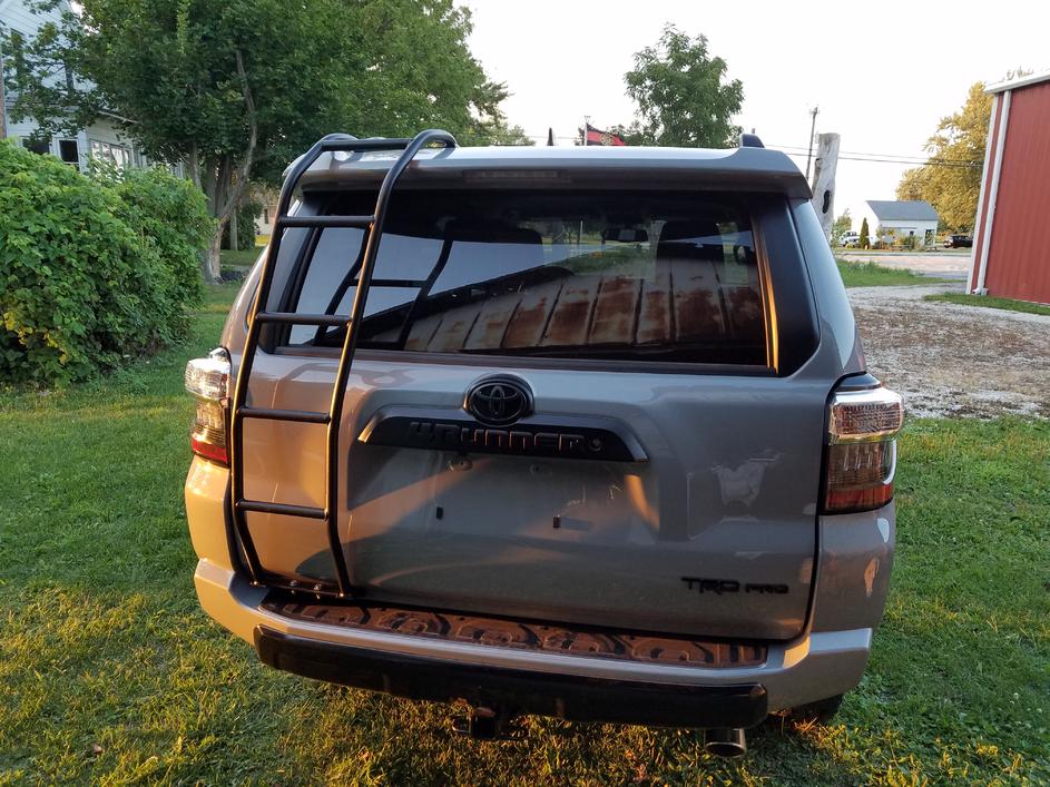

Rear Ladder - Baja, love the offset look better than the straight look - expected delivery...about the same time as truck delivery!

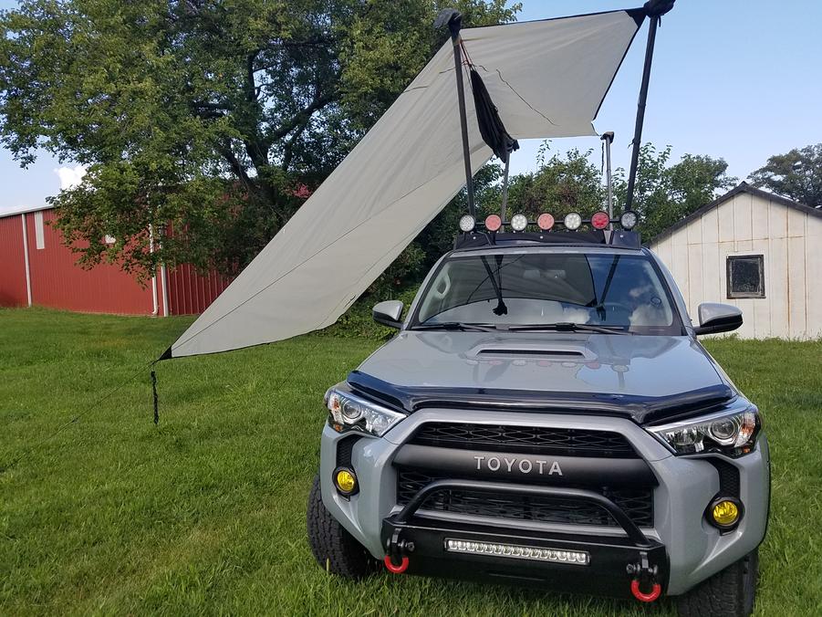

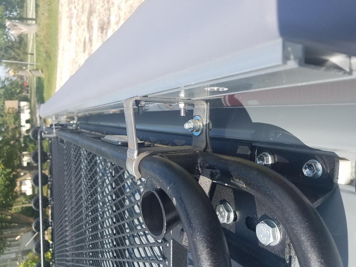

ARB Awning - Shipped - actually, fabbed up some brackets for the Cherokee OEM rails, kinda flimsy but it is temporary. Also picked up a gazebo tent screen addition on sale for $25 and will be sewing the edges to match the T4R once it is up... but is that more of a camping gear or 4Runner mod? eh..

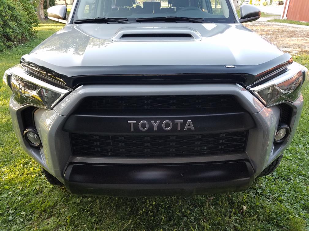

Random Misc. Stuff - Amazon order to include vent visors, hood bug guard, 4Runner Blackout Kit, Yellow Lamin-x for the fog lights, etc.
Plasti Dip - Rattle cans for the fenders, tops of the mirrors, hood scoop and front TOYOTA emblem.

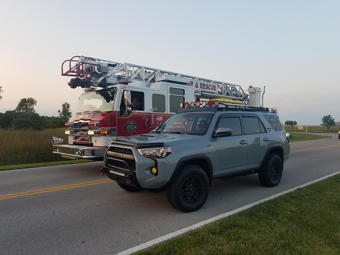

Emergency Lighting/Siren System - As a Volunteer Firefighter/EMT we run 360 deg red/white lights while responding to the station. See this thread for the planning and progress on this set-up

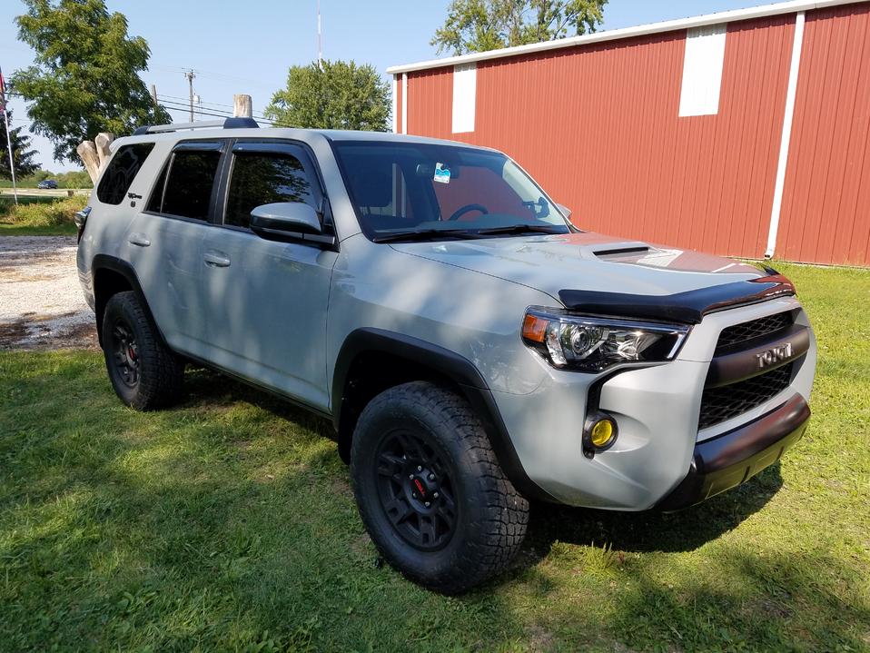

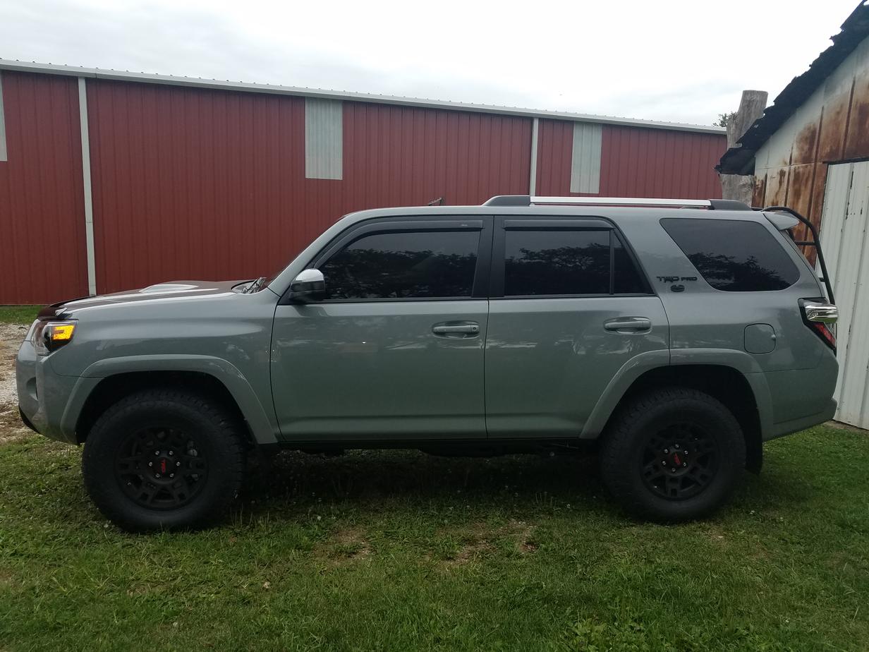

And the wait is over... Okay, technically it was over a week ago but I was out in Colorado hiking 14ers and watching quite literally hundreds and hundreds of 4Runners and Tacos buzz all around the mile high city and well out into the western reaches. Funny observation, the really decked out trimmed up and loaded down rigs...like what I am about to do on mine, are all crawling around the city with their Hi-Lift jacks at the ready while the rigs out in the mountains at elevation and into the valleys are pretty well stock, but dirty as all get-out.
Oh well...
The bottom photo is the one I have been waiting to take for a long time... I call it "Oh, Christmas Tree, Oh, Christmas Tree..."
The only thing that did not make the deadline for the photo op was the SSO Slimline (Fabbed this week, scheduled to arrive Monday) and the Spidertrax (late order, should be here by end of day tomorrow)

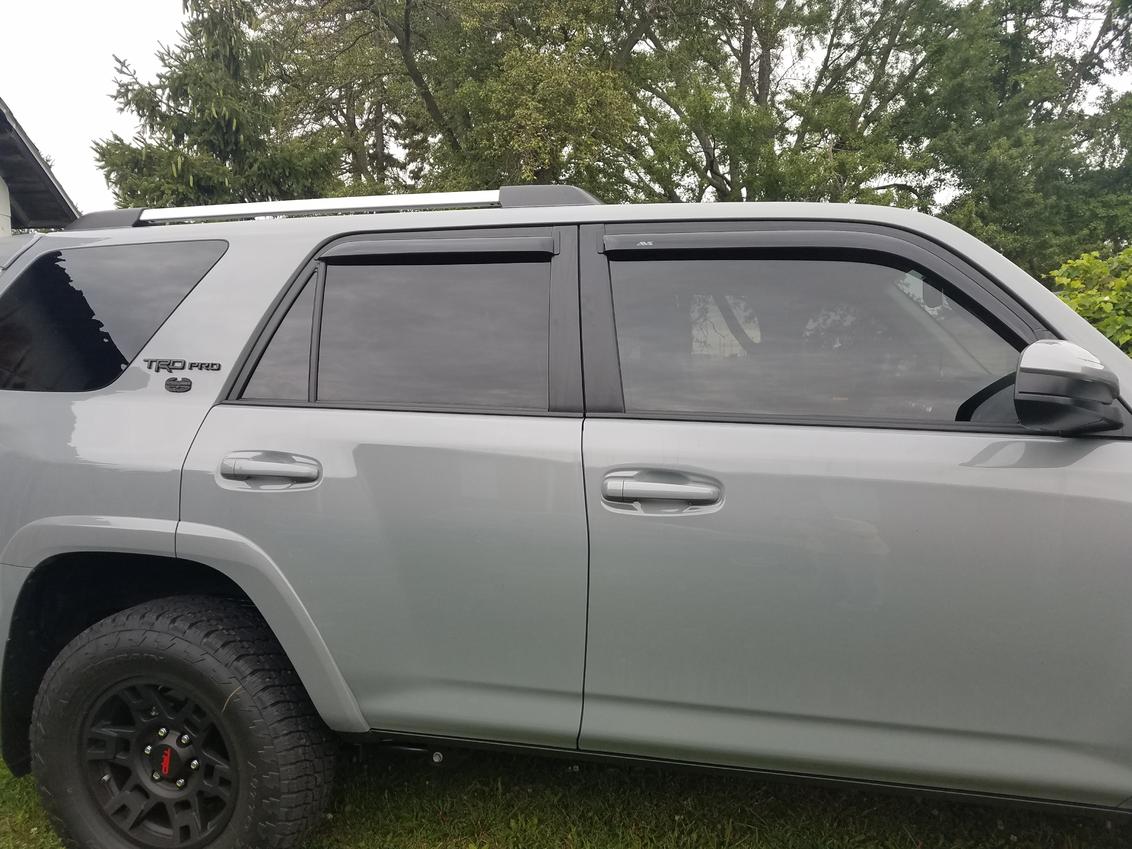

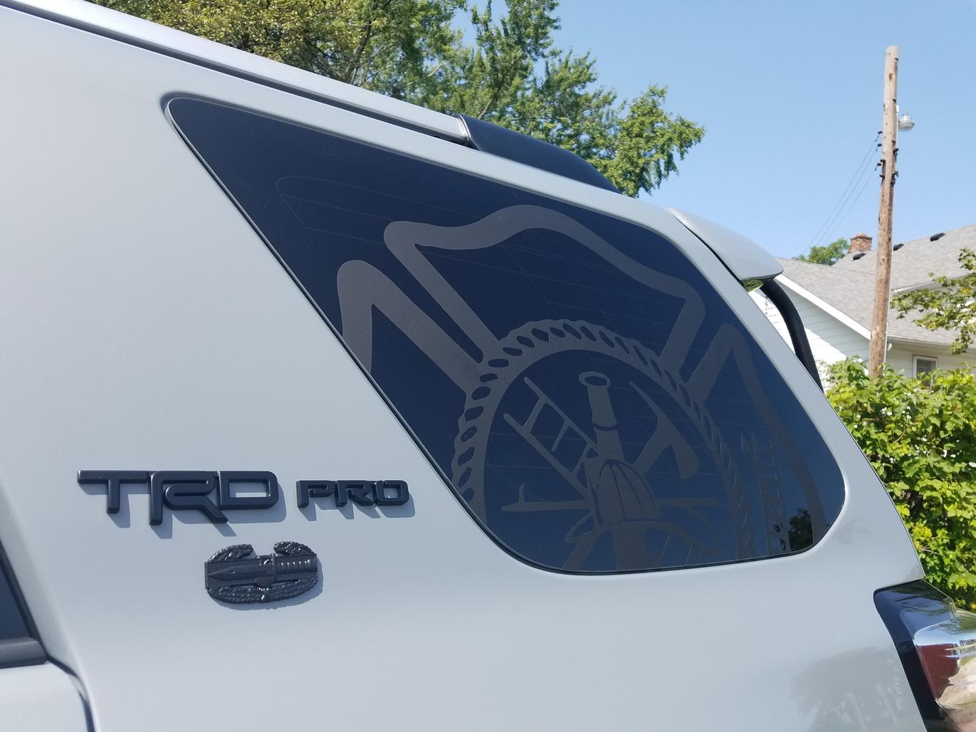

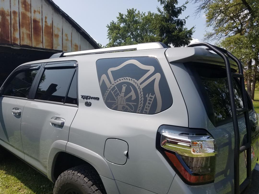

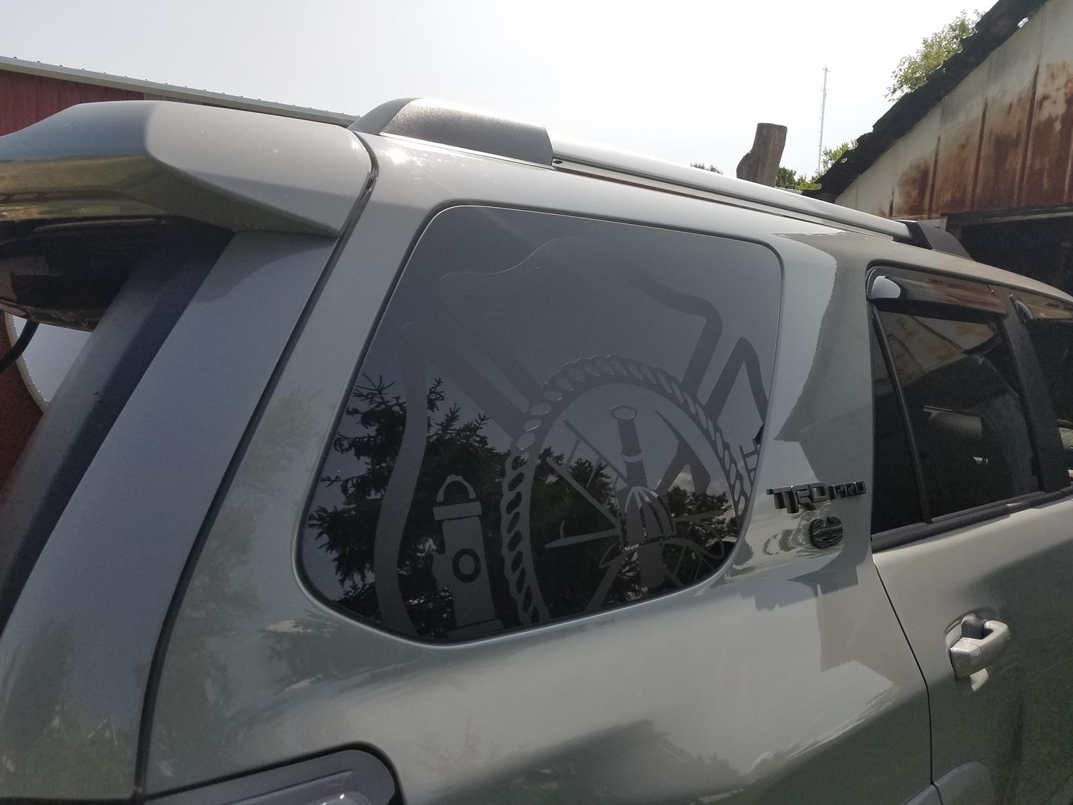

Window Tint - Local Shop, $180 out the door for all 7 windows (3 each side and the rear) 20% film all the way around so the rear 5 are ~5% "limo" now...I am really happy now, pretty sure the windows are just supposed to look this way.

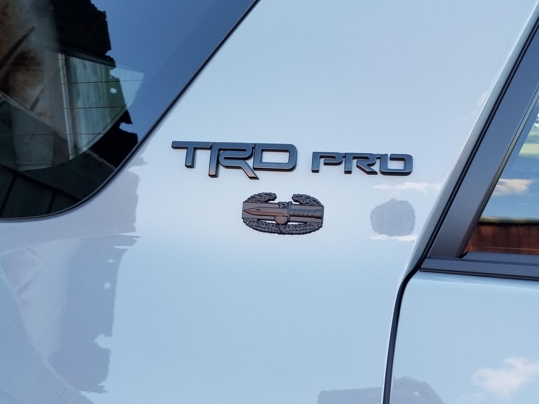

Custom Maltese Cross from [MENTION=167461]overlookgraphics[/MENTION] Great experience working with this group. I like the flags you all have but wanted something different. If you want to run the same design order a 26"x26" cross for a 5th gen window.

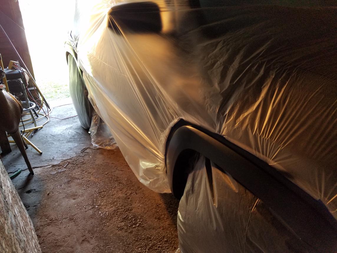

Okay, this was my first time going "big" with Plastidip. My garage space is very limited and I had to do the entire job while the kids were at school. It is not professional but heck, I am only out two cans and 50' of a roll of painters sheeting so 4 hours and $20... yeah, I am happy and I now know exactly what the matt black fenders look like on Cement before I spend real money on a pro job. I must say, I am pleased.
I would never have done this on my own until I saw it on the forum elsewhere, but hey, where else am I going to put all these things haha

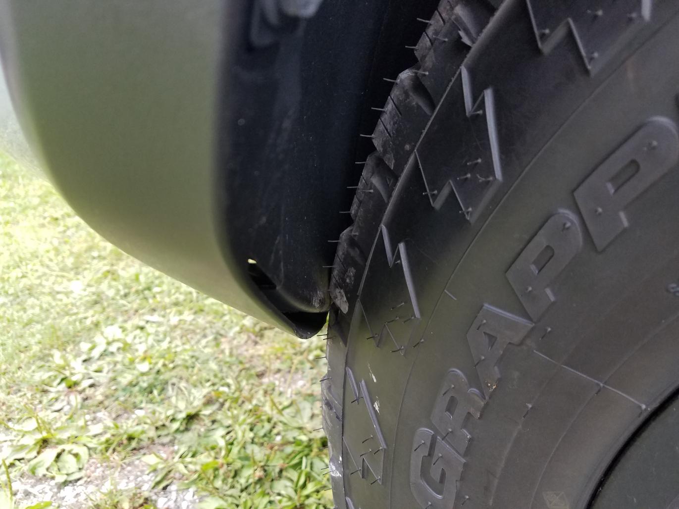

Spidertrax 1 1/4" Spacers - I like the looks and wish there was a legitimate reason to do this other than the good looks... maybe a wider stance to compensate for the higher COG when the roof rack is installed and loaded up??? I'll go with it!
Update on Spidertrax after 50 miles... Tire rub on hard over turns... now the $200 question, trim or remove... to be continued
Update on the Update after 200 more miles...more importantly, after the Slimline Install. I was able to "push" the plastic forward when I put the front back together... no more rubbing!

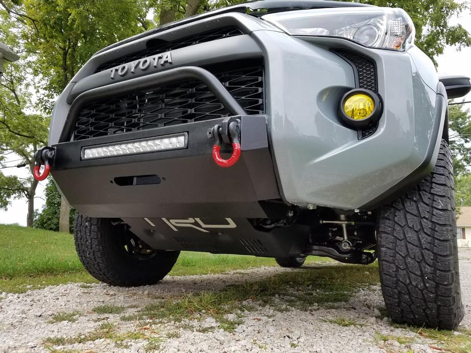

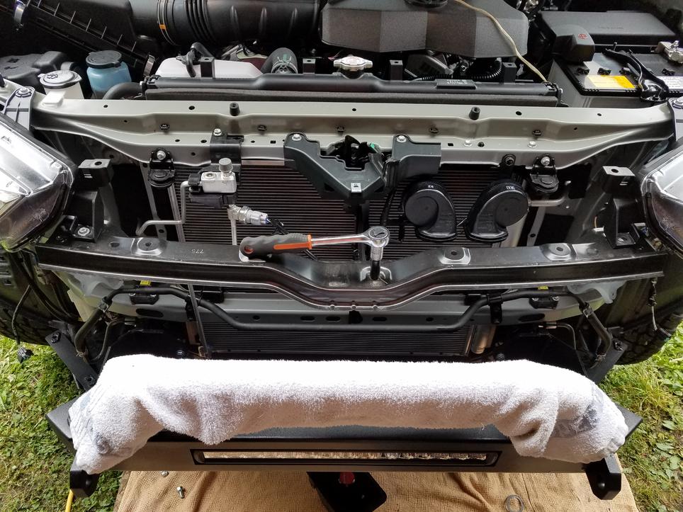

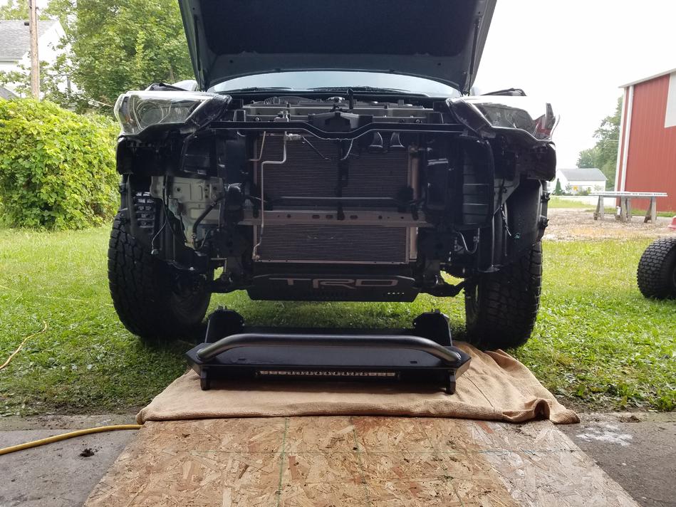

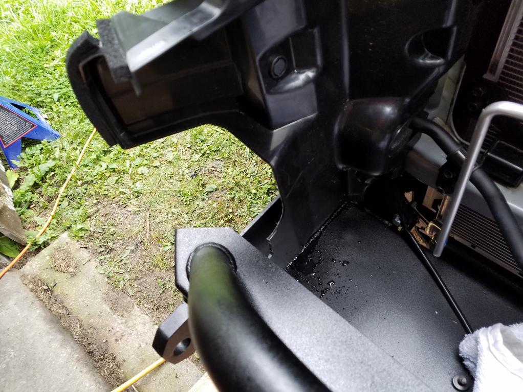

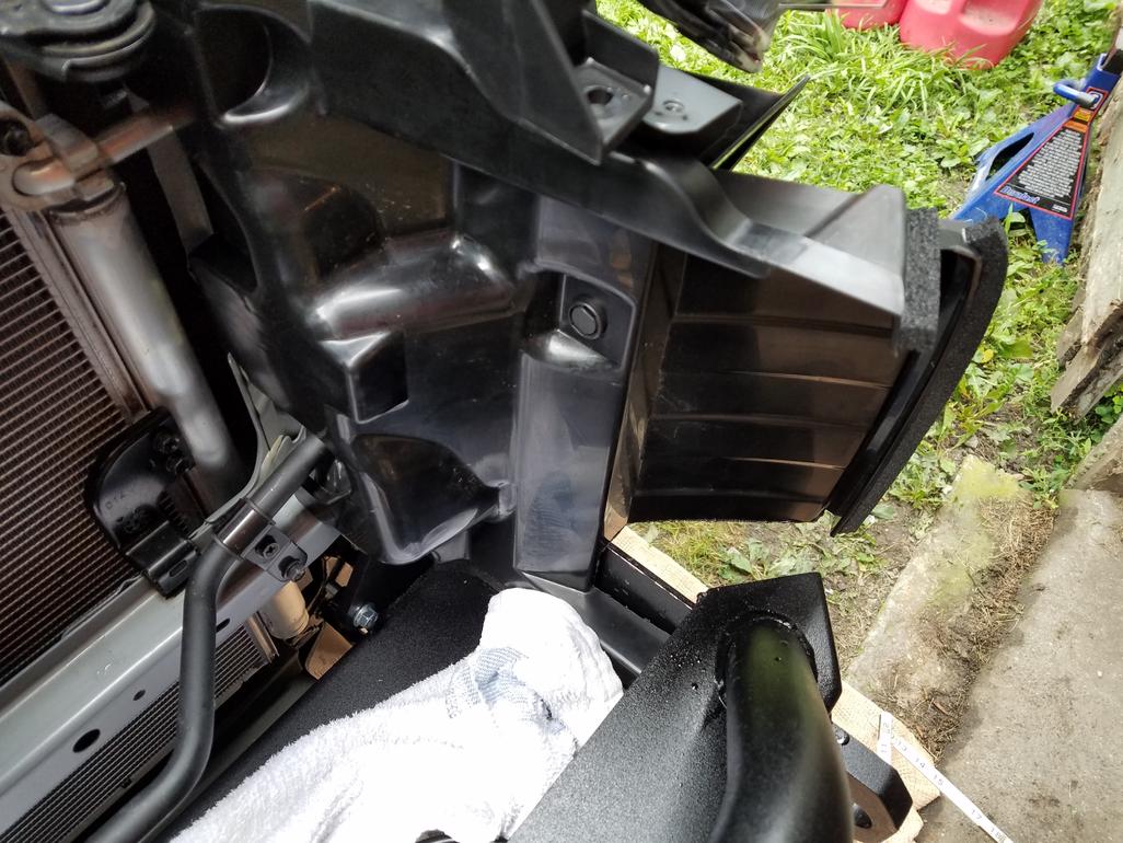

SSO Slimline Installed 8/29/17
A little prep work for the install today... Rust-oleum Undercoating
Won't go heavy on pictures as there are so many others covering SSO Installs. What I did do different though is spend a little extra time trimming the air dam plastic to reinstall it. I also mounted the speaker for my Fire Department Siren next to the driver side fog lamp... forgot to grab a picture of that so I am sure someday someone will ask.
Had to take the cross bar out to get the plastic sides back in, have not seen this in any other instructions so here's a picture

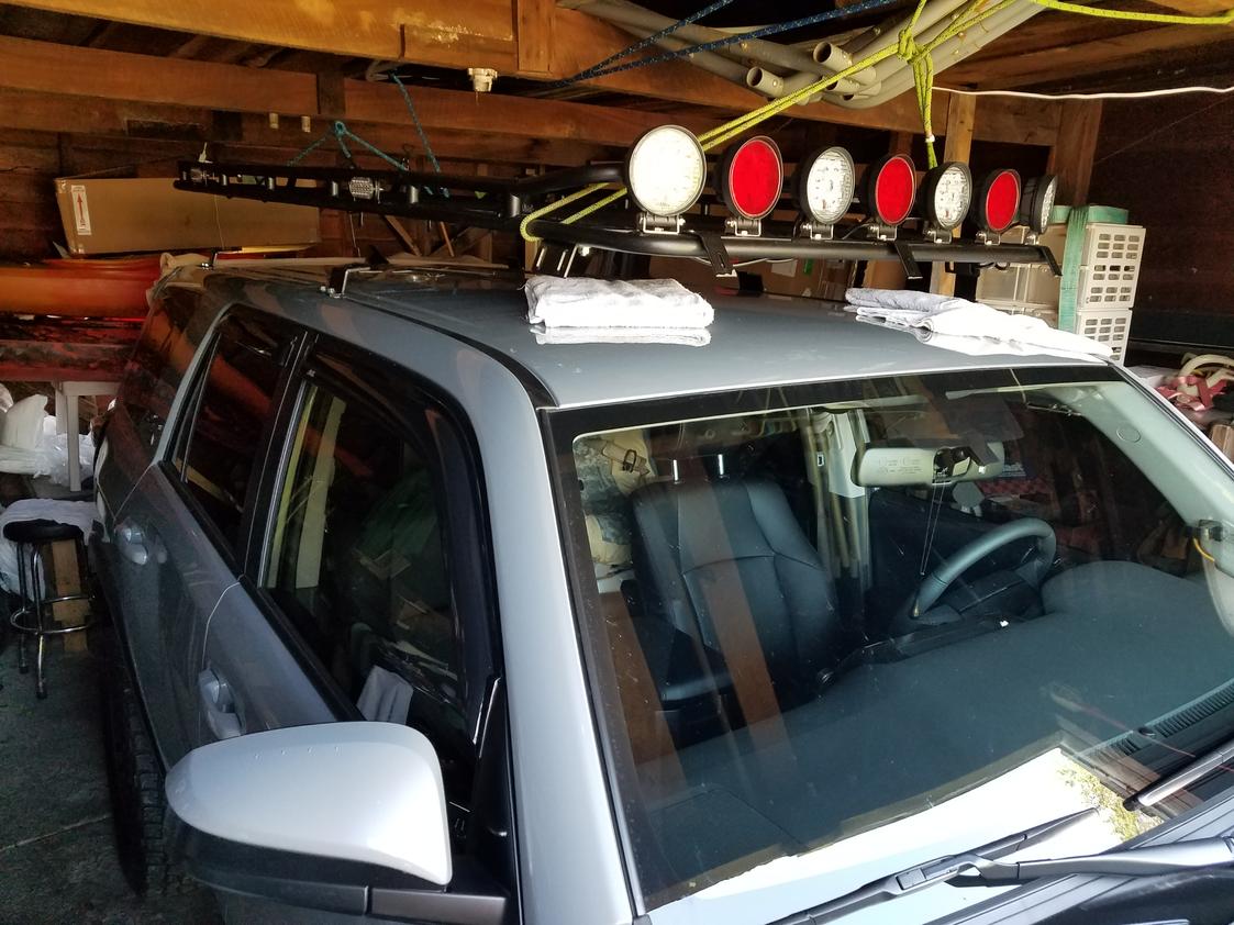

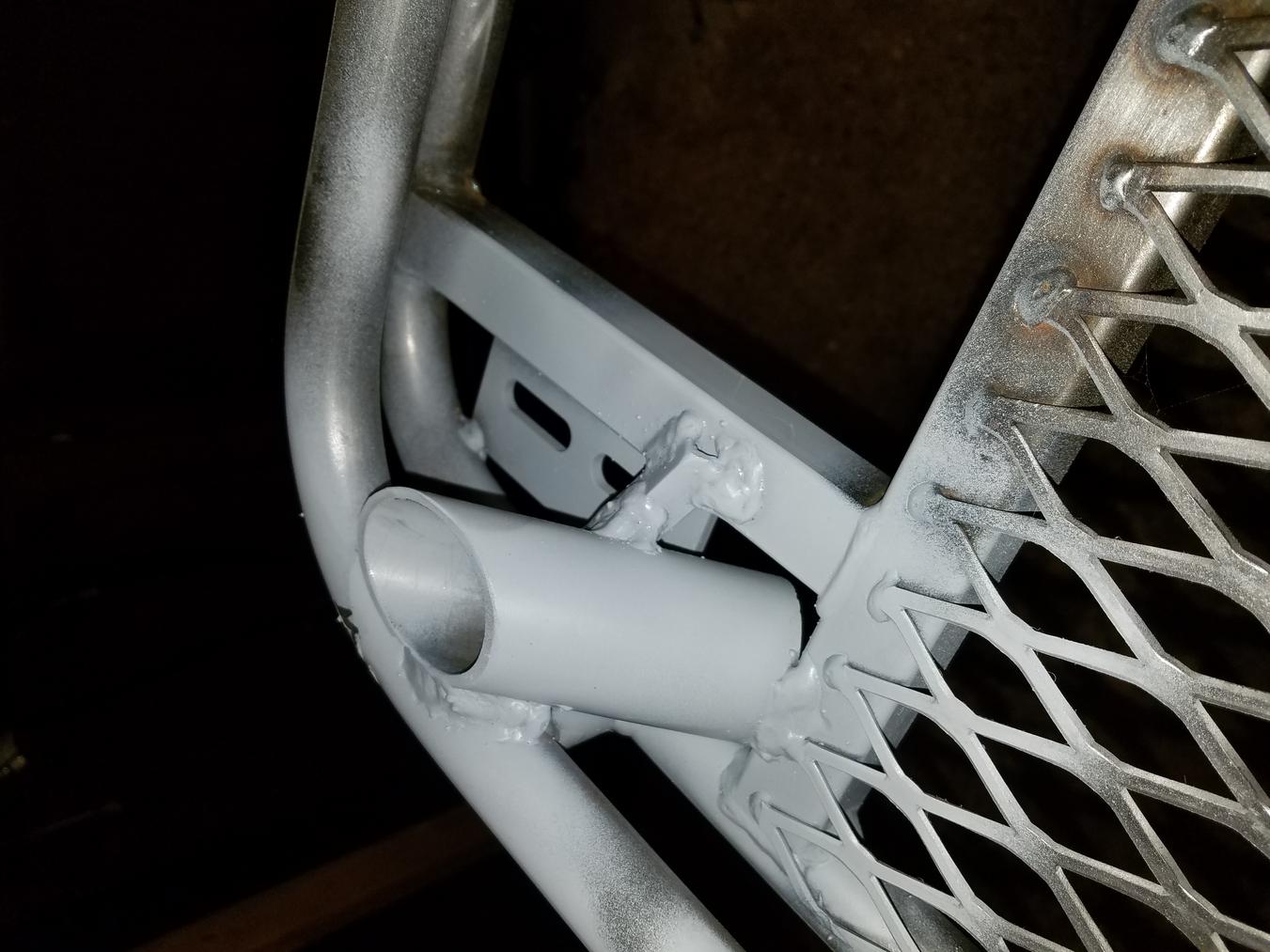

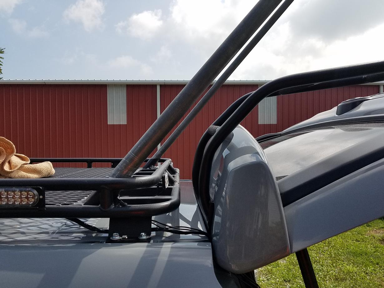

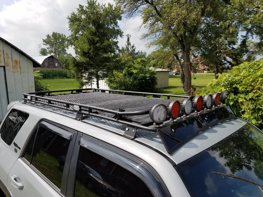

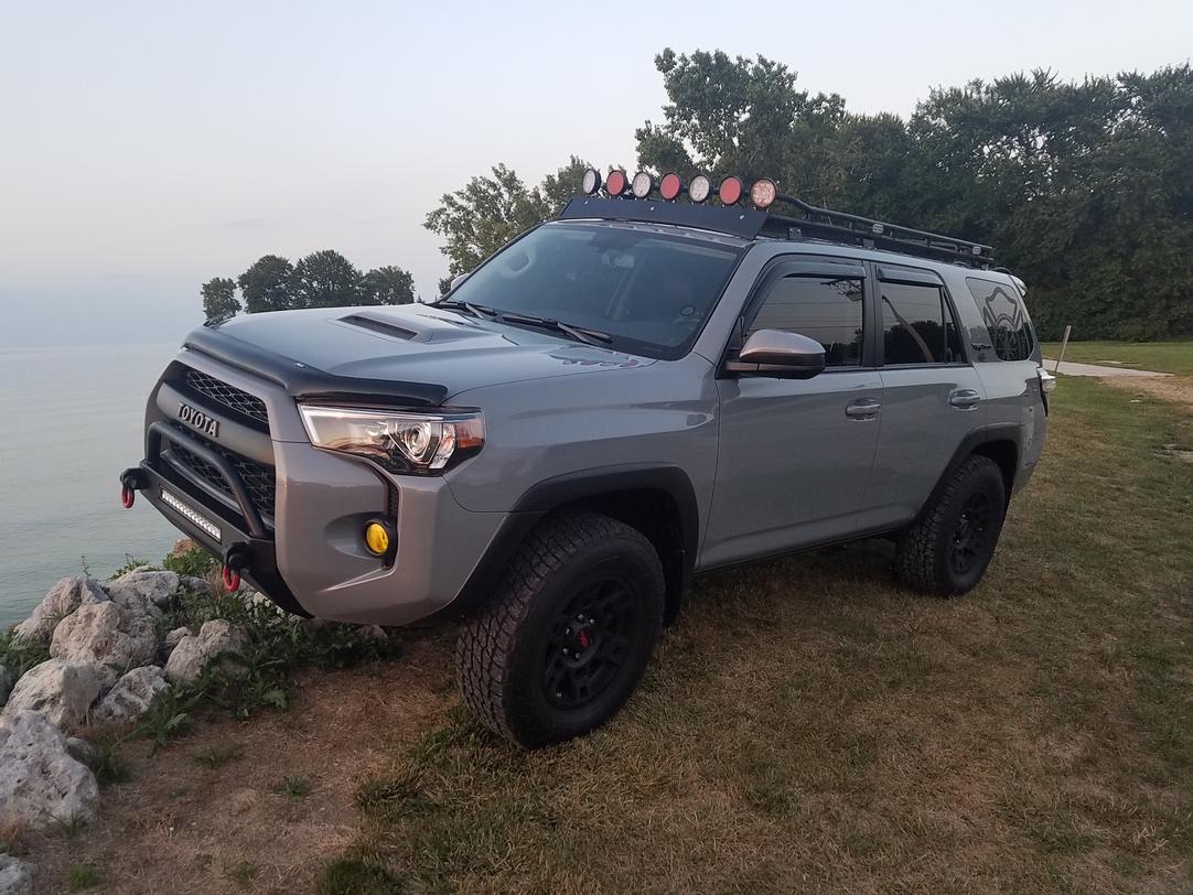

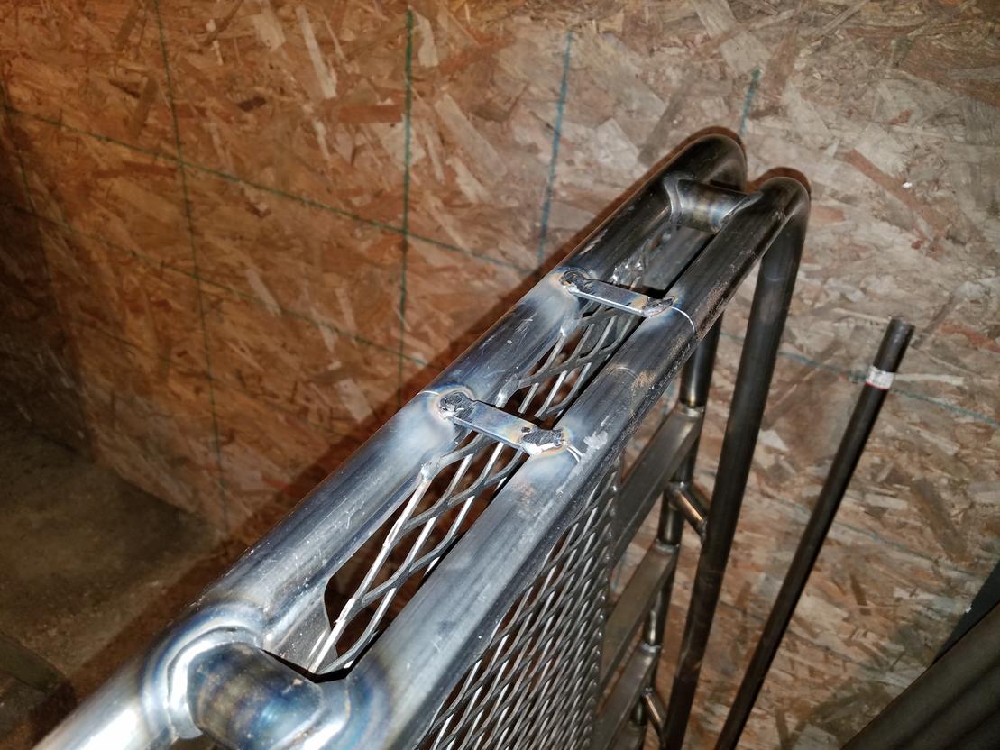

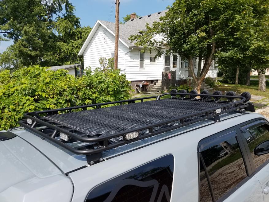

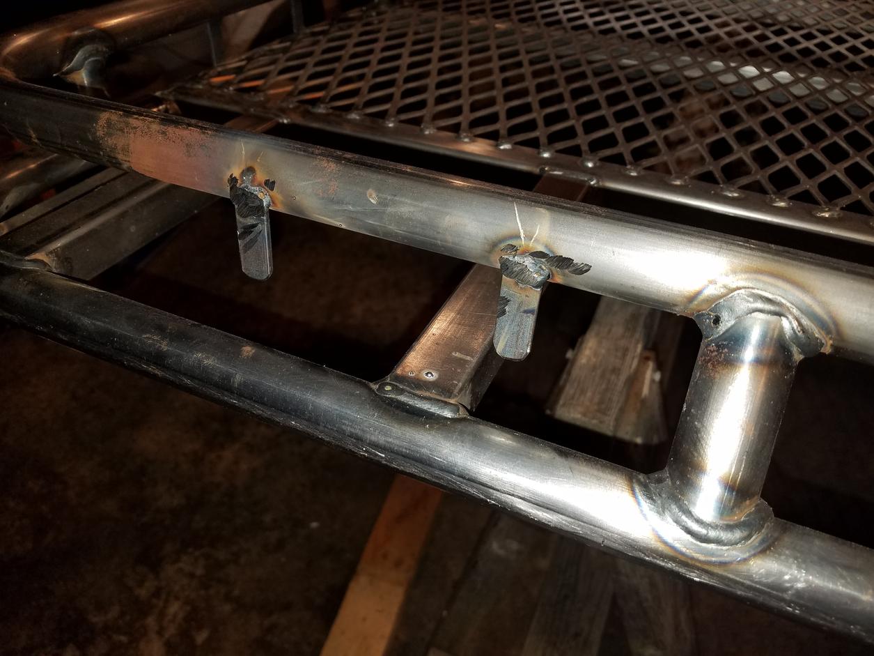

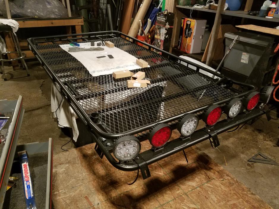

Roof Rack Install
Okay, first things first, the rack is a custom build from Joe at Outgear Solutions, he his on Instagram. Currently (and probably indefinitely) he is not fabricating any more roof racks. He is however doing quality sliders and custom bumpers, and on your dime ships, but is located out of SoCal so pick up is always an option.

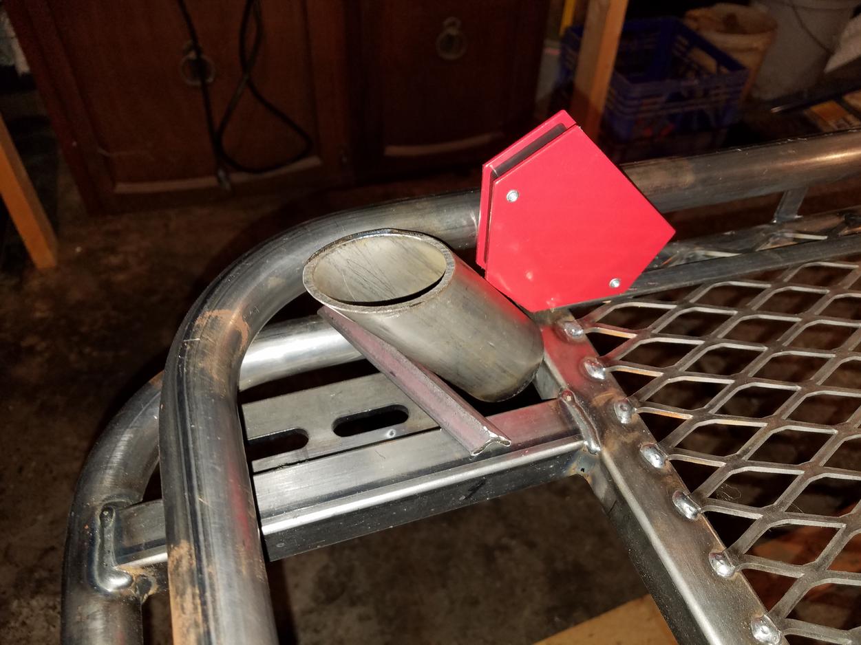

All right, so the rack is very close to a GOBI Stealth and because I am mounting my Fire Department Lights, and Custom Roof Top Hammock from it I had it sent without powder coating so I could break out the inherited Clark MIG welder and finish up the custom work on my own time and dime. (admittedly I am not a "welder" so my lines are far from perfect but they are thick haha)

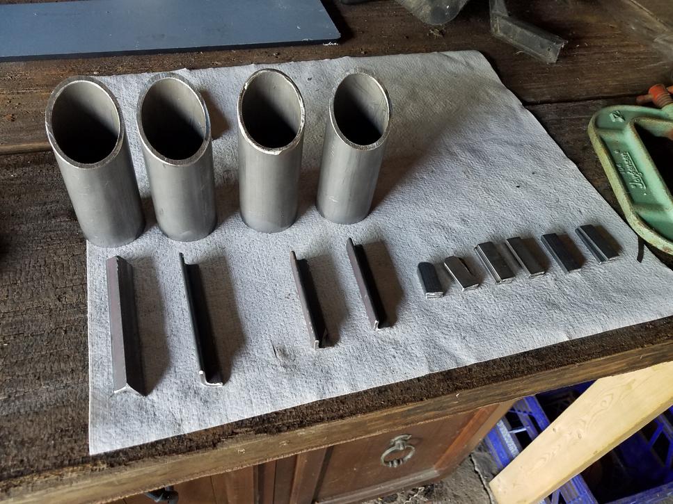

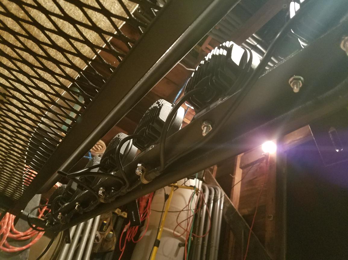

Drilled Holes, previewed lights;
Fabbed up the needed parts;
Welding them into place;
Very cool, and looks good. Thanks for posting links to some of the products. This gives me some ideas for my '18 that is on the way.

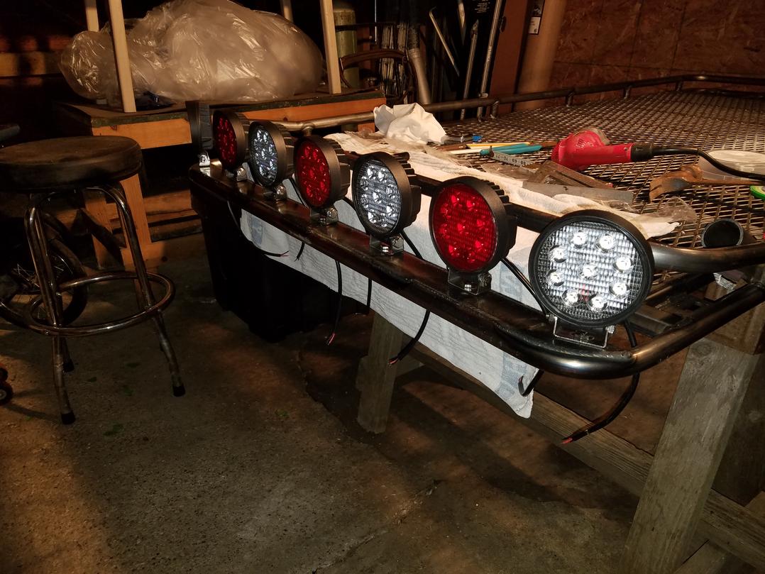

Roof Rack Install Part Two...
Rust-Oleum Truck Bed Coating;
[not sure why but these pictures are not uploading, just imagine black looking flaked spray paint on expanded metal roof rack]
Mounted all the lights and wired them up to desired settings;
Hung the rack up from the ceiling, backed up into it for the solo mount... boy I thought the garage was small when I did the fenders, this was tight!
After tweaking, tightening down and cleaning up here is is all mounted;

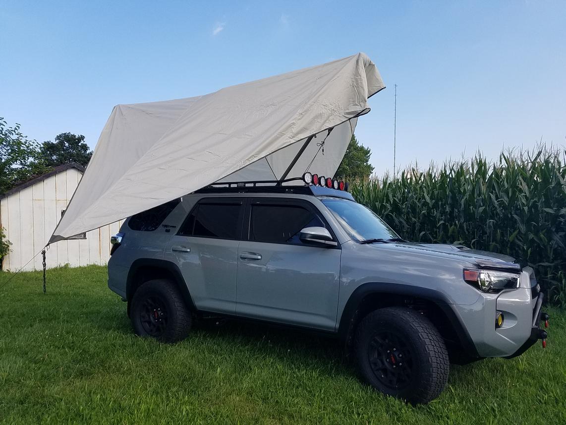

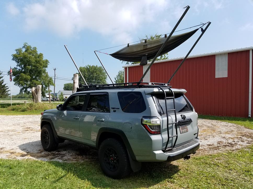

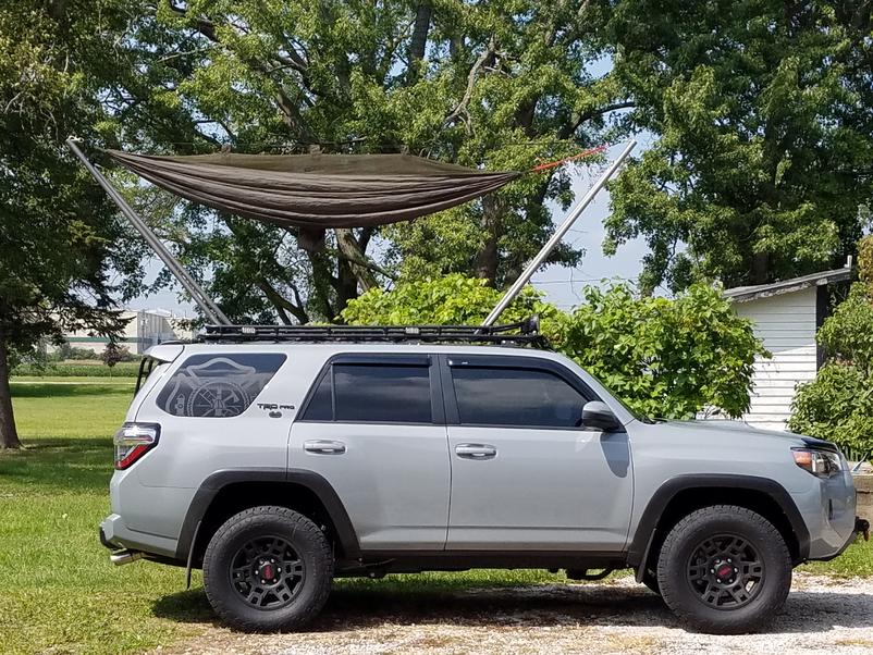

And the Roof Top Hammock
Here are some images, I will add to this as the adventure pictures camping sites get prettier than my driveway!

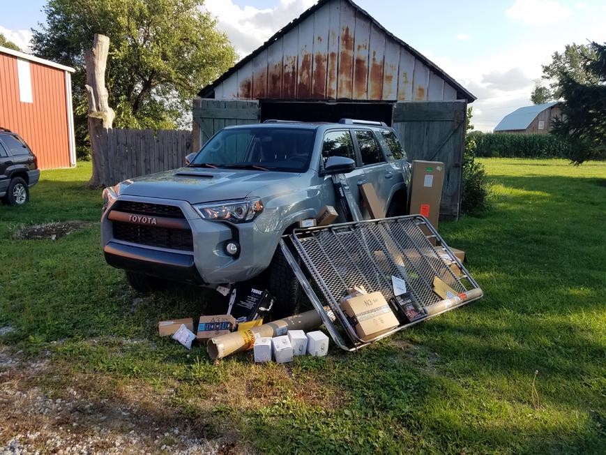

That Christmas pile..is awesome :reddance:
Thanks guys, it has been a really fun time digging into all the boxes and playing with everything.

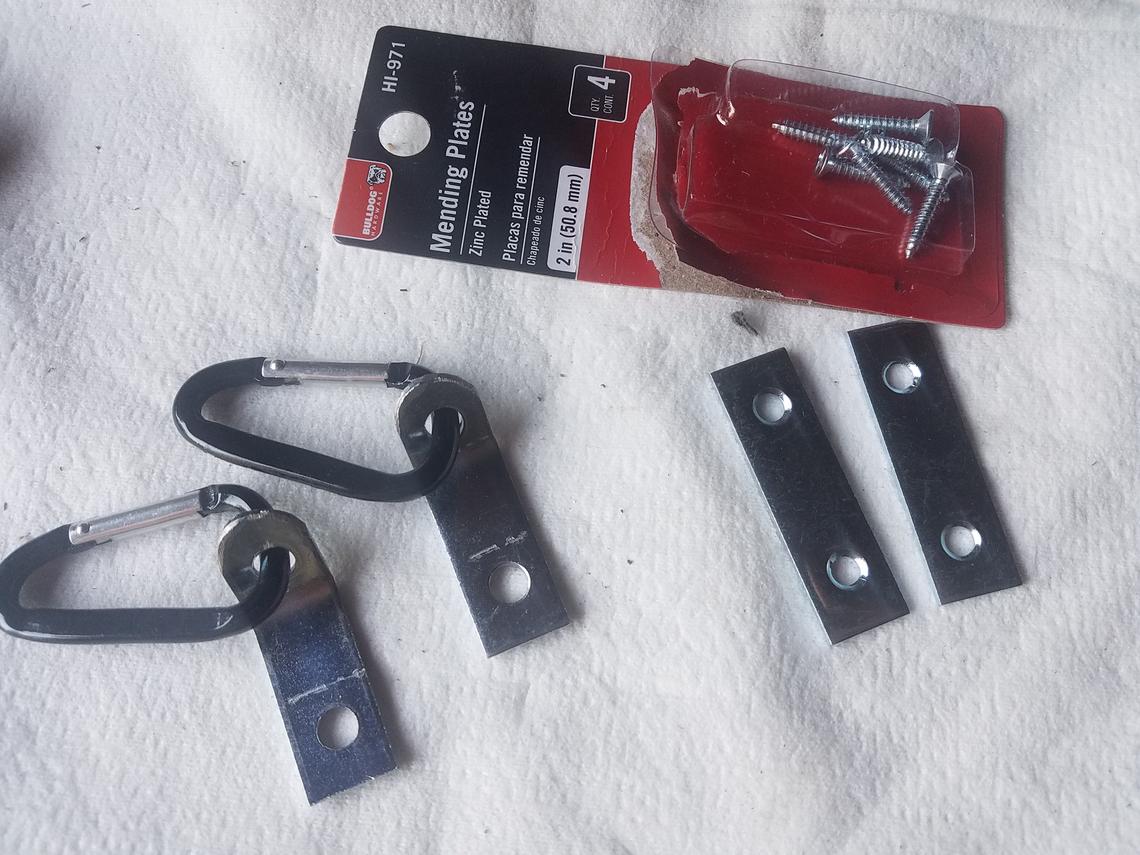

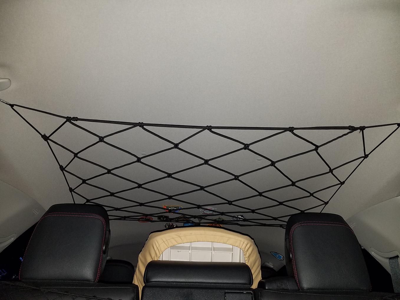

Attic Space!

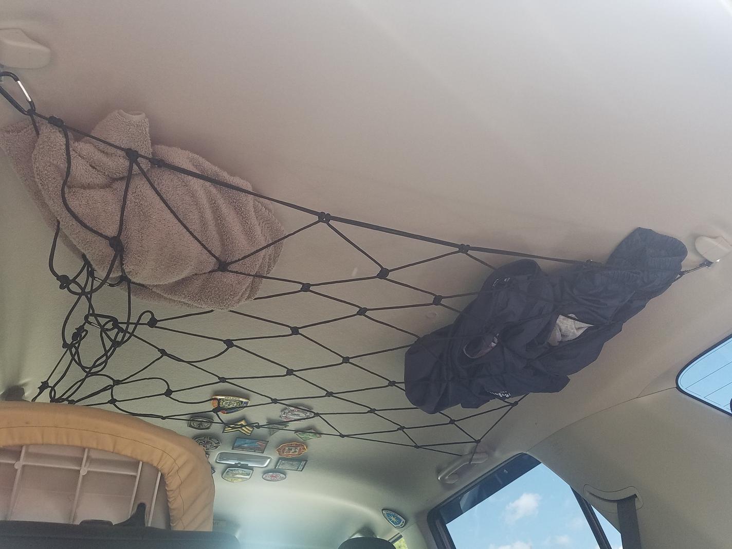

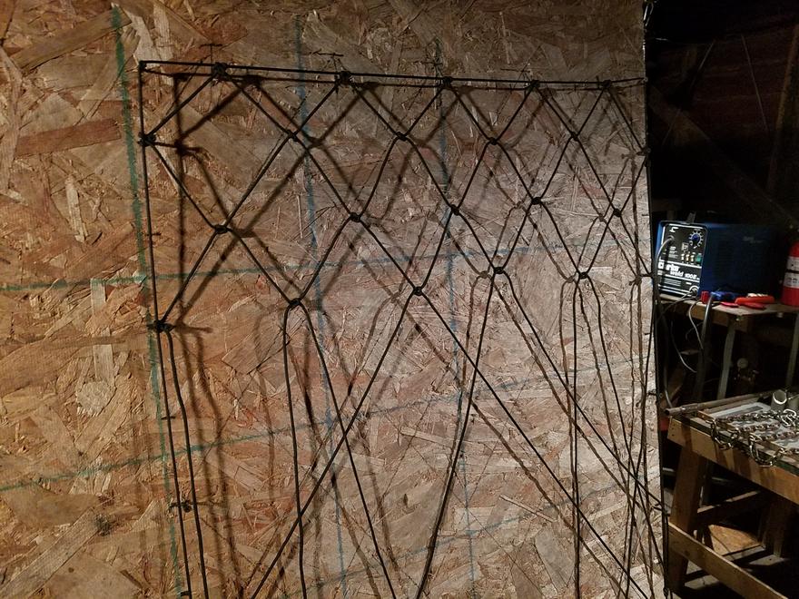

Round 1; I am either getting really cheap or really fiscally responsible. Rather than track down $24 worth of FJ Cruiser D rings like others have done I modified $2 worth of Wal-Mart brackets and used 72' of 550 cord to tie up the net. I knew the spacing across the truck was 40" and front to back was 32" so I gave it my best effort to tie it up but after the install it is really loose. just a jacket and towel sag it down way too much for what I expected so I think it will take a campfire night with time to spend to retie the system much tighter. If it does not work out at least I know I tried.
Edit: 10/13/17 Round two...
Finally pulled the net out and built a jig on a piece of plywood. To get technical for a minute, the outside measurements are a rhombus that measures 40" side to side in the back and 37 1/2" side to side in front with the parallel sides 30 1/2" apart, at least from the anchor points I have set up.
Much happier with the results.
(There is a little sneak peak at my next modification/fabrication in the background with those chains ;-) )

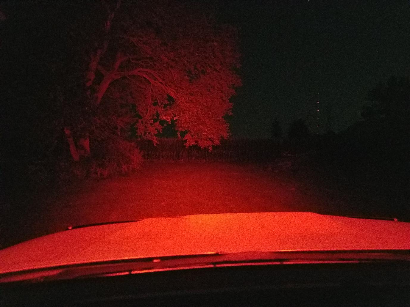

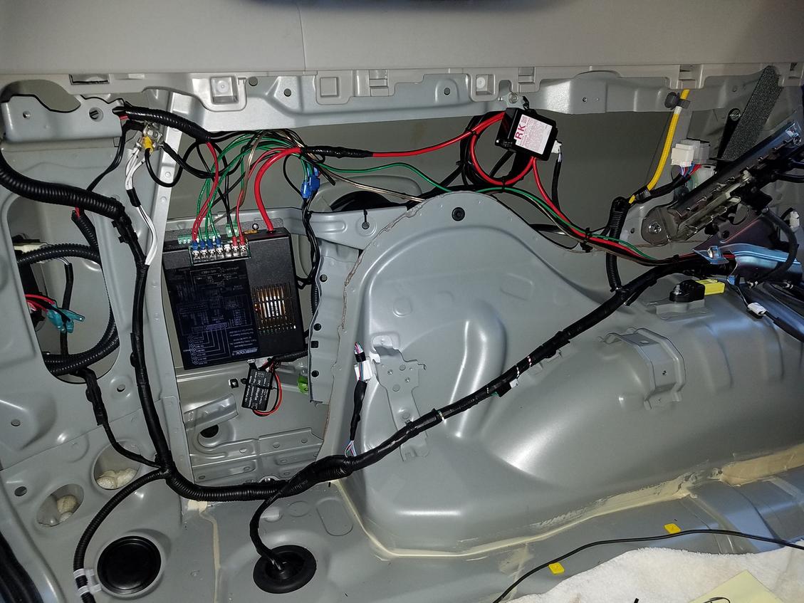

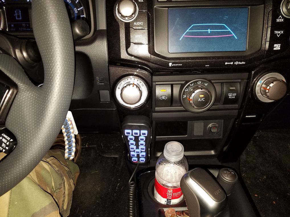

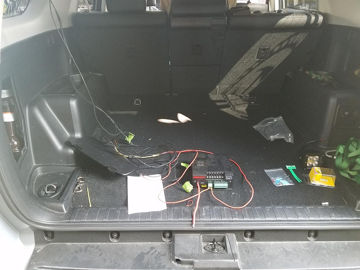

Okay, Today was the day to get electric hooked up, and I was not quite ready to commit...
But I ended up tearing all the way into it and making a full blown project out of this today.
Code 3 Covert Light and Siren box installed.
~Emergency lights include 6 R/W flashers side and rear, Front 3 Red and Two middle White on a wig-wag circut
~Aux 1 - Front pair white
~Aux 2 - Outside pair ditch lights
~Aux 3 - Three Red... you know, just in case the Apocalypse happens and I need my NVG assist lights... or just because its cool!
~Aux 4 - Rear Cube Lights*
~Multiple Siren Options
~Speaker PA
~"Air Horn"
*Rear cubes were the 25+ member bonus from [MENTION=110183]SouthernSS[/MENTION] (Thank you!) on the Slimline GB. I put a pair of Hot/Ground wires coiled in the back panel of the plastic so that I can make them into moveable, disconnectable, hang anywhereable lights (like under my awning or up on the roof when I am hammocking!) ((I will make another post when this one happens since I am pretty excited about this option))

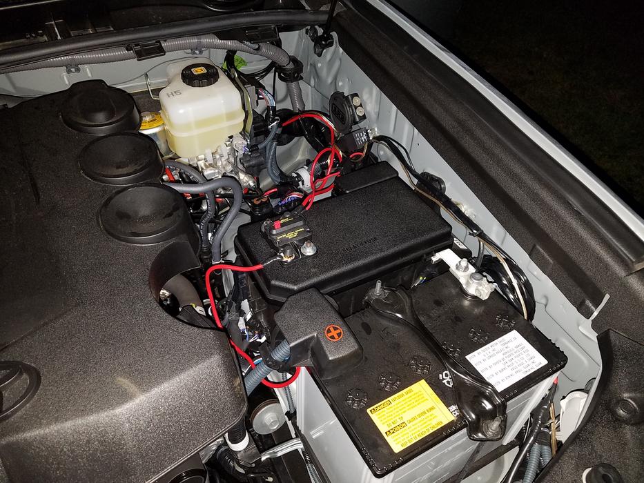

While under the hood installed a thermal fuse block on top of the fuse panel for a hot thief.
Installed relay and wiring for the 20" Rigid in the SSO
Ran a spare 10g wire for future use as needed
Mounted the ARB breather ports, gonna get after that either tomorrow or after I need it

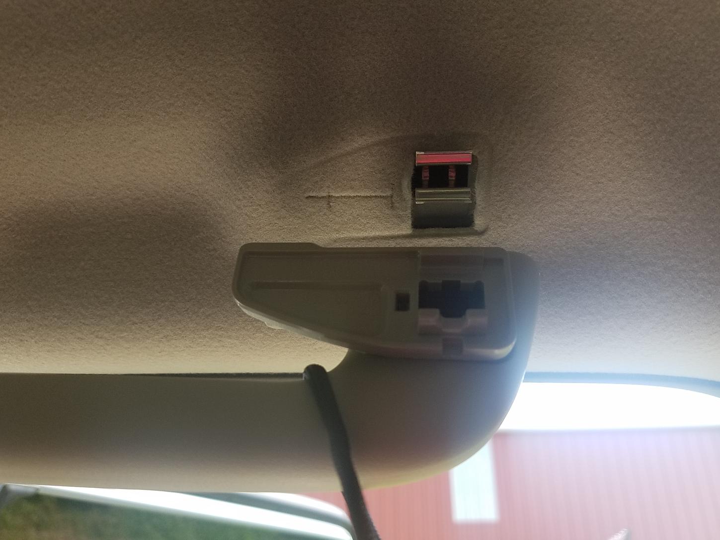

I did not grab a picture of it but the lightbar switch was far from a plug and play into the switch plate so I had to do some serious dremel work so I decided to add another switch blank while the tools were out. I will grab a pic later. they are on the left of the steering wheel.
(Oh yeah, forgot to mention a week or so ago I tossed the anytime back-up camera dongel in from [MENTION=129513]bjohnston115[/MENTION] in. I put a little round switch into the round blank I installed on the center stack while moving the USB and Cig Port into the Glove box :-) )

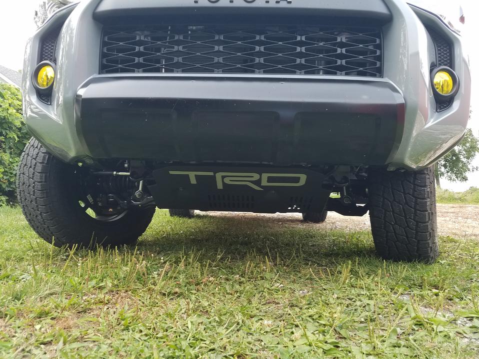

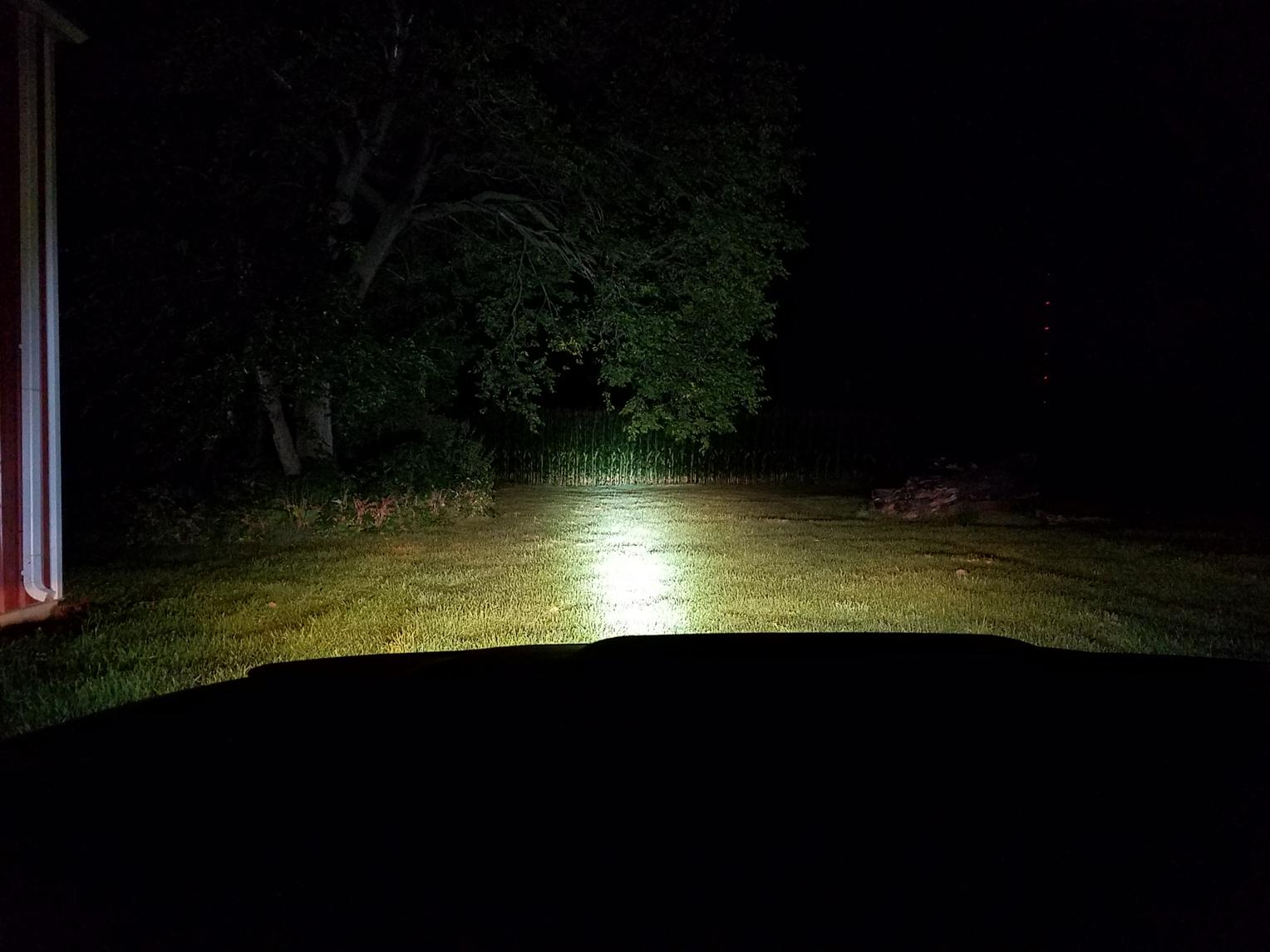

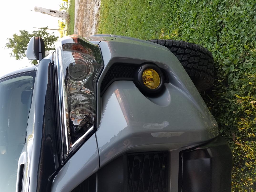

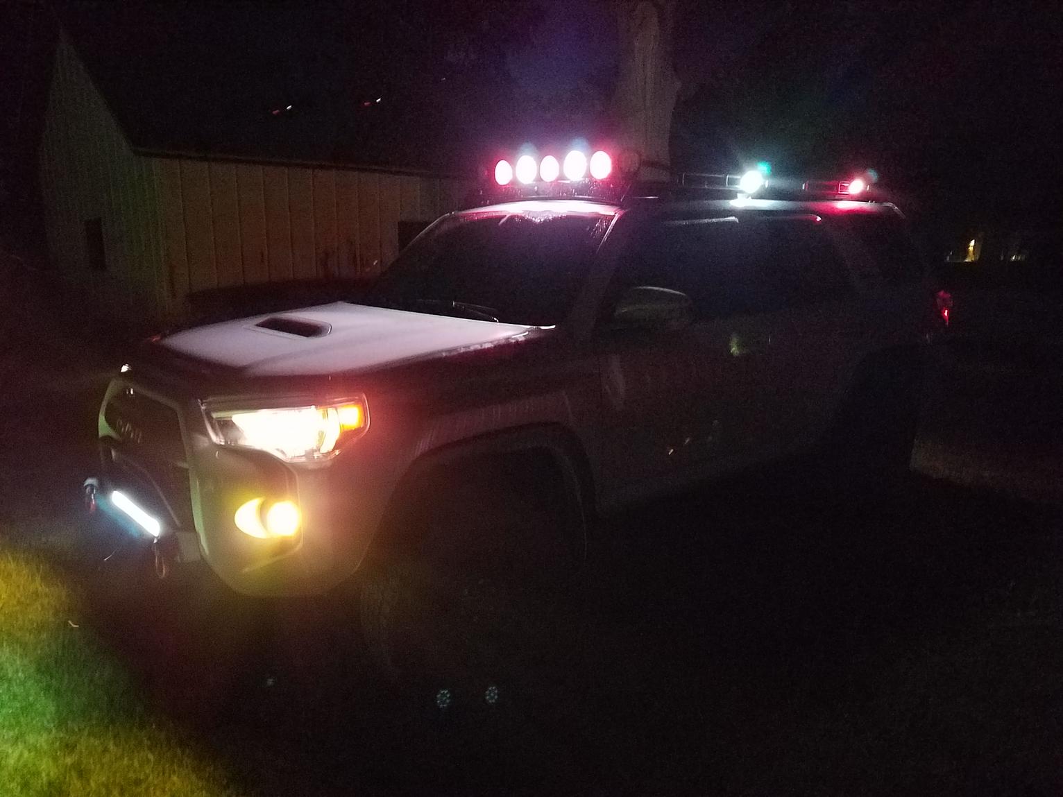

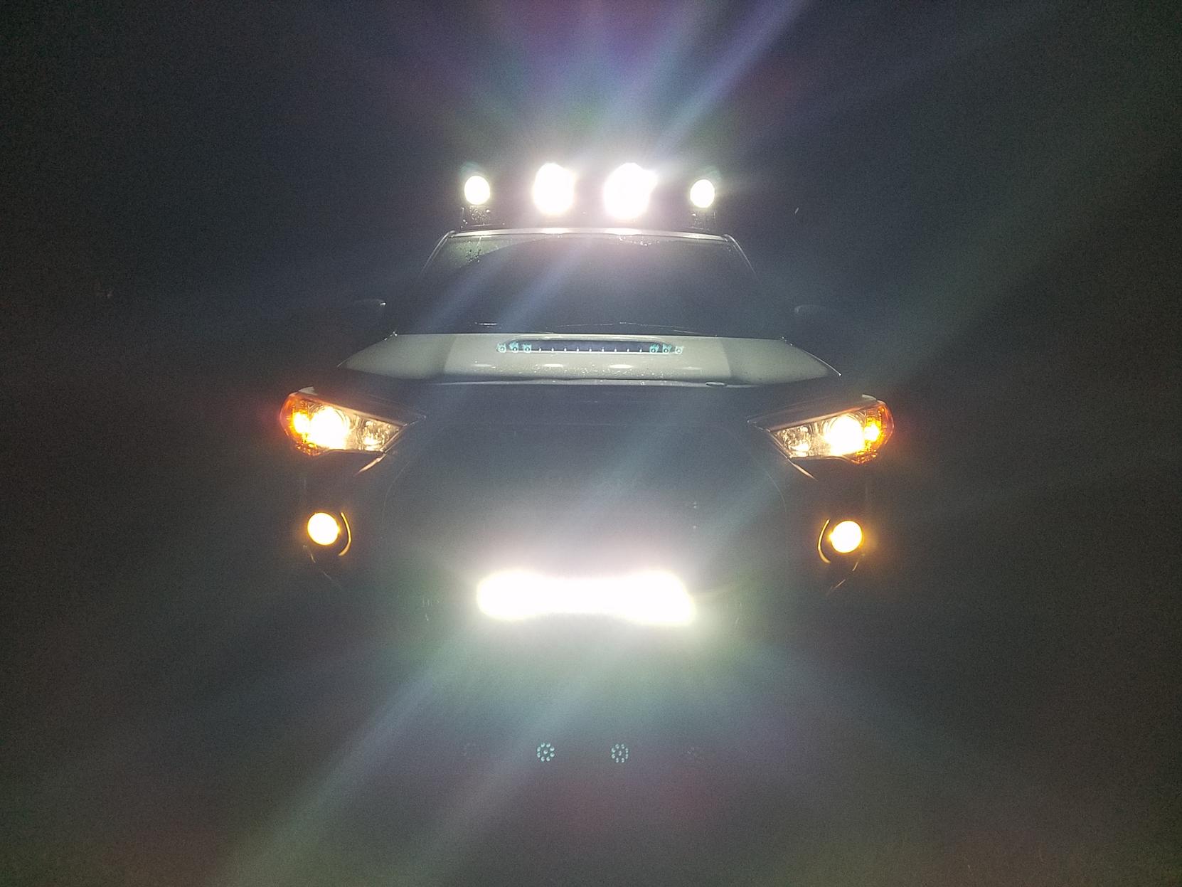

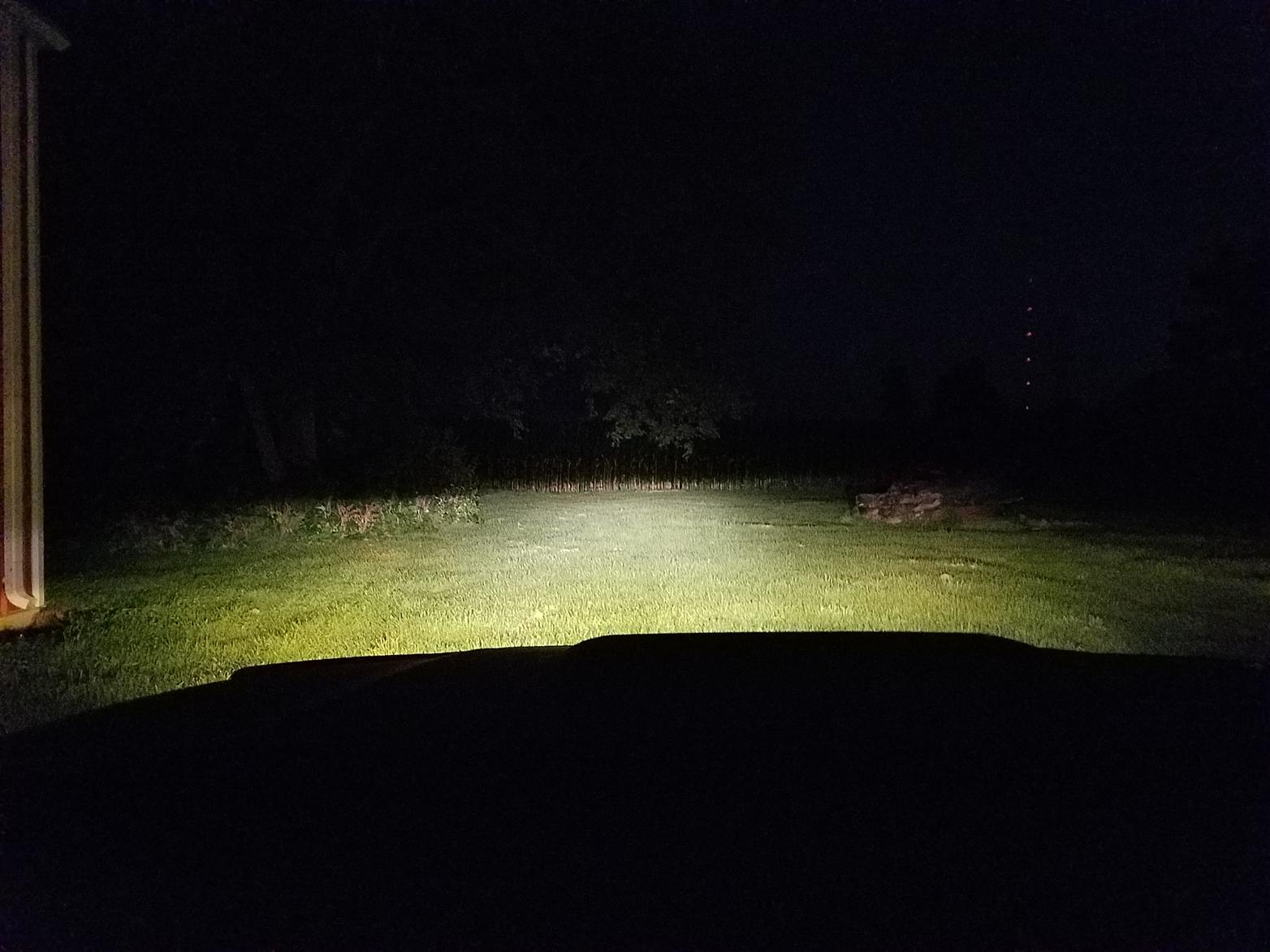

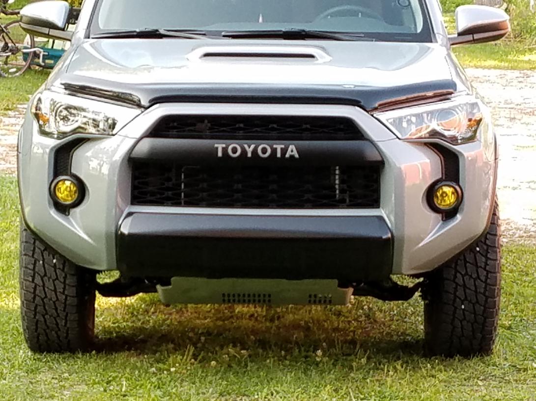

The Lights
Headlights w/ Yellow (Laminex) Fogs
Headlights w/ Yellow Fogs + 20" Rigid... It is aimed a bit low, will need to make an adjustment later tonight when no one is on the road.
Headlights w/ Yellow Fogs + Front pair of top White Round LED's
Headlights w/ Yellow Fogs + Ditch Lights (Aimed a little high to be effective, will make adjustments while road is clear)
Headlights w/ Yellow Fogs + 20" Rigid light bar in bumper + Front forward 4" white pair + 4" Ditch Lights
ARMAGEDDON!!!
