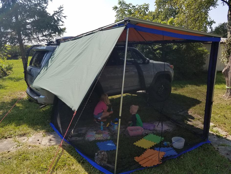

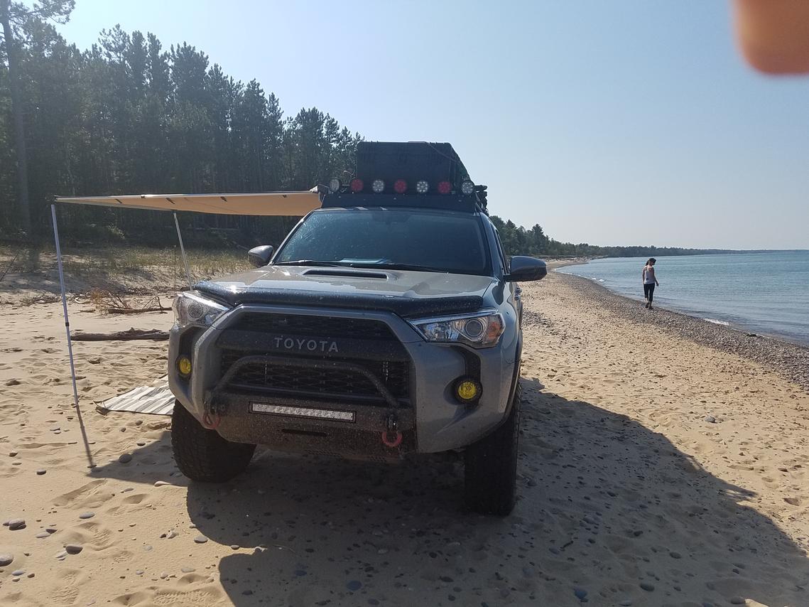

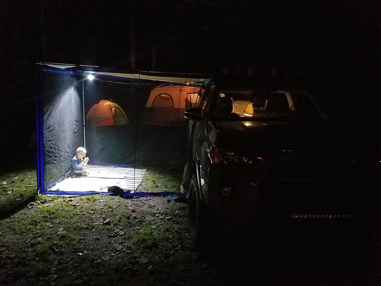

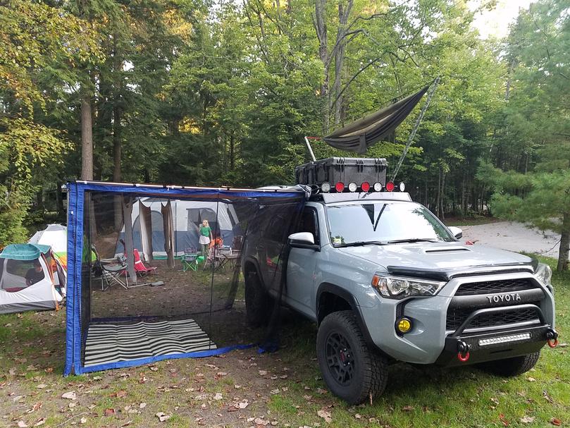

Busted out the sewing machine today and cut down an "off season" half price yard awning screen net to fit the ARB 2000. Then decided to grab a bolt of fabric to create a side shield for those times it seems like the sun and the awning are simply lined up at the exact angle to accomplish exactly nothing.
I forgot by now how much the ARB screens and the side panels were but I was not paying that price so I am in for <$25 including the grommets I added to the bottom corners of each.

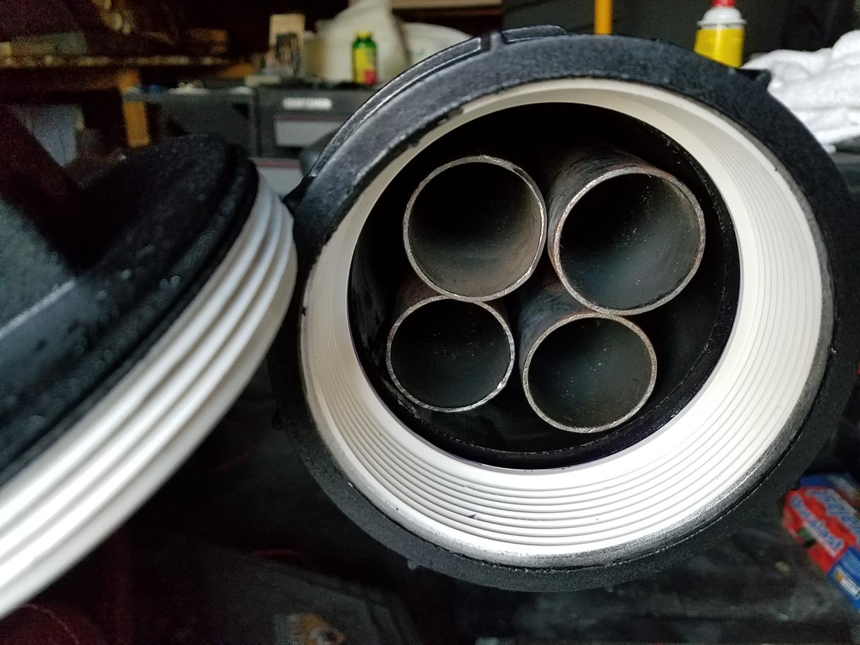

Knowing I did not want 4 torpedoes in the cabin of my truck with (or without) the kids I needed to find a means of storing the hammock poles on the roof.
Wednesday evening I stopped by Lowes and picked up a 5' section of 4" I.D. tactical black schedule 40 PVC piping an end cap and a screw top end cap for the other end. Cemented the parts together and camouflaged the ends with remnant bed liner spray and used some bungee straps to secure the full tube to one side of the rack.
You'll just have to keep an eye out for in in future pictures, It's pretty low profile (because of the tactical piping! ha)

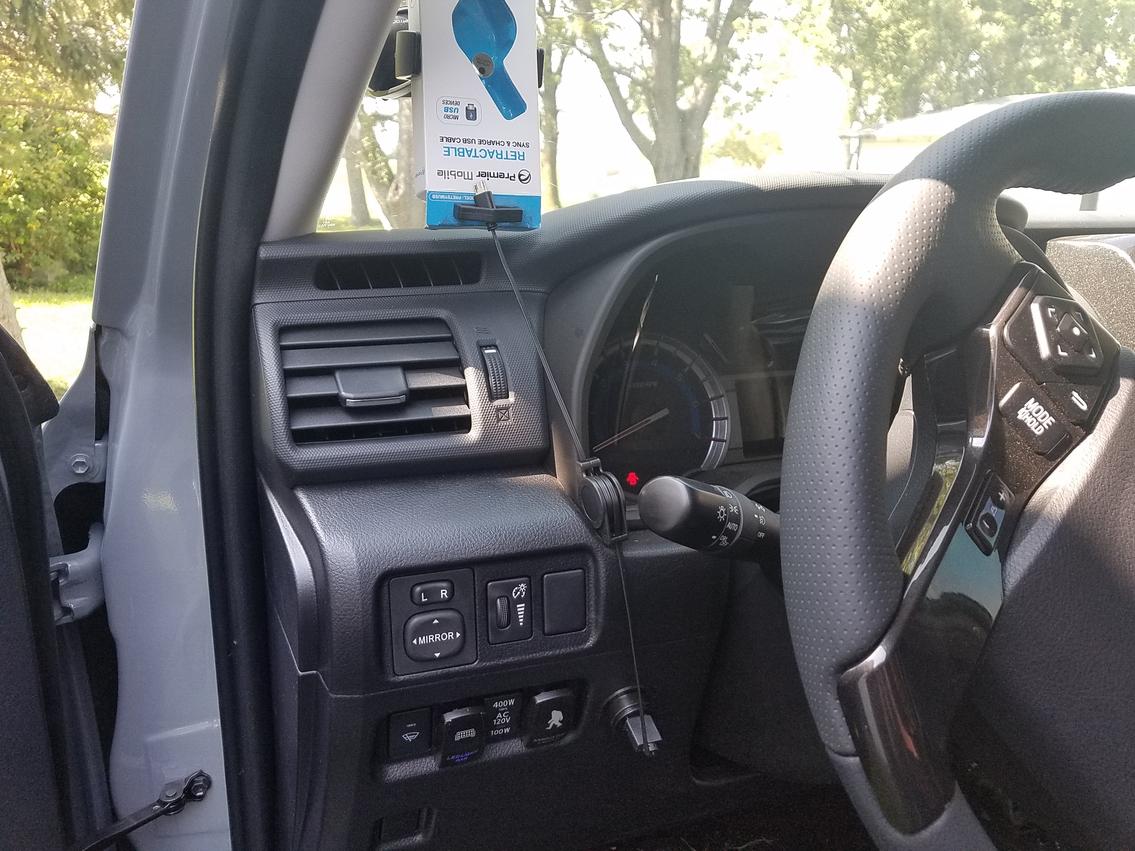

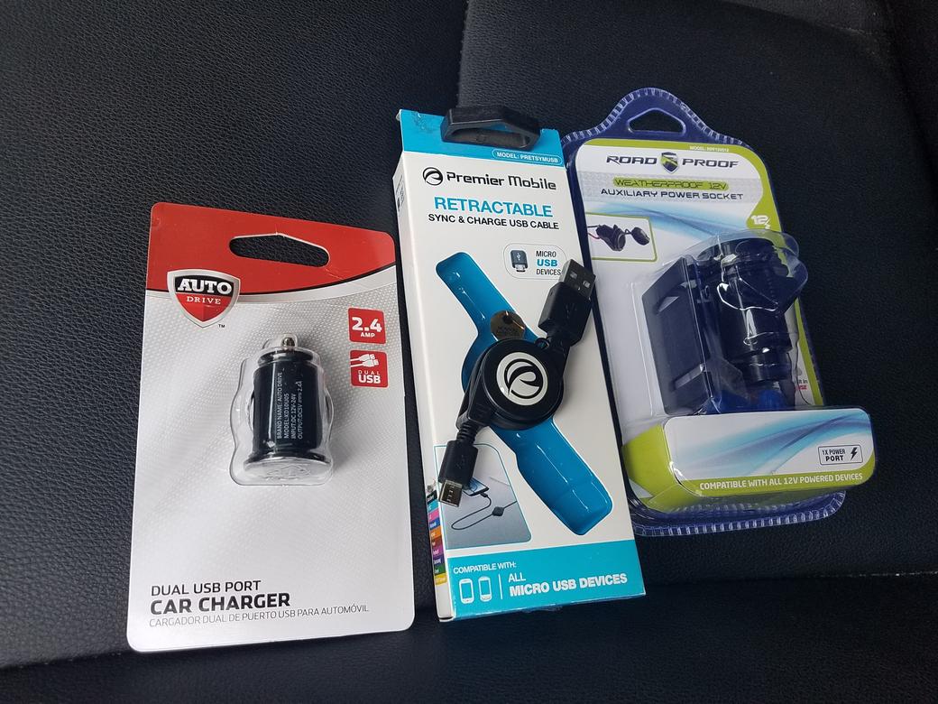

Next up was solving the ridiculous fact that there is no all time power outlet... What the ____ were they thinking???
Oh well, ~$20 in parts and another hole in the panel and now I have a dual port full time USB and retractable charge cord to keep the A Post nice and tidy.
I really tried but could not figure out how to take a picture of my phone in the mount...with my phone...so my model is a box...pun might be intended.
For those inquisitive types out there who may ask, I tapped into the all time hot that feeds my 20" front bumper light bar. I don't know why, or how to, or care to fix it, but the supplied harness that came with the light bar is a constant on deal?
Anyway, as you inquisitive types out there who will also zoom in and ask... yes, that is an extra switch placed for future use for god knows what and since it currently does nothing, hence not existing, it gets the squatch cover ;-)

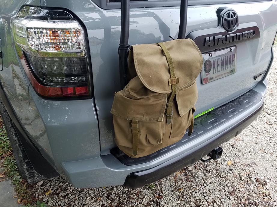

Final trip prep was putting some new reflective tape on the "tailgate". I REALLY wanted to keep the pair of cases on that but it would not allow the lift gate to open, but the cooler on the end allowed perfect clearance.

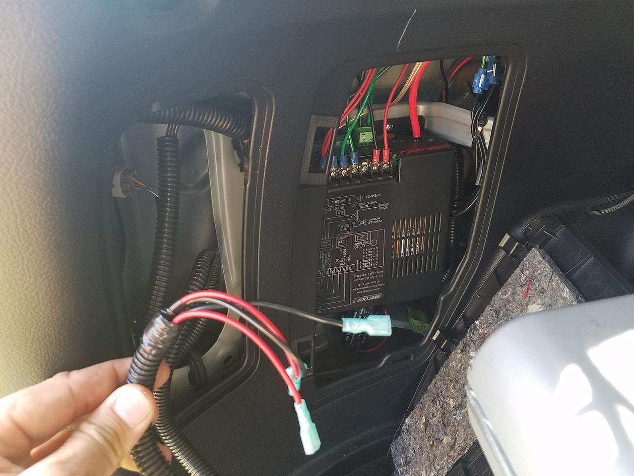

How did you run the wires from the roof rack to the car?

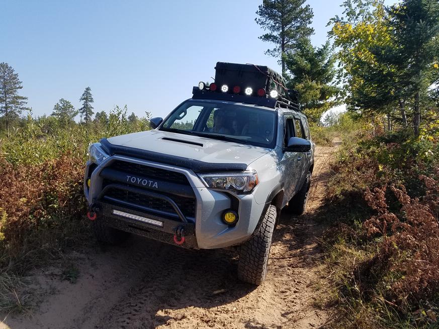

One more MacGyver-esq mod before we left...

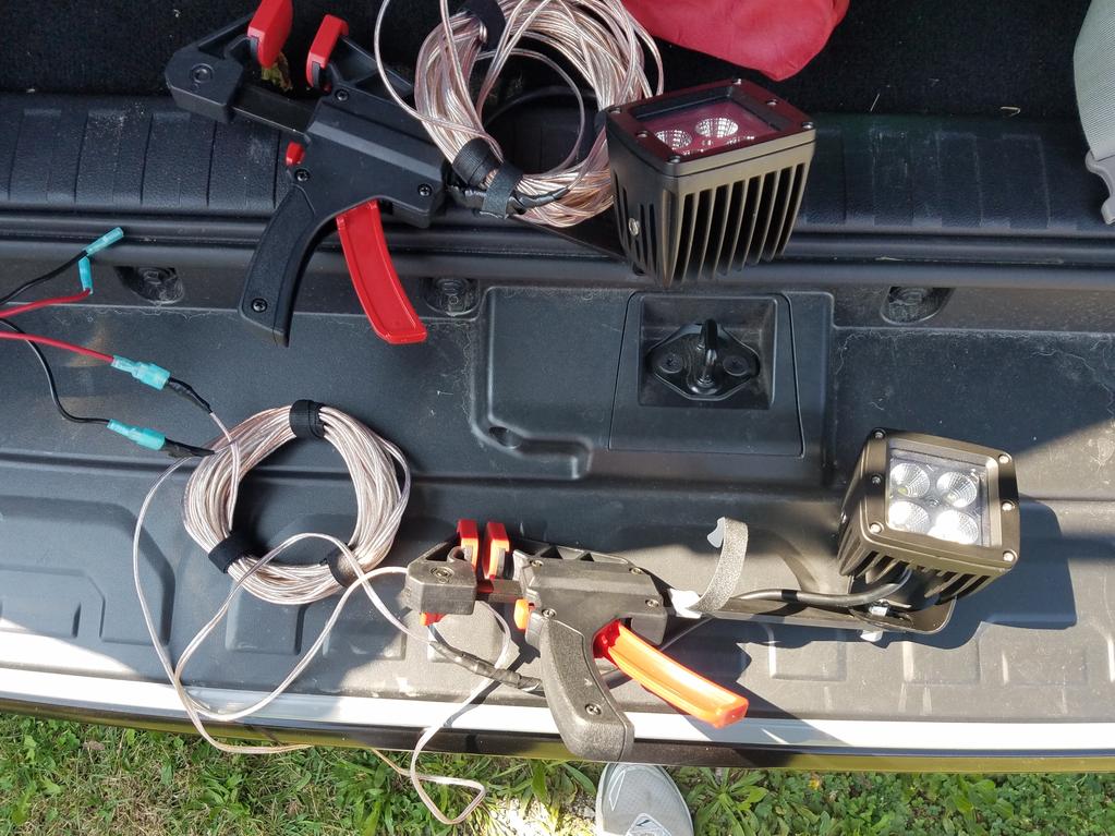

Given that I received cube lights from [MENTION=110183]SouthernSS[/MENTION] as a group buy perk on the front bumper, and could not decide where to put them, I decided to put the everywhere! When I put the Code 3 Covert in I led a pair of paddle wires to the tail light access panel. These were tied into the Aux 4 button on the controller.
I stopped in to the local box store and grabbed some vice clamps and a spool of speaker wire, mounted the cubes on each and cut the wire into the leads. Now I have LED lights that can be clamped all around camp.
I will admit though, I must be running auxiliary power and the box to power these so I am using far more juice throughout the truck when all I want is this/these lights, but at least I wont forget to turn them off hehe
Final product... pretty stoked!
I traced them down the rain channel along the rear under the lift gate then down through the port of the tail light so everything is behind the panels.

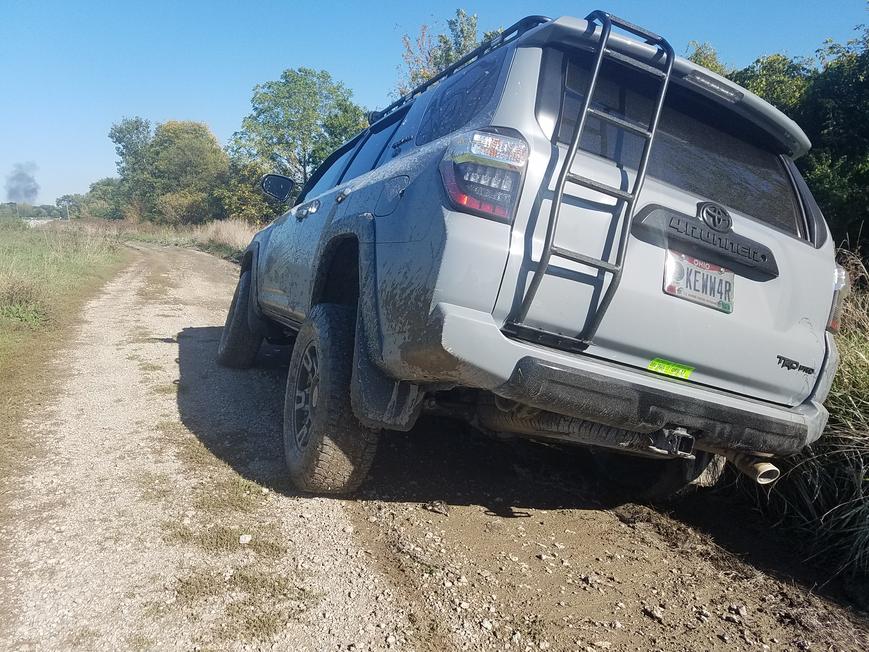

Mud!
https://youtu.be/uQFjDEZVx6A

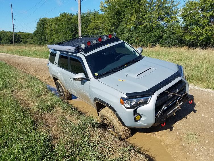

Found a little gem of a trail near my house. I remember scoping out the headwaters of the creek years ago almost getting stuck then it clicked for me!!! That's my trail! haha I did not stop for the best pictures and the video doesn't capture all of the splashes etc. but for what it's worth that is the first time I ever recorded a trail ride... next time I will let some Pantera jam out during the ride to add an audio element.
Either way, she's painted in Black Swamp Mud and I just might leave it that way for the Bridge Day Trip coming up next week.
