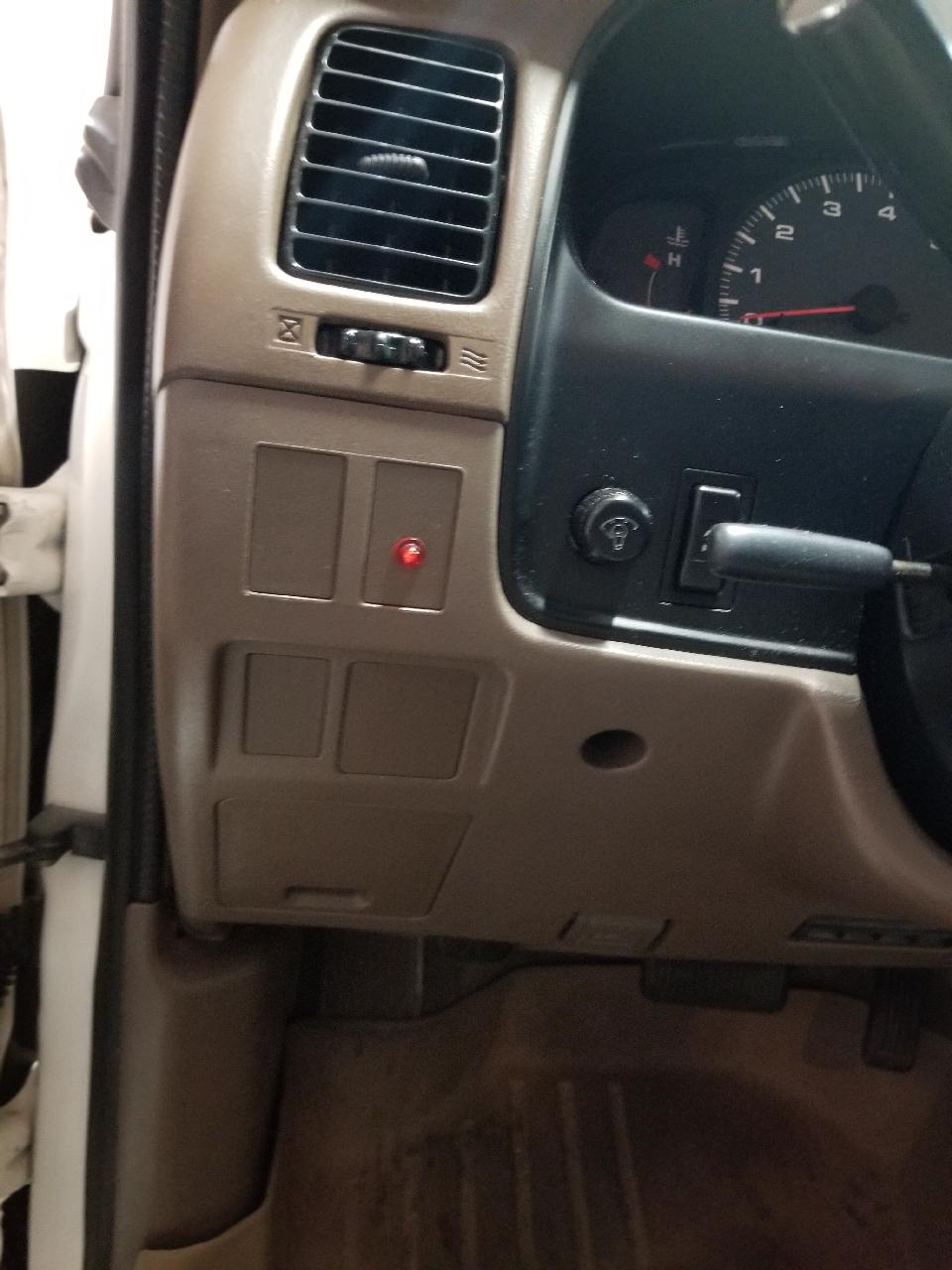

I'm having fits trying to add another remote to my RS3200 in my '01.
Do you have a single red light in a pop out switch on the left side of your steering wheel?
Eddie
I'm in the same boat with an RS3200 dealer installed alarm - can't add another remote. Im going to try the steps in post 8 and see where it gets me.
