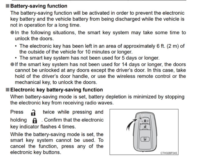

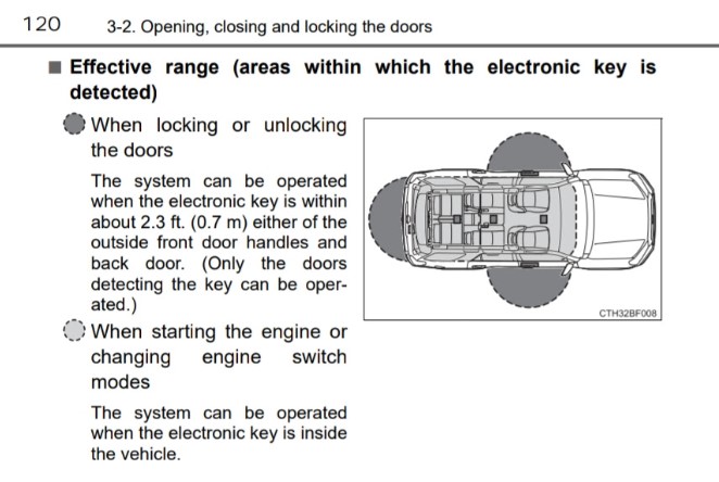

GREAT call out!
Here are the excerpts from the 2021+ Smart Key 4R
Seems like using the battery-saving function + stashing the key in teh front bumper would be a slam dunk and basically free.

Thanks for the info, I already turn off the fob every chance I get. It works the same on the 4runner. The reason I started this thread was I wanted to put a hidden key somewhere on the frame under the body. I was looking for a simple key that would only unlock the door and allow the car to be started by tapping the start button. It looks like the simplest solution is to just get a full function key fob and either keep it turned off or remove the battery.
